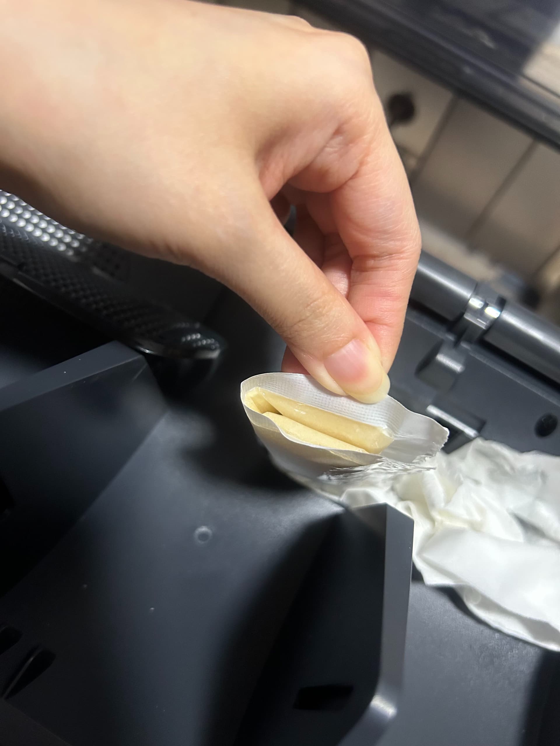

So I was getting underextrusion all of a sudden after I moved my AMS from on top of my P1S to beside, and I couldn’t figure out why (checked extruder/replaced hotend, PTFEs, etcetcetcetc) and so I decided to take apart my AMS and when I lifted in the inner body out there was literal liquid dripping out onto my desk.
Apparently the silica had melted or something??
So my question is, is the first stage feeders supposed to be drenched in grease originally, or is it covered in molten silica and causing slipping and I’m totally fked? Btw I’ve only had my P1S/AMS for less than 2 months…

I heard the liquid from a used-up desiccant of this type (apparently calcium chloride) is corrosive, very bad for parts or circuit boards. But I can’t see how it would end up in your gears - the desiccant tray drains to the bottom plate. You should open up your AMS and clean that out though. And I figure that draining is poor design… would be better having it contained in that tray.
It did end up at the bottom of the tray, but the components were dry.
The problem was, I was only checking for a broken filament without realizing the silica was molten, so I lifted/tilted the inner body of the AMS to unhook the back PTFE/pins… so yeah, it basically dripped everywhere through the top grate cover… -.- Both silica packs were melted. The amount captured in the photo is after I realized there was liquid coming out of my AMS and I opened up the desiccant cover to look… :frowning:
I would try and rinse the mechanical stuff (obviously not the motors) thoroughly with plain water and then dry with compressed air. Then maybe re-lubricate with something sensible.

Don’t talk about silica, it is not silica. It’s calcium chloride, an alternative desiccant, actually salt where the sodium was replaced by calcium. It works completely different, as you found out, it liquefies. Probably not what you want in your AMS, I guess it was chosen as the trays are too small for silica gel to work sufficiently (calcium chloride is more efficient).
If you want to replace it by silica make sure to add additional containers. Best desiccant would be molecular sieve, it can dry down to almost 0% but it’s more expensive and hard to regenerate at home (temp around 300°C).
IMHO, it seems that the calcium chloride should go into containers that won’t leak all over everything. That way if you get distracted and your vigilance goes down, you won’t be faced with cleaning up a mess inside your AMS latter on.

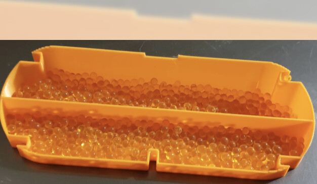

Silica gel won’t leak, especially not if supply in leak proof and RE-USABLE bags.
What Bambu uses is the same stuff you find in those contraptions to dry your room - the stuff is highly hygroscopic…
Once full it keeps collecting moisture to the point of turning into slime, getting thinner but not less sticky and not less CORROSIVE.
I removed all the Sh!t provided and replaced it with silica gel.
Simple kitchen paper bags, closed with wood glue…
One between every motor and then some between the spools where it fits…
Once the AMS indicates a humidity level above 3 I replace the lot with fresh ones, rip the old ones open and put the beads into the recycling jar.
When the jar get full I use the oven to dry them and am ready for the next round…
