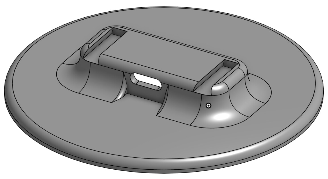

I recently purchased an X2D and it’s been awesome so far. My issue is with a somewhat complicated part I designed printing poorly in a specific area. I’m new to BambuStudio so I’m hoping someone here can shed light on slicer settings or whatnot that would fix the issue.

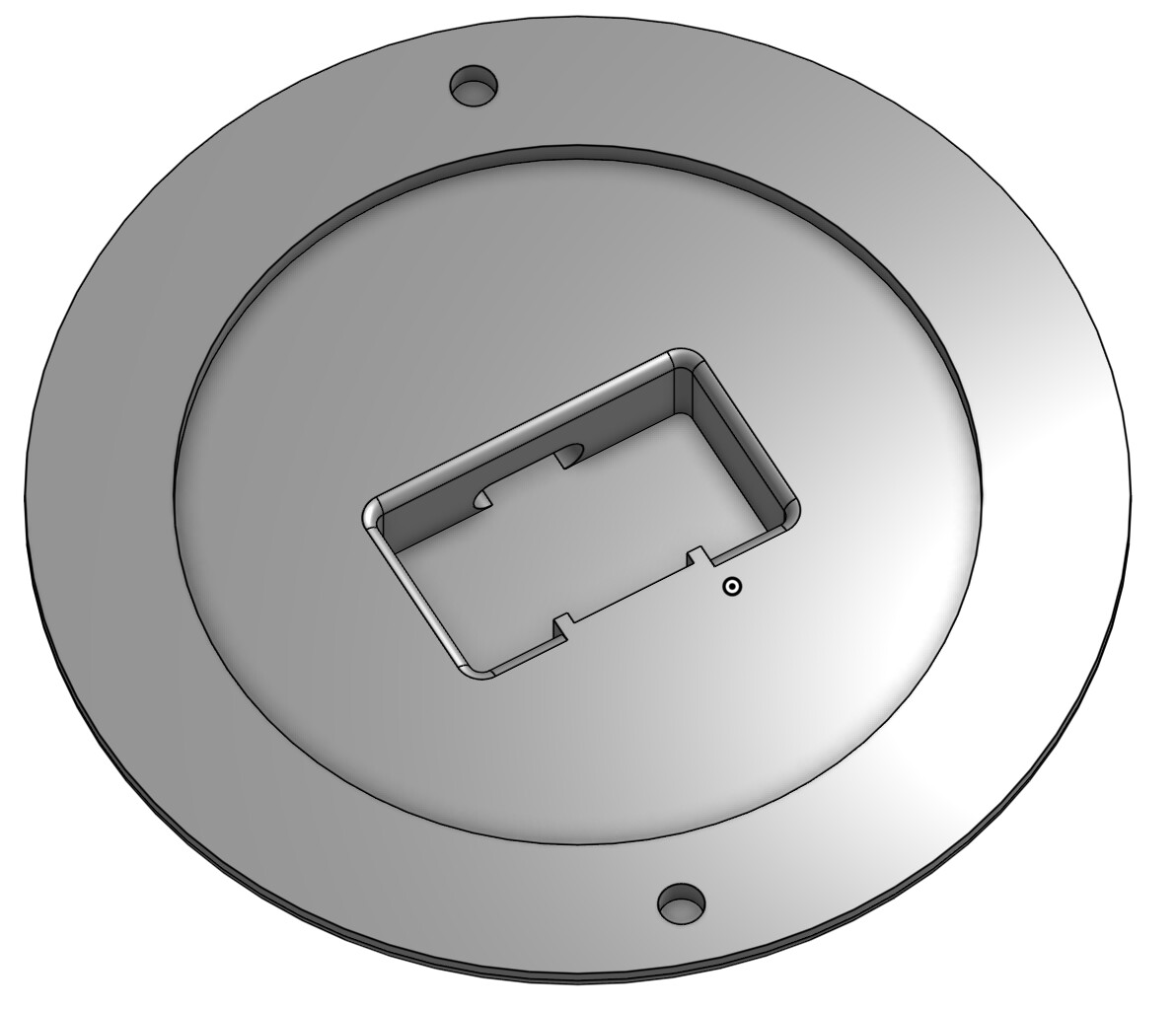

Here’s a couple pics of the part from Onshape. I aligned it face down on the print bed due to the complicated features on the backside.
Back:
Front (face):

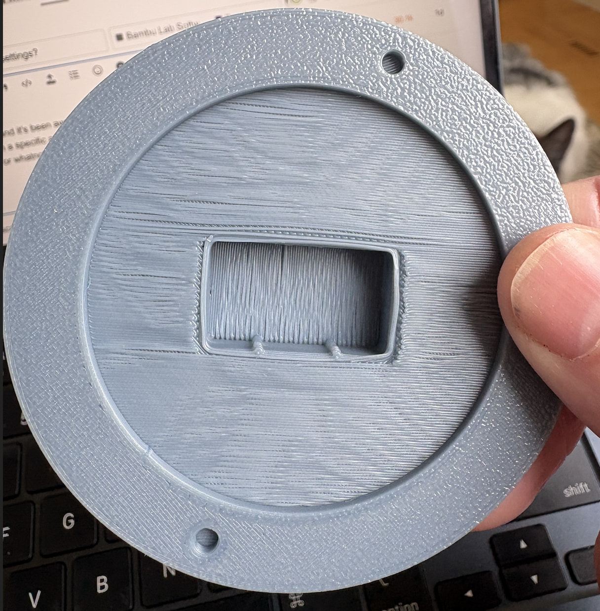

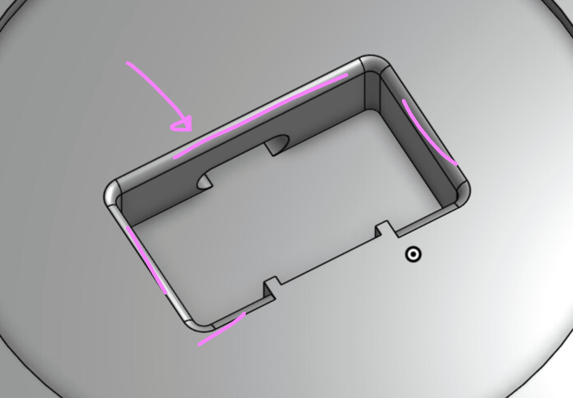

Here’s the print. You can see the issue has to do with the walls of the interior pocket printing poorly. I’ve tried both normal and tree supports with similar results. The dimensions of this are are critical as it is designed to provide an interference fit for a circuit board.

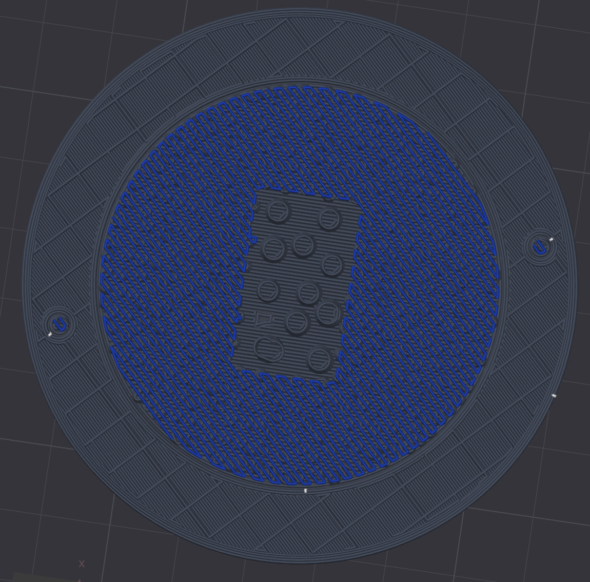

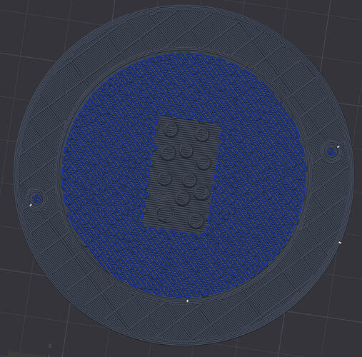

Here’s a screenshot of the layers for this particular area of the print. I’m using CoPE filament as a support interface as it doesn’t stick to PLA making support structures easier to remove. The large area of blue (CoPE) doesn’t extend very far up the print as that pocket is maybe 1-2mm deep, then it’s all PLA.

  1. I would soften that fillet. Thats oriented gravity-down so you’re creating the kind of overhang angle that FDM has trouble doing, at the critical dimension edge
  2. Change “Support Interface Spacing” from 0.5 → 0.0. This will make that blue zigzag support interface a solid plane instead of having gaps.
  3. You didnt mention it, but if your support filament is using something other than 0.00 top gap, make it be 0. You -do- want it resting on it. No floating and imprecision allowed. I havent used COPE so i’m assuming it will break away or dissolve.
  4. Given the interior geometry, i would add +1mm to “Normal Support Expansion” which will make the support interface generate a little more into the center cavity, giving you the best chance that fillet is printing on top of something to stick it down. Im not sure if this is effectual or just vibes, but /shrug

Just wondering about your support settings. I frequently use PETG as a support surface for PLA (and vice versa) to good effect. However, with those, the slicer will offer the option to auto-adjust z-distance to 0mm and adapt the interface pattern. Is that also the case with your CoPE?
If not, I’d suggest giving PETG a go as a support interface or staying with CoPE but making sure that the top z-distance is indeed 0mm.
Re fillet: I mean maybe removing it and replacing with a chamfer of equal size, to obtain a printable angle, or reducing its size so that only 1 layer will have an angle that is bad
  1. replace the fillet with a chamfer
  2. does it matter if the pocket is a millimeter or so too big for the PCB? You will surely have some kind of retaining screw or clip in there as well?

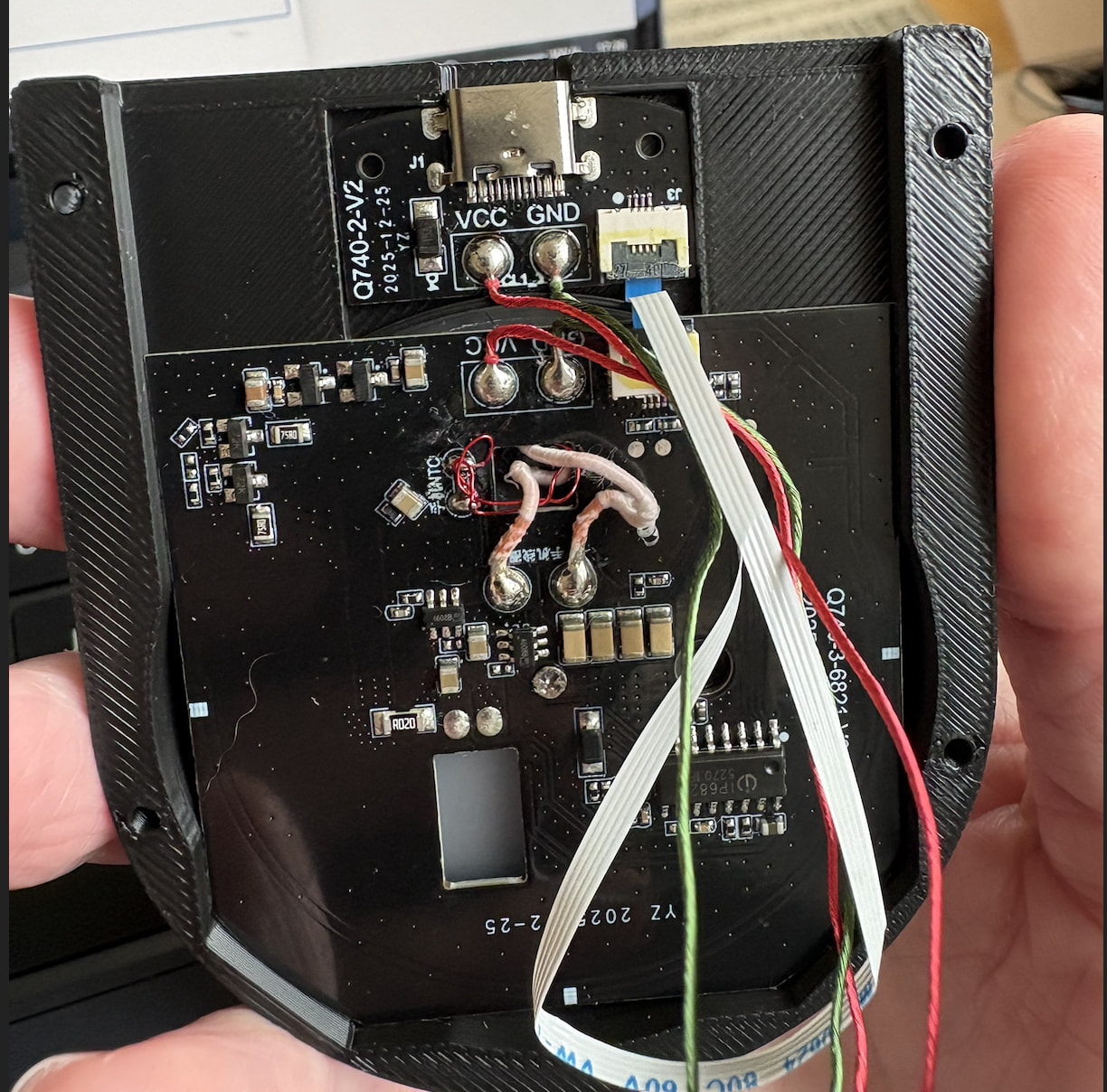

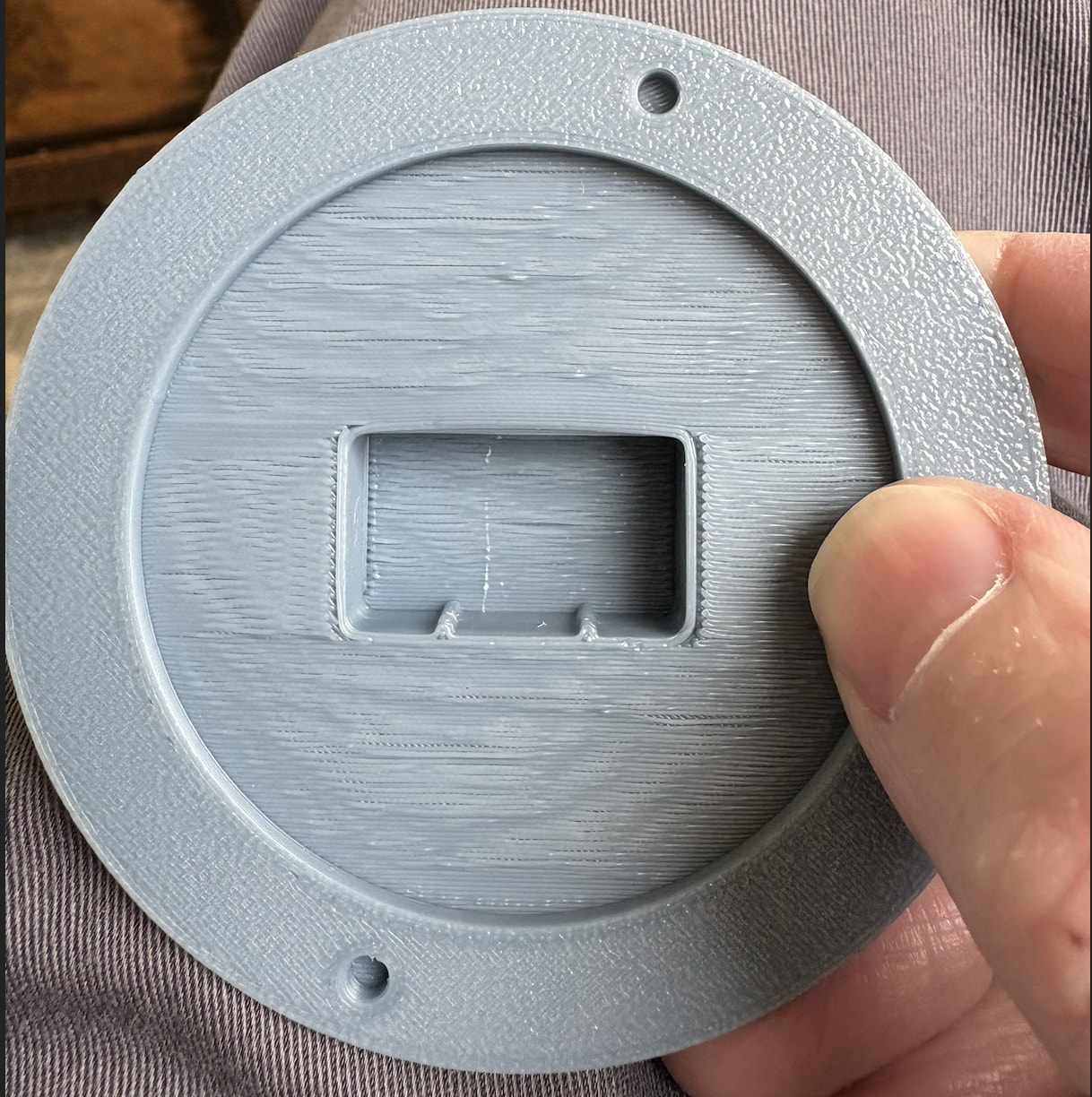

@Bullocks Your tips worked! I tweaked the support offsets and removed the fillet. The PCB mostly fits now, but I think the “mostly” is an issue in my design.
Thanks!
I very well may need to come up with a different solution to retain the PCB. My previous iteration had it held in place with tension, but I can’t just drop the board into the pocket for this new design. I need a little extra space for the USB-C port.
Connector ports seem easy until the user pulls on them
