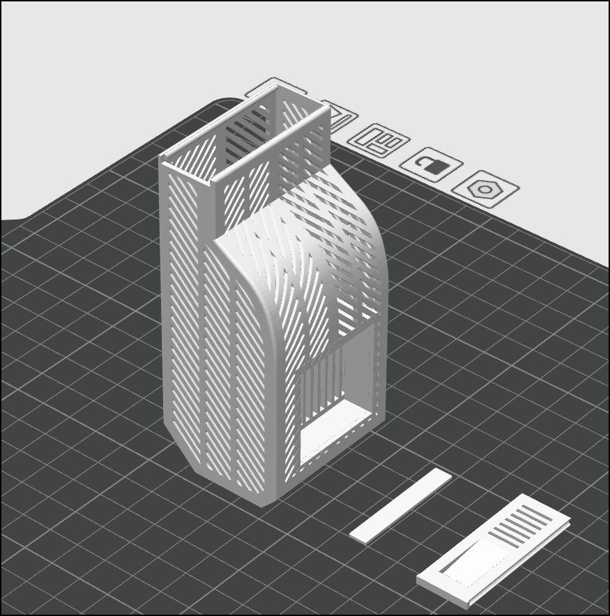

I took those models that you can fill with desiccant and fit between the AMS Primary Feeder and modified them to accept a 30mm x 30mm x 10mm 12V fan in and you want to talk about a significant change.
Quite the eye opener.
I’m in the process of modifying the models for my AMS 2 Pro which should be interesting since it has inbuilt drying capability.
