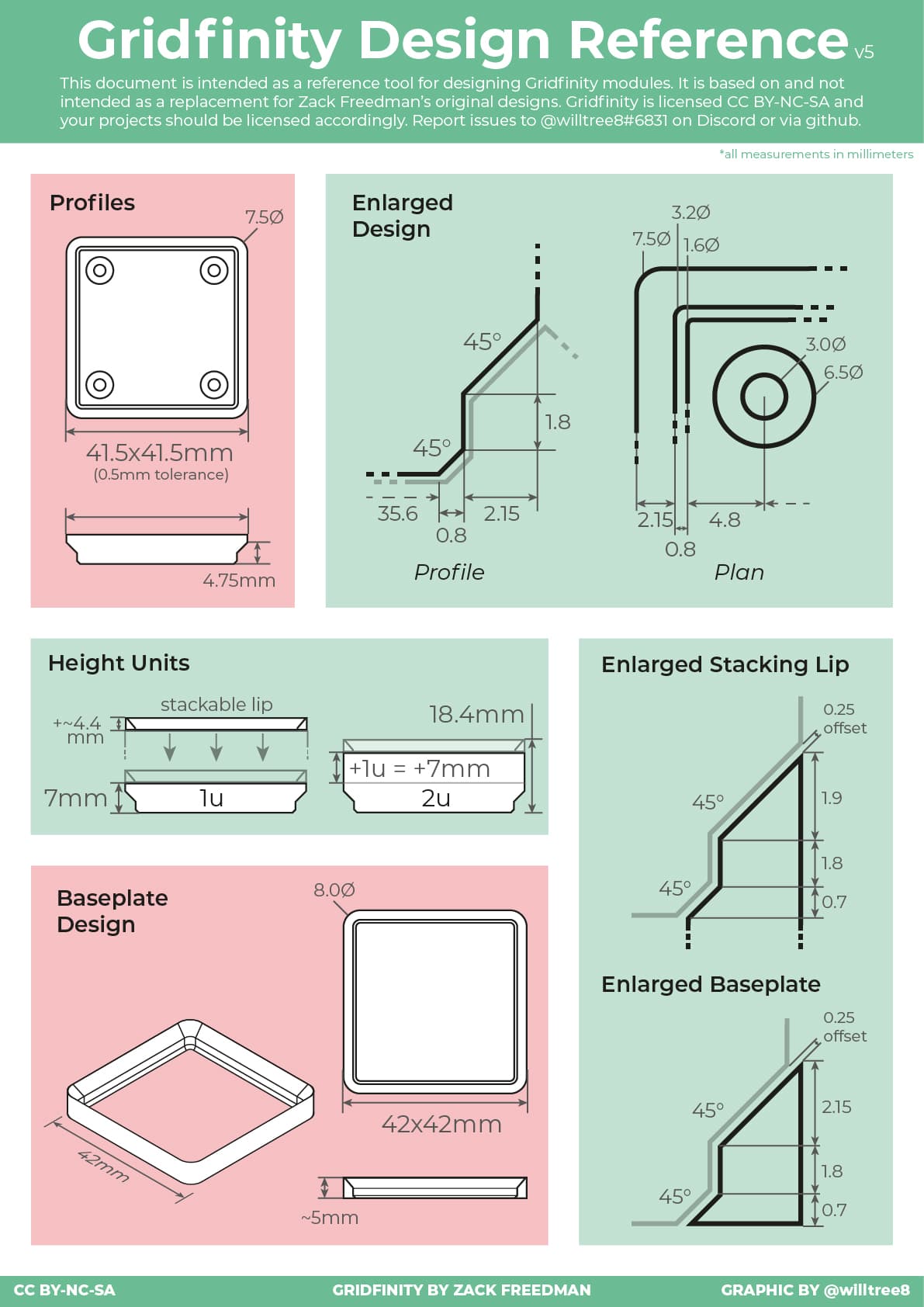

There isn’t much to understand about Gridfinity, if you can envision a 41.5x41.5mm grid of boxes with 7.5mm radius on the corners and a 2.15mm inter matrix frame with a 4.44mm lip, you’re 90% there.

Here’s my advise, go to Zack Freedman’s website and look at the spec page. He’s the inventor of Gridfinity and has many other useful links.

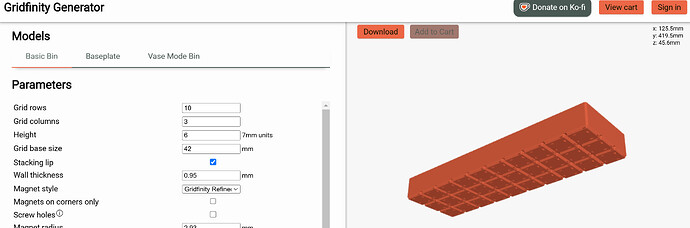

If you don’t want to master it through CAD, there’s good news, there are many sites that will do 99% of what you want. Here’s one of them, its all menu driven and you can go hog-wild on the grid. Once you define the size of your grid and boxes, it will generate an STL file. I must admit, it’s a pretty damned cool site and this coming from someone who prefers the DIY approach to CAD.

If you don’t want to wrestle with Fusion 360 sketch constraints just to make custom compartment widths for tokens/cards on a P1S/X1C, the key tolerances to lock in for Bambu printers are:
  • Standard 42 mm X/Y pitch with 0.25 mm per-side clearance (41.5 mm nominal bin footprint) so bins drop cleanly into baseplates at 0.20 mm layer height.
  • 7 mm height increments (Z units) with stacking lips enabled if you want multi-tier trays inside a board-game box.
  • 6x2 mm magnet recesses printed at 6.15–6.20 mm diameter for a clean press-fit in PLA/PETG.
(Full disclosure: I maintain this tool) If you want an instant browser parametric generator that outputs watertight manifold STL bins and baseplates straight for Bambu Studio without installing OpenSCAD, searching GridfinityCAD brings up our browser generator with live preview.
