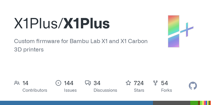

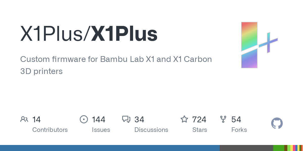

Isn’t this what X1Plus is?
Having the X1Plus integrated directly into the printer’s hardware would be ideal, rather than relying on a clip-on solution tied to the original firmware. While I’m interested in some features of the X1Plus, I’ve already submitted a support ticket requesting more graphical enhancements, particularly for calibration and other features. I believe it’s possible for them to protect the elements they’re concerned about while still allowing customized firmware. Time will tell!
Is there a P/A series equivalent? As that would be needed also.
There is not, it’s entirely different hardware.
Don’t worry. You are not the issue here but you should really stop feeding him.
No, not really. X1Plus is more of an interface enhancement than a complete firmware. X1Plus still depends on the “base”, closed source firmware from Bambu for all major functions, like motor and temperature control. When you install or update X1Plus, that base is downloaded from the Bambu servers, and written to the SDcard. The printer boots from the internal (v1.6, or “R”) firmware which transfers control to base firmware on the SDcard. If that firmware is looking for authorization from Connect, I expect it will still do so with X1Plus.
I am still glad to have the extra conveniences and printer access of X1Plus, and if I can never again update the Bambu part of the firmware (v1.08.00.00) I will still be content. I am happy running in LAN mode most of the time anyway. I’ve chosen to keep the internal firmware (v1.06) from even checking for updates, and I have backup SDcards with X1Plus installed with V1.08.00.00 in case a card fails.
I’m not confident that Bambu will continue to allow “downgrading” to the rootable internal firmware, or the download to SDcard of newer firmware. If there is a new version of X1Plus employing the 1.08.03 firmware, I will be sure to try it. If I don’t like it, I can just pop in the old card without authorization requirements.

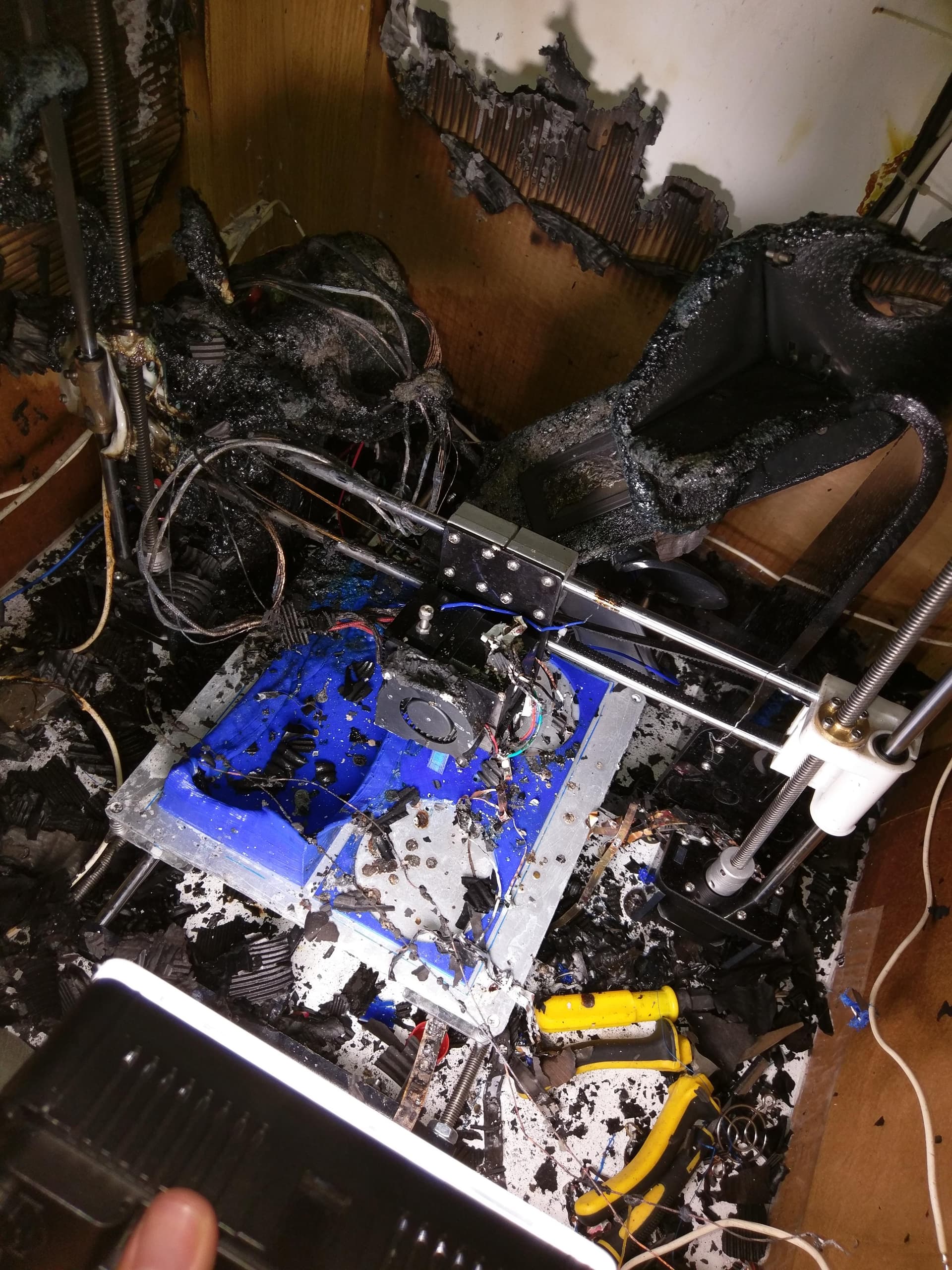

Well, unless it burns down your house.
But then, didn’t we all learn to never leave a 3D printer running without sitting next to it, for this very reason?
This is why I also never got the whole “cloud” stuff. If I have to sit next to the printer for safety reasons anyway, then why would I want to view the camera feed over anything else but the LAN?
“Anet A8 entered the chat”
