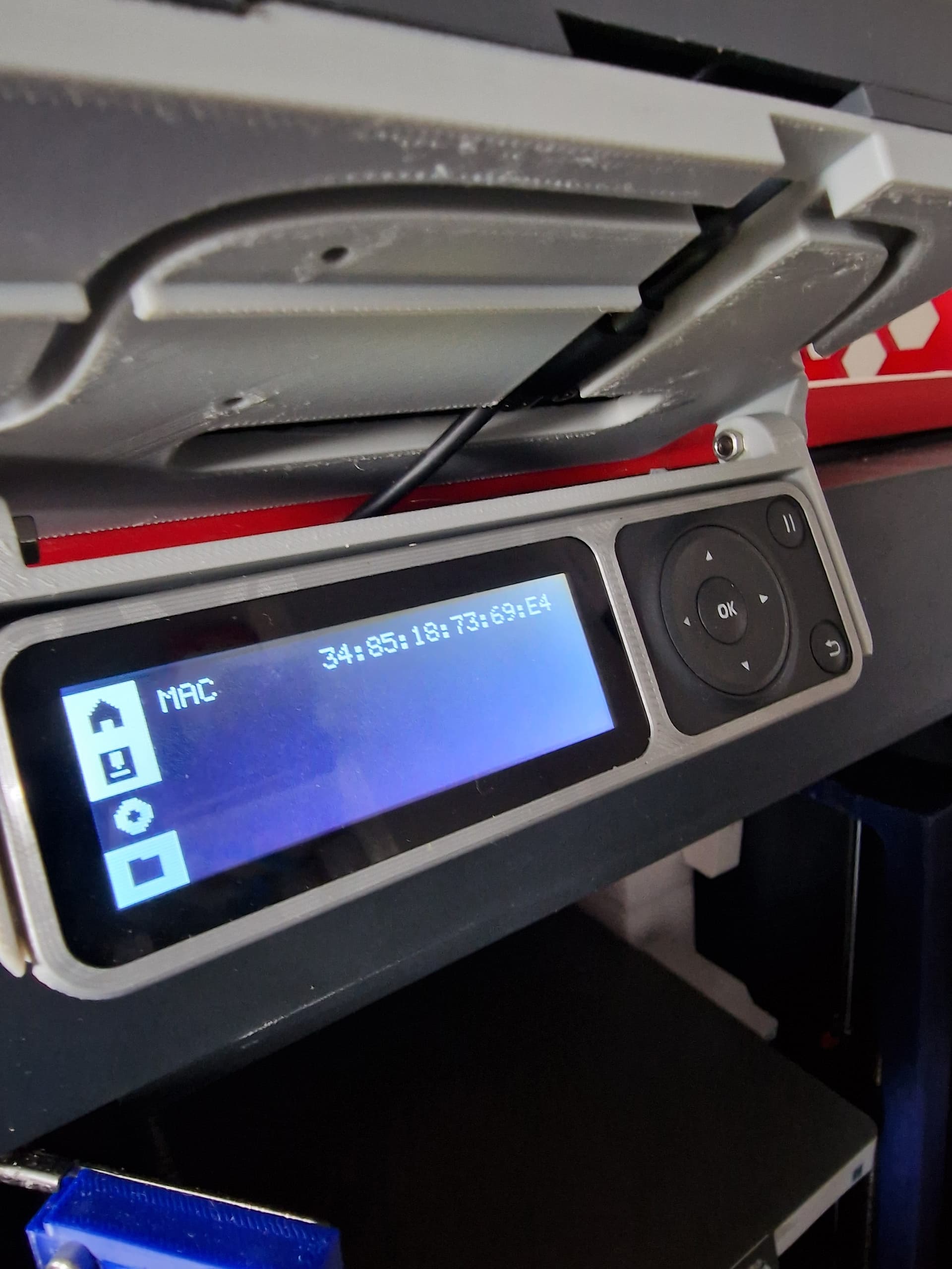

Thats strange because it was the upgrade to 1.07 thst stopped my Panda from connecting (apparently).
It asks for an access code but doesnt accept anything. Strange…
So did I and it always has in the past.
This machine has been out of connission for 3-3 months simply because the AMS developed a fault and I used my X1 solely, for a few months.
Then yesterday I needed to print something while the X1 was busy, and it was only one filament, so I thought I’d fire up the P1. Imagine my puzzlement when I couldnt get PandaTouch to connect.
All sorts of troubleshooting later I found several prople saying firmware with Access Control wouldnt work with Panda and that the latest version that did NOT have access control was 1.05 (not as someone said here, 1.08).
I thought to mysrlf, it cant be access control, I always reject firmware updates for exactly thst reason.
And when I looked - there it was! First time powered up in many weeks …
So I contacted Support who ssid the latest available downgrade is 1.06 and it has access control (again, not what the responder above says). Support said I would need to use Developer mode. But its not there.
