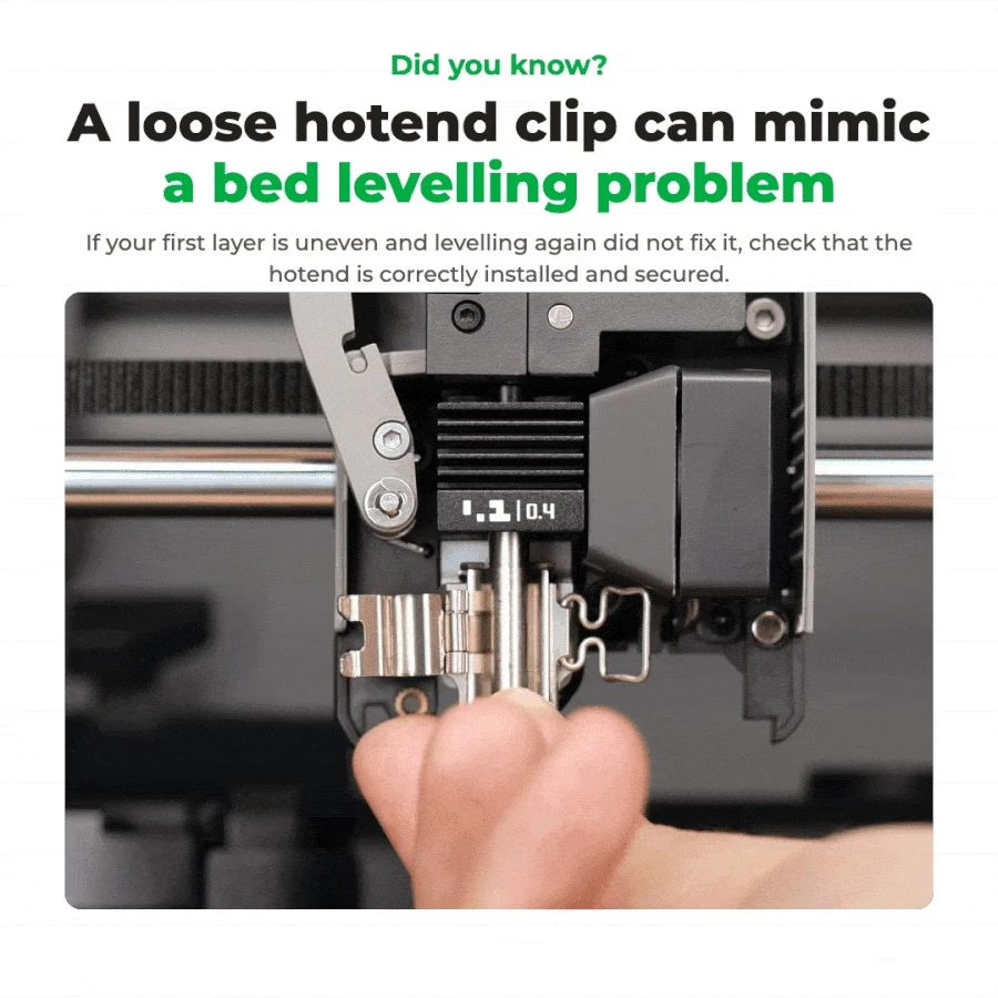

Did you know? A loose hotend clip can mimic a bed levelling problem
