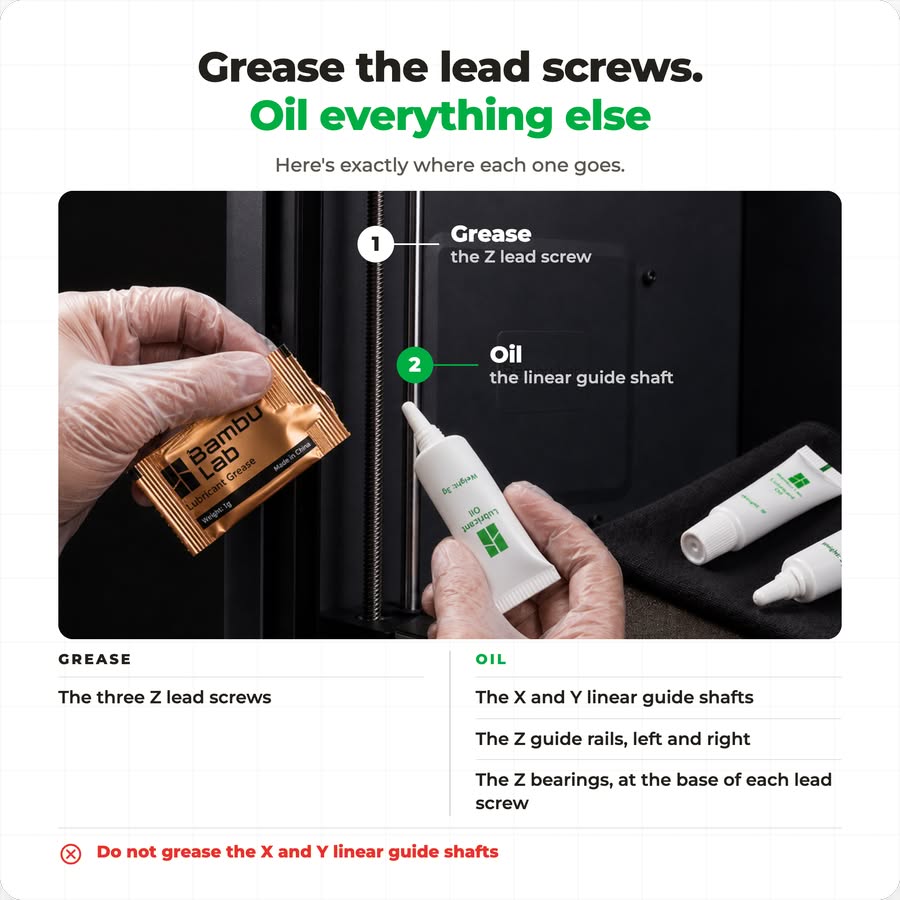

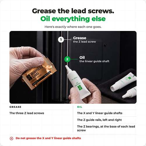

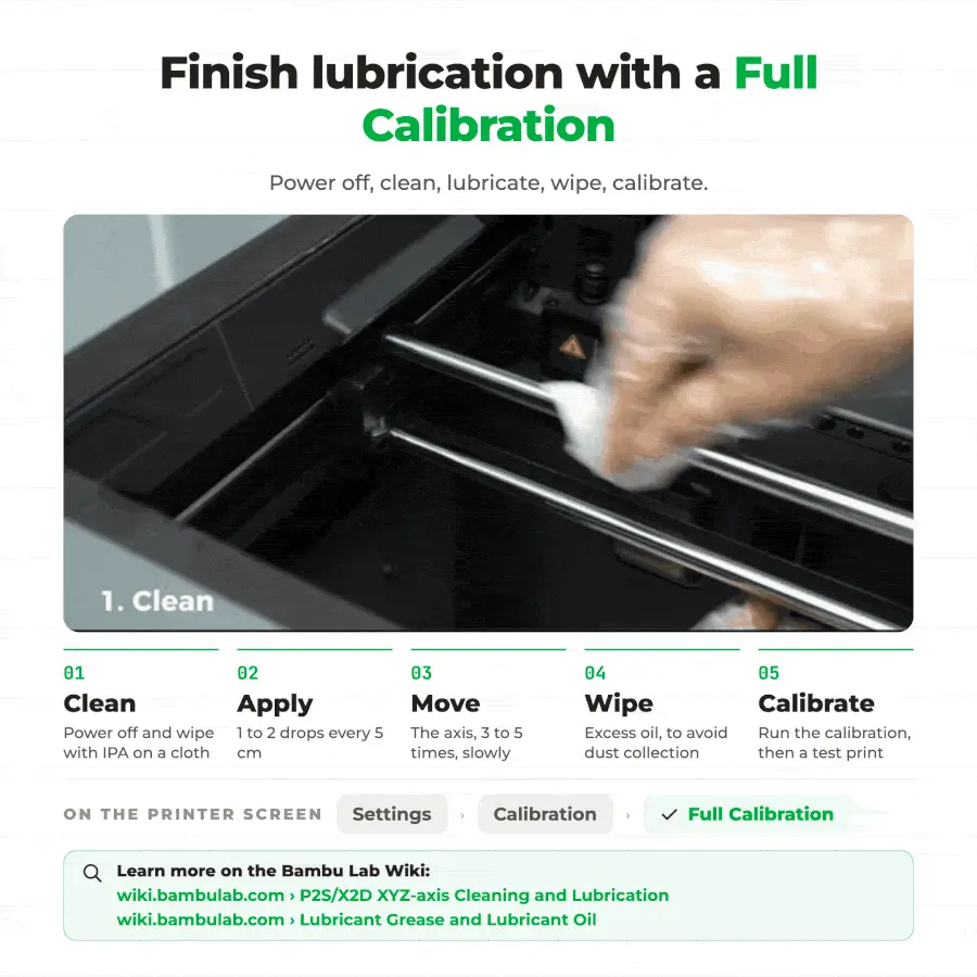

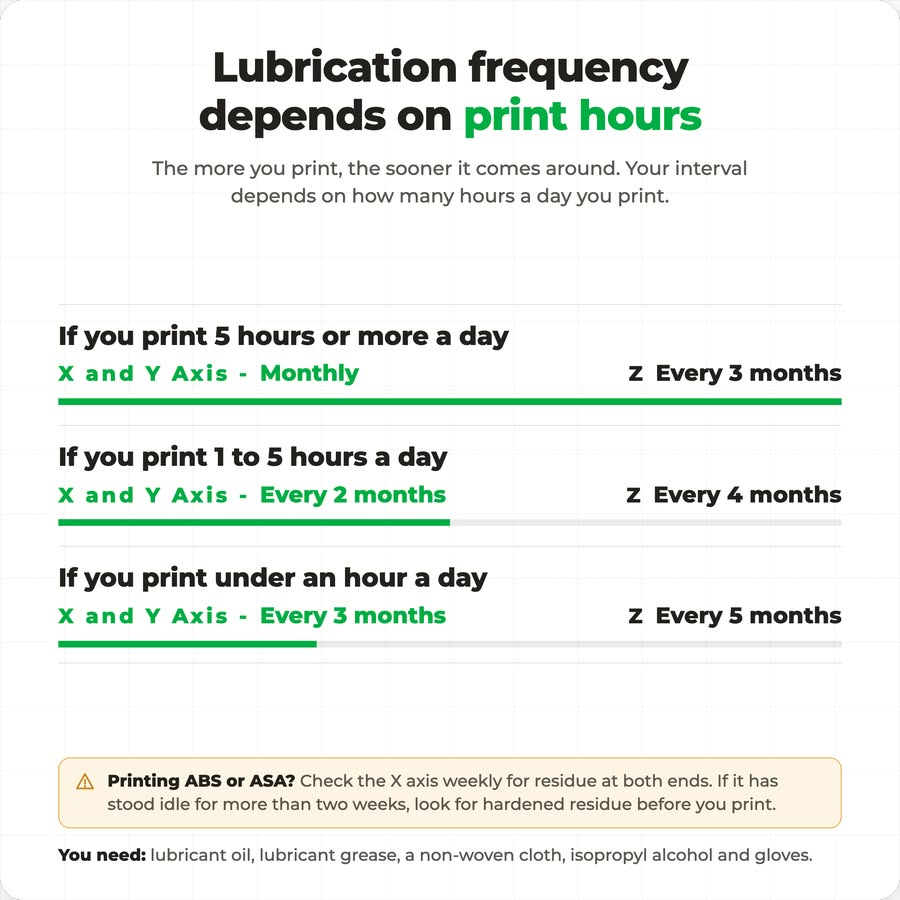

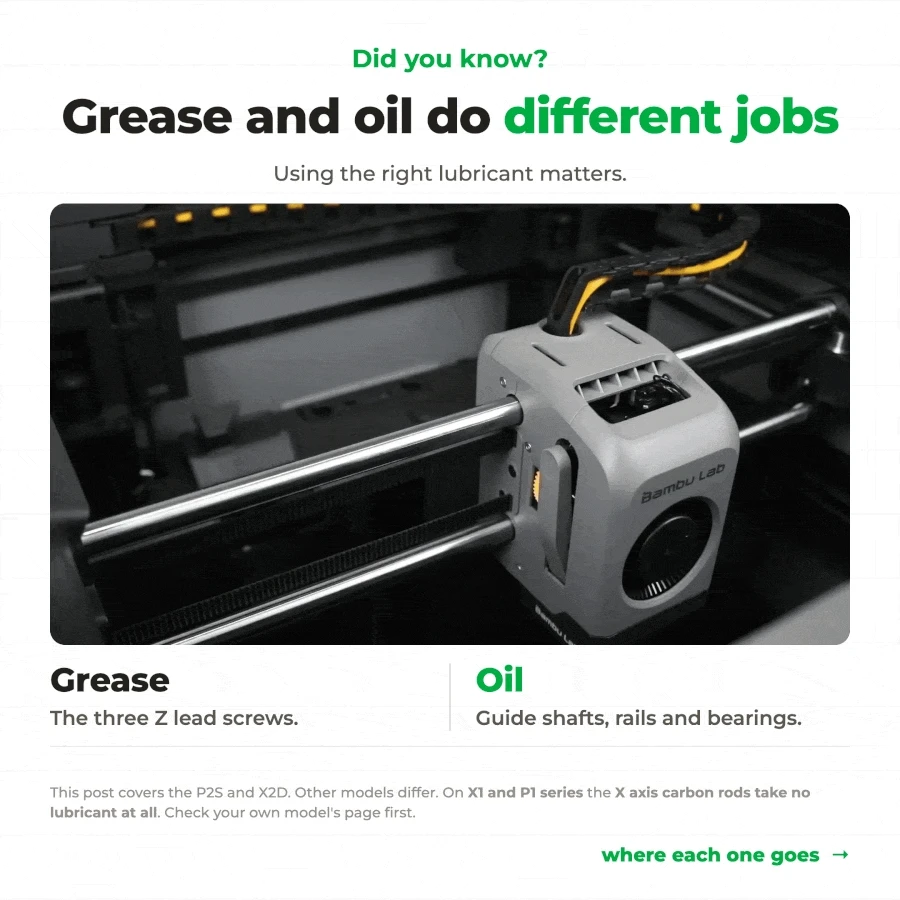

Did you know? Grease and oil do different jobs
1. Lubrication
4.Lubrication
If you want to learn more about the differences between the lubricants used for maintenance, check out the Bambu Lab Wiki: Lubricant Grease and Lubricant Oil | Bambu Lab Wiki

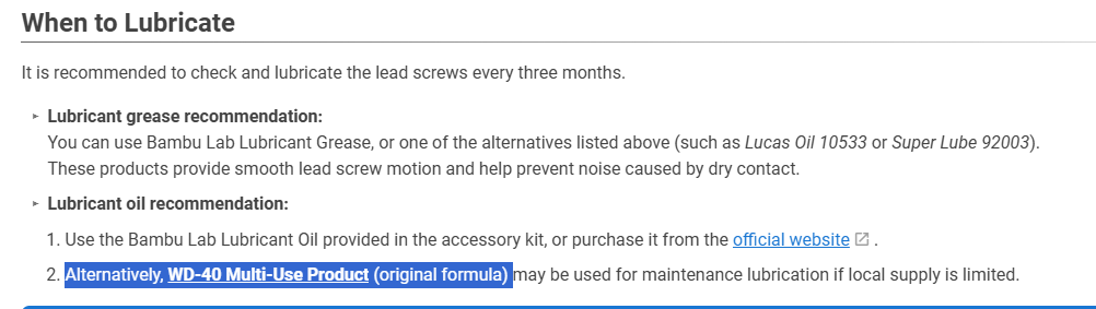

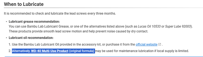

Sorry, but this is nothing more than a typical corpo tone deaf response.
Especially, considering that you list a freaking WD-40 as an alternative in your wiki… which is not even a lubricant at all.
Please follow this link, for more information about the WD-40 Multi-Use Product which can be used for A1 lubrication.
