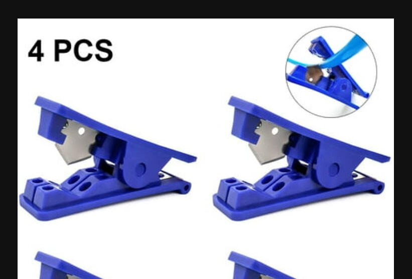

On topic, to add to this PTFE tutorial
Use one of these whenever making a cut that is going in a fitting
Badly aligned cuts create a lip on the inside of the pneumatic fitting, and that lip can catch solid things like the slightly curved leading edge of your filament spaghetti traveling thru tubes.
