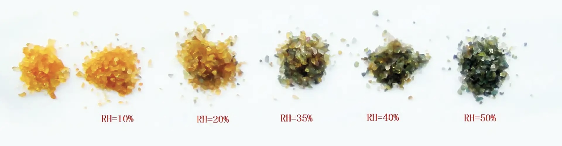

Using the color indicator is very reliable but is hard to really judge what water content the beads are actually at at low water contents and when they should be regenerated. The hygrometers in the AMS units are a better guide on desiccant water content.
I don’t know what indicator you are using but if it’s like the orange/green, waiting until the color really changes puts the humidity at levels too high for some filaments. Hygrometers tell you right where you are.
Waiting until the silica gel is “full” is way too late in my opinion. Silica gel can be a water sink or source. If the silica gel water content puts it at a humidity higher than the filament water content puts it, the silica doesn’t help dry the filament - it hydrates it.
At least with the orange/green beads, waiting until they turn fully puts them at something around 50% humidity. If those are in an active dryer they will add water load to the active dryer besides helping the filament pick up more water.
I would (and do) regenerate my beads used in storage at between 10 and 20% RH - well before they turn green. I’ve found keeping my filament well below 20% RH gives the best prints without water issues.

It depends on the indicator though. I’m not familiar with the orange/purple indicator but if it fully transitions by 10-20% RH then letting it go to full color change is correct.
What matters is maintaining desiccant at least below 25% (IMO) but if people are drying filament to 10%, maybe changing/regenerating desiccant at a lower value might be of value.
That’s why I posted the color change/humidity chart. It would take a similar graphic to know if letting the orange/purple indicator go full purple is good advice or not.
Unfortunately, industry probably wants indicators that change across the whole water content range so there’s a good chance full purple is too far. But maybe it is changing across a range better suited to filaments?
