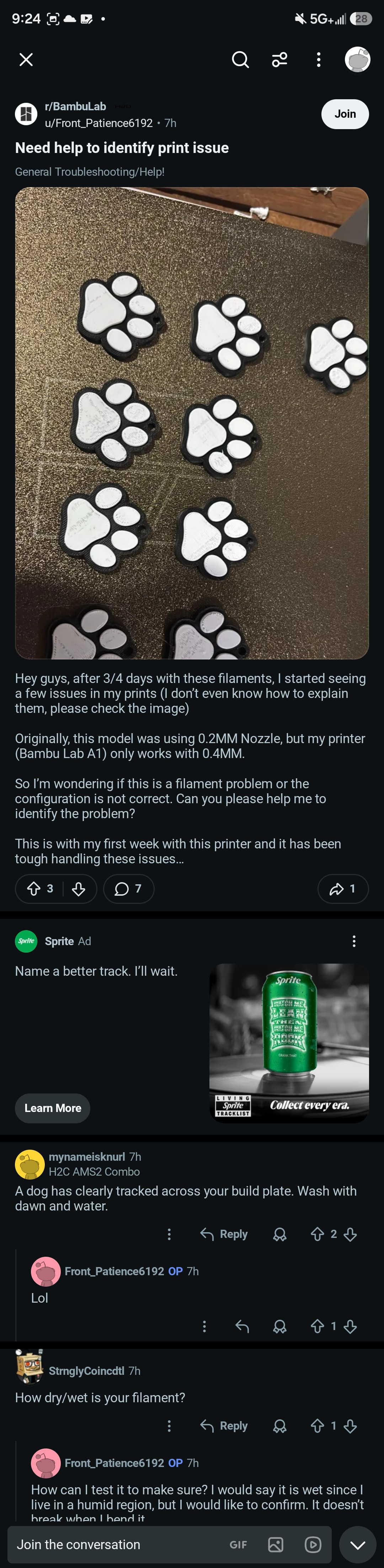

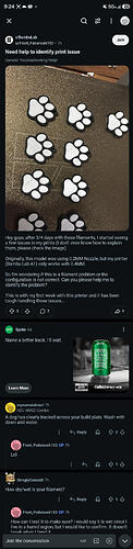

No. People must be stupid considering the first search result on Google is to use either dish soap or IPA.
Or how the default result to any issue is “clean your plate with dish soap”.
You must have to look really hard if you are looking for misinformation.
I have never seen someone recommend using ethanol to clean plates. But maybe I am not looking hard enough. Funny thing is that it worked just as well as isopropyl.
Even the AI got it right.
…this topic? You don’t have to look that hard… :laughing:
And besides: I think you’re really underestimating Reddit - or social platforms in general - right now… not in a positive way. You have to go where newbies go, and that’s usually Reddit - or, if you’re older, Facebook.
At least have the decency to include the context…
Were they recommending anyone do that? No. They were skeptical of the practice.
Not saying there isn’t a bunch of dumbasses on reddit, but this is one thing they get right.
First post about print issues I saw
First 2 comments are to wash your plate and dry your filament.
