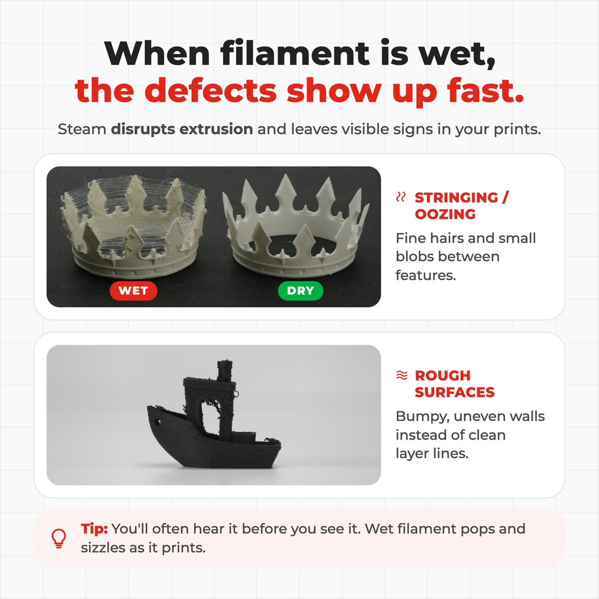

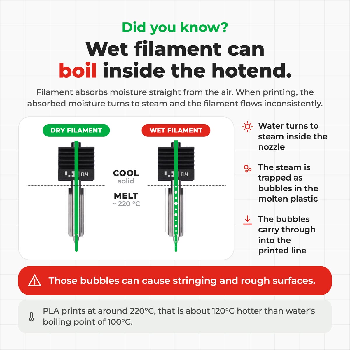

Did you know? Wet filament can boil inside the hotend

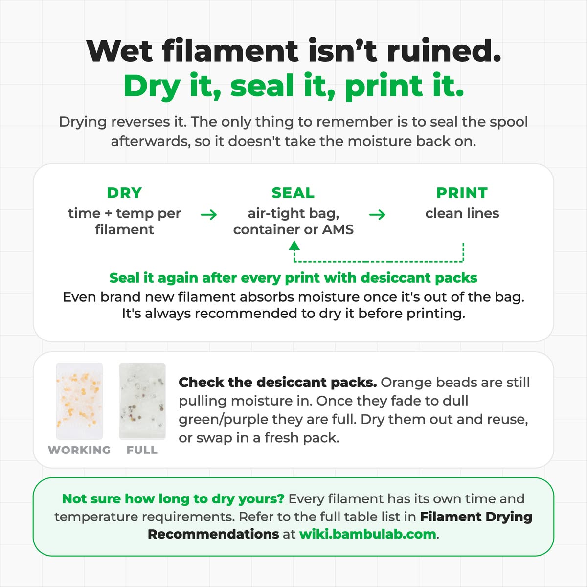

Learn more about filament drying from Bambu Lab Wiki: Filament Drying Recommendations | Bambu Lab Wiki
But a few modifications — wet filament CAN be ruined if too much moisture gets in thanks to polymer chains being broken as excess water forces its way in. This causes brittle filament that breaks easily in AMS and extruder rollers.
The indicator in orange (and probably blue but that’s cobalt and a carcinogen and best not used in home environments) has a way too high humidity if it turns dark green. Depending on how it’s being used, it may need to be changed out while still some shade of orange.
The best way to judge the water content of silica gel desiccant is by measuring humidity in a closed container with it in there,
And in my experience water effects aren’t just off/on. They gradually kind of fade in depending on model complexity or requirements for well-behaved filament. Some models may print fine at a certain water content but something with overhangs or other more difficult features may show water effects at lower moisture contents.
