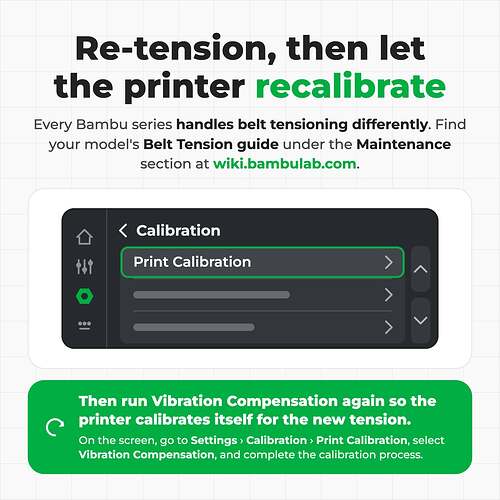

Belt Tension_1_result
1200×1200 123 KB
Belt Tension_2_result
1200×1200 126 KB
Belt Tension_3_result
1200×1200 127 KB
Find your model’s Belt Tensioning guide under the Maintenance section in the Bambu Lab Wiki
