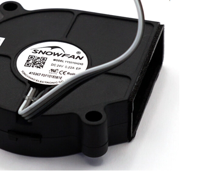

So I ordered another toohead cover, it came with the 0.22amp Snowfan, I compared the two fans with these instruments (+ a cellphone dB app, held at the door of the printer) here’s the results, maybe 7 percent better, and 8dB quieter.

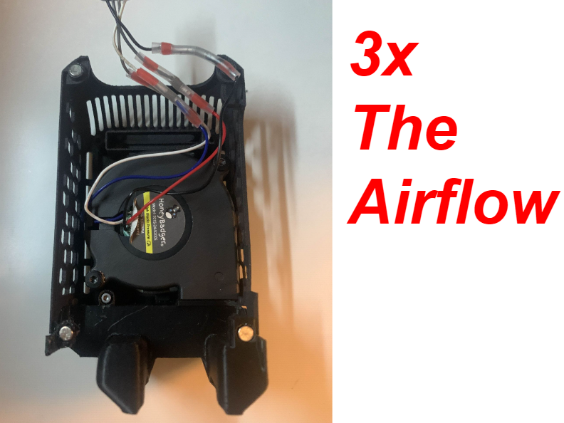

  • 15.3 CFM 3do.eu/fans/193-gdstime-5015-24v-blower-fan-346dba-6000rpm.html
  • 5.41? CFM 3do.eu/fans/1148-5015-blower-fan-by-honeybadger-7200-rpm-3-wire-pwm-for-nevermore.html
Is there a typo in the nevermore? Or can the differences be this huge? And or is CFM not the best metric to assume cooling capabilities?
Could be the way they calculated the CFM might be different. (I wouldn’t swear my testing to be exactly correct, but I feel the general percent comparison of the two Bambu fans is mostly accurate)
Fabreeko’s numbers are the same as the 3DO ones, Honeybadgers
I’m guessing they would be very similar in perfomance, given the similar amps and pressure numbers.
For cooling, my understanding is that we need to transfer heat from ‘hot thing’ to air molecules, so more CFM should gererally mean more cooling up until something else in the system is the limiting factor, like innefficient heat transfer from the thing to the air, no matter how much air passes over it.
I think they are rated at 5.36 CFM, which is the value i find the most, if that’s any indicator. Harder to get in Europe though.
In regards to the Snowfan;

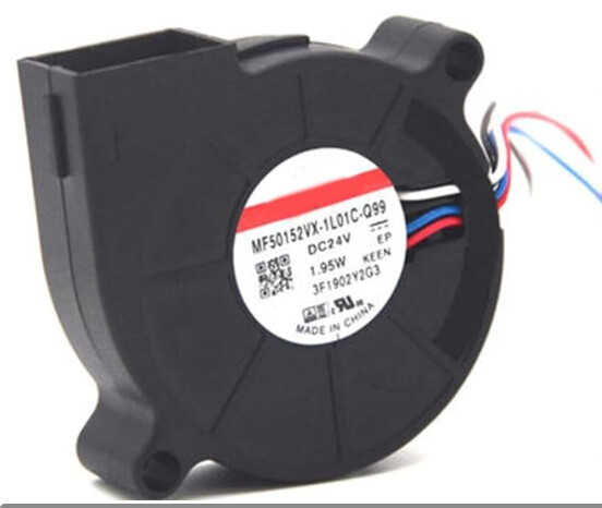

Hi! What you think about sunon MF50151VX-C03C-S99?
Can 4pin (From fan) solder to standart integrated terminal?
You can definitely solder a Bambu connector on to it but two things to keep in mind. 1. The Bambu fan is 24v and the Sunon is 12v and 2. The Bambu fan has the double wide mouth that connects to the duct, the Sunon does not. You can print a new duct from MW to make up for the mouth, but you really need a 24v fan.
  1. MF50152VX-1L01C-s99 i mean thats one) It’s 24v.
  2. I’m understan what about you are talking. But i’dont know how it’s look like
    Can you send link for this print please, if it possible
Ask about sunon because original part i can buy only in other country and wait about two week. Sunon i can buy aftertomorow) May be some one can send other model 5015 which we can use.
And can we use 5015 fan with 2 pin?
