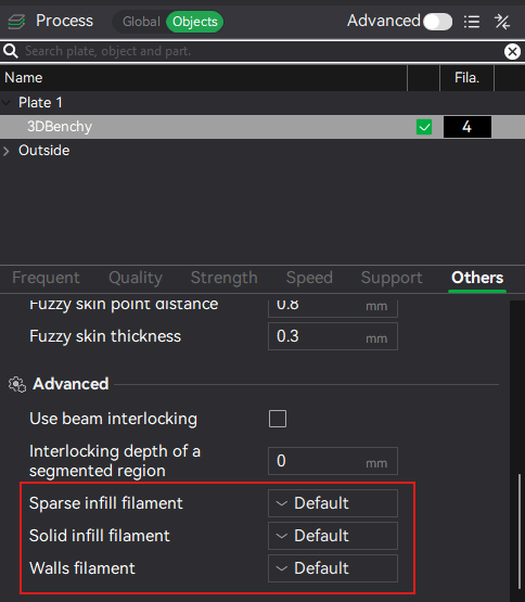

I saw this got added but i cannot find it in the slicer. I have seen screenshots but it does not appear to be in my most recent version of Bambu studio.
Can someone help me find it?
Enable Develop mode in the slicer and you can access it in the Objects view.
Finally a good way to use carbon fiber filament. Can print petg-cf infill then regular petg walls rather then using encapsulation post processing. If only you could mix nozzle size for infill and outer walls it would be perfect.
Thank for this tip. Just I try it for TPU walls and PLA infill.
