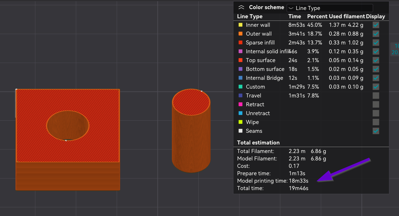

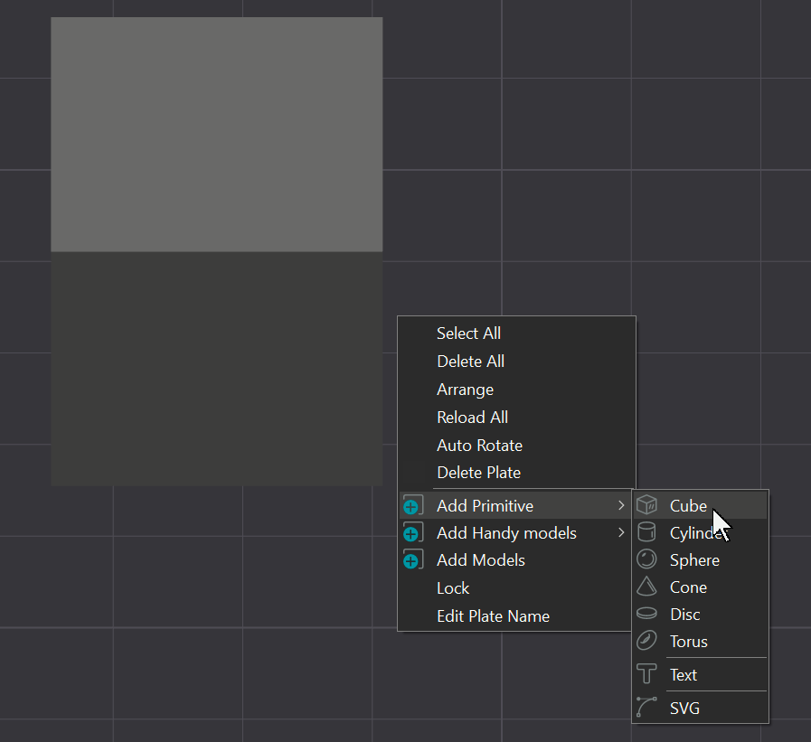

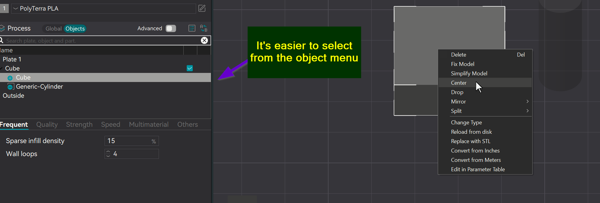

One other suggestion. Don’t waste your time with downloading models. To be honest, there mostly ego-driven models by the creator trying to show how “clever” they are when in fact that are filament and time wasters. Here is a much easier approach. This assumes that we are testing for X/Y tolerance. For Z, flip the models.

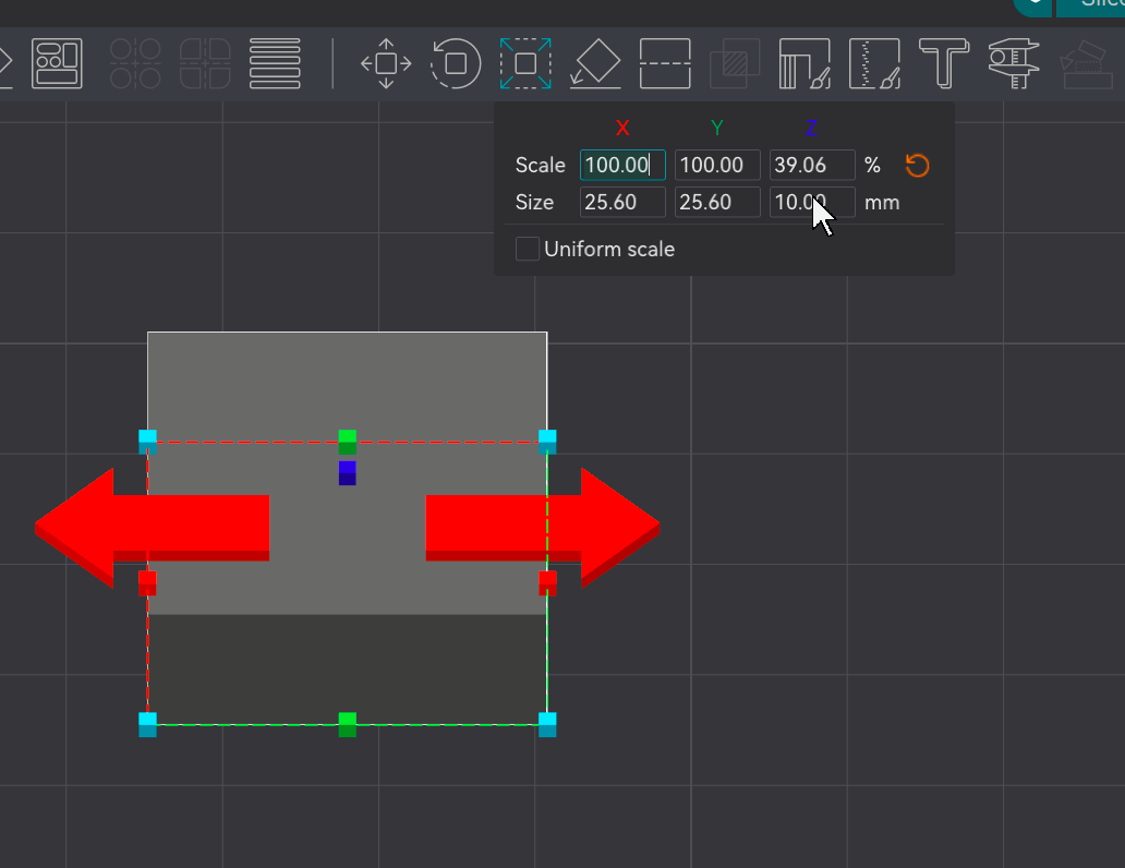

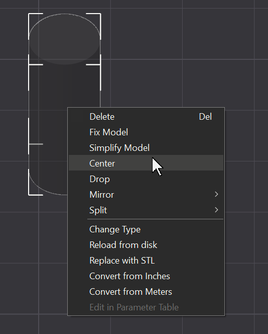

  1. Take a cube primitive and scale it to 10mm in height.

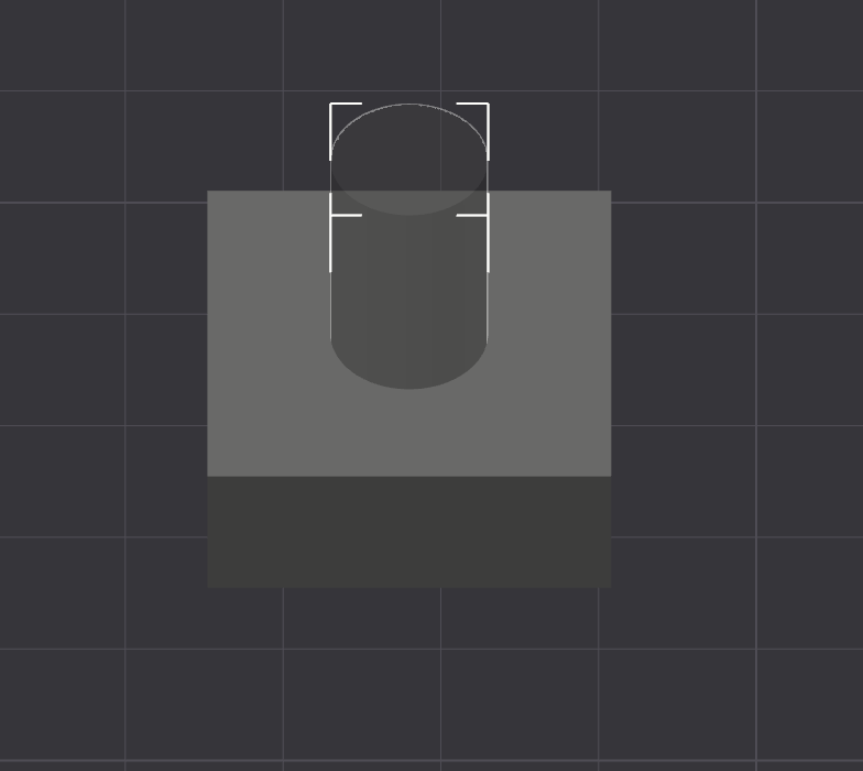

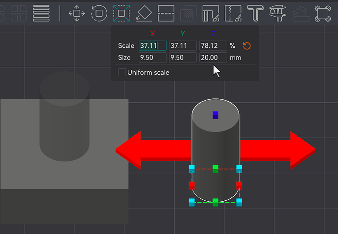

  1. Add a negative part and scale that part to the cube, I’ll use a cylinder in this example. Scale it to half of the width of the cube and center both objects. Click on gallery to scroll through images.

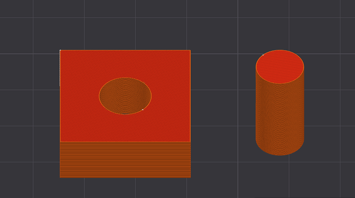

  1. Create a separate cylinder primitive using the same dimensions. (note, these will not fit so you will want to scale one of them by some amount until they do fit).

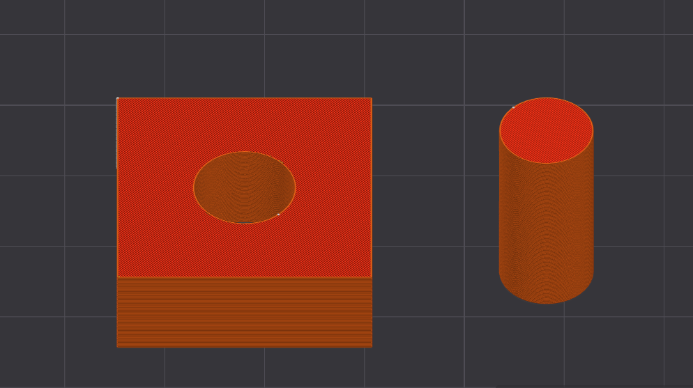

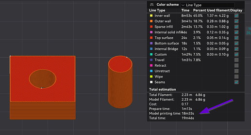

Save the 3MF file and print them on both printers. Find a way to mark the models so that you know which came from which.
What will this accomplish? Based on which hole is too small/large by interchanging the models built on different printers, you’ll be able to determine if this is a shrinkage problem or a dimensional problem.
The advantage to doing this is time. Use a smaller model if you want to save even more time but larger models allow for measurement of greater tolerances.

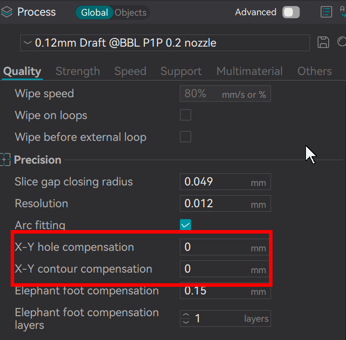

Using the X/Y compensation, you can also modify the printers expansion/contraction temporarily.

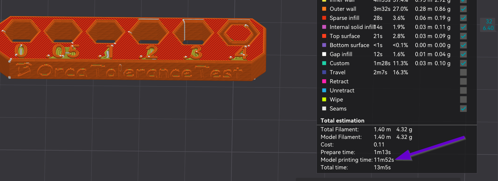

Alternatives to making your own model

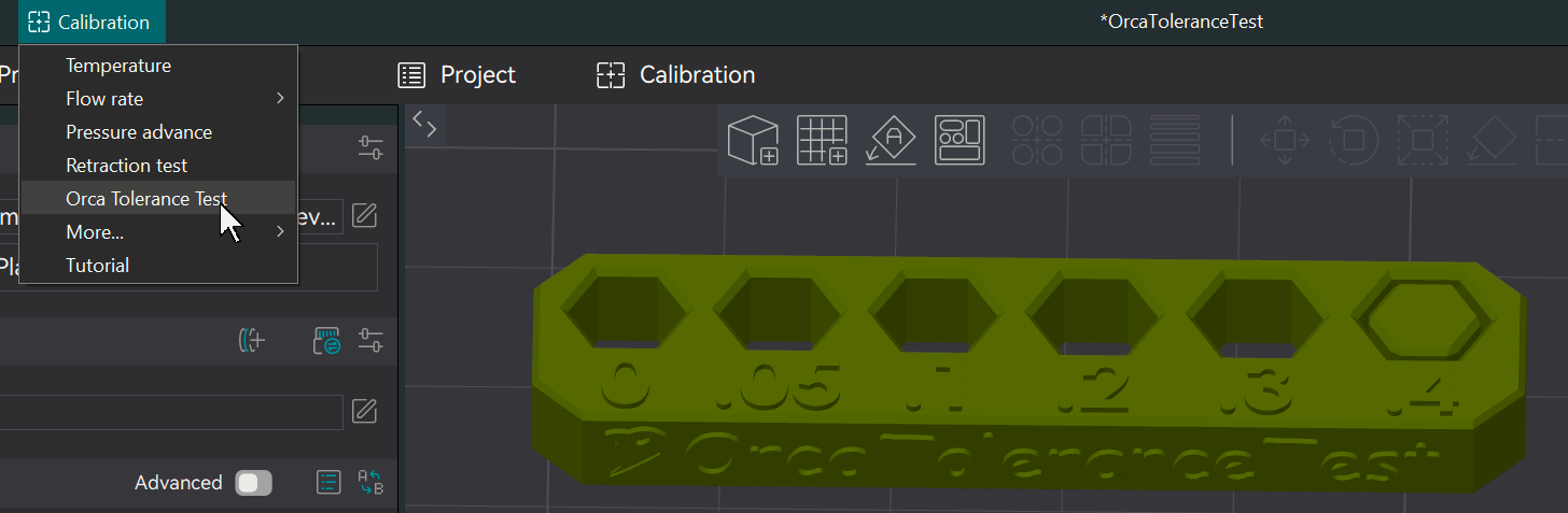

If you must print up a calibration model then I suggest the one baked into Orca Slicer.
