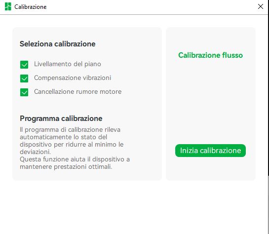

Hi Alex_vg, I ran the test as you can see, and these are the results. Unfortunately, I didn’t understand where to input it — my English is really bad. Can you help me?
Sorry, but I’m going crazy — what do you mean by that statement???
I didn’t understand where to find it, what it is, or what to do… oh God, I feel so stupid.
calib
Are you referring to this one?
With flow calibration in BambuStudio, I mean the last tab “Calibration” next to “Prepare”, “Preview”, …
I sent you details in the direct message.
Ah sorry, didn’t see your other messages. I’m not actively using BambuStudio, but mainly Orca Slicer. I was told, that BambuStudio also has the field for shrinkage compensation now in the filemant settings. I have BambuStudio version 1.8.4.51 and I didn’t find the field there :frowning:
