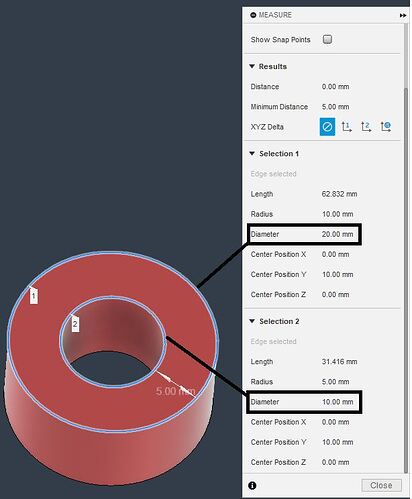

These printers do not print dimensionally accurate parts. I have noticed this issue on the first printer I bought/returned, and this replacement printer suffers from the same issue. It does this with all types of filaments, and all different brands, so this is not an issue with filament shrinkage or expansion.
Only way I can get parts close to accurate is to adjust X-Y Hole and Contour Compensation in the slicer, but this does not translate the same to circles and squares the same way. The other problem with having to adjust the slicer is that it can mess up the geometry of the parts where they have visual defects like countersunk bands on the outer walls (you can see these defects in the slicer preview as well as printed part).
If setting X-Y Hole and Contour Compensation to 0mm, my hole and contour dimensions are undersized by .15mm - .2mm which makes important parts not fit that must be dimensionally accurate. If setting to .1mm on both, the circle dimensions are almost perfect as far as accuracy, but this does not translate the same for squares and other shapes.
Basically these machines are calibrated incorrectly when it comes to the steps per mm on the X/Y axis, and there is no way to fix this. Calibrating the machine or printing the calibration patterns before prints does not make a difference either.

@Alex_vG @gooselk @Olias I will wait till you see this message before I close it, but here is proof that it has nothing to do with shrinkage or filament issues.
.4mm single wall done in vase mode using PLA that I have calibrated. Wall is .4mm wide (it flickered between .4 and .39mm), yet the outside of the printed part is .16mm too small when setting X-Y Hole and Contour compensation to 0.

Really on such a small part with a single wall, slightly reduced diameter is absolutely expected. The point here is not shrinking due to cooling. Instead, for any inner curved wall, the elasticity of the molten plastic will slightly pull it inwards. Imagine the filament coming out of the nozzle like a rubber band. The last few millimeters are fixed by the layer below, while the freshly extruded plastic is still soft enough to slightly collaps to the inside.
Your single wall cylinder effectively is only one inner wall.
I guess that if you print such a cylinder at double diameter, it will still be too small the same 0,1…0,2mm.
I have heard and experienced that everywhere throughout my 3d printing journey. Slicers even have a dedicated setting to compensate for it.
In my opinion, your printer and slicer are perfectly fine and that effect is just something that you have to be prepared for.

I haven’t used 10s of printers but my Ultimaker 2+ (a Marlin open source printer for 2500€ at the time) and 2 other Marlin printers I use occasionally all do exactly the same thing:
For smaller parts, outer dimensions are typically within 0,1mm accuracy. Larger parts need compensation of shrinking, according to the material datasheet. Inner diameters (actually any concave arcs) are typically 0,15-0,2mm too small in diameter. I increase those already during design by at least 0,2mm. Others have reported the same story here.
So I’m very sure that this is not a problem of his unit or bambu printers but it is a limitation of the manufacturing process.
