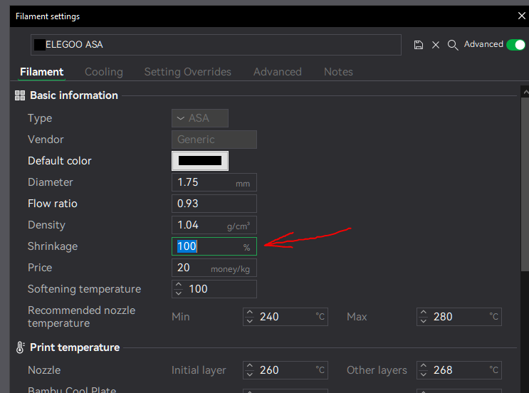

However, I notice, like other users, problems with the dimensions of the parts that are too small (-0.6 mm for a dimension of about 150mm on my tests)
After trying to read everything that is said on the forum, I did not come out with a definitive answer. It seems that this is a topic that generates “lively” discussions :wink: :wink:
So I did my tests and my measurements, and here is my little analysis:
  • The machine is very precise mechanically speaking: when you ask for movements of 150 x 150 mm you got them precisely on the bed. If you measure a 150 x 150mm hot part on the PEI without taking it off, it is indeed 150 x 150mm to a few hundredths.
    -After taking off, cooling and resting, the part decreases to 149.4/149.5 (depending on the materials). We are therefore in the presence of a shrinkage phenomenon.
    when we calibrated our old machines with the Estep, we measured cold test parts, and we modified the steps by adding the shrinkage with the mechanical differences in this correction. We therefore had the impression of having more precise machines in the end, which was probably not the case… We only had to manage the small differences in shrinkage between the materials.
Bambu lab does not give access to the firmware and the Estep setting, so you have to proceed with the filament shrinkage coefficient. It works perfectly, and I recentered my dimensions precisely

Bambu lab now has the shrink compensation in bambu studio, so I no longer have this issue and can stick with Bambu Studio as my slicer… I still think there should be a shrinkage compensation calibration on the firmware side, but the shrink compensation in the slicer is good enough for me.
Have you tried it yet? It will automatically resize your models based on the % you set per filament.

Yes I know this filament shrinkage coefficient, and I use it with success. I said that in m’y previous post. Probably too long :smiley:
The only issue that remains for me is this slight difference between X and Y . I can’t find no way to correct it , as the command M290.2 Y… in start G code doesn’t work on m’y trials…

If you’re look for super accurate parts, I think your only option would be to scale the parts size X Y Z individually in the slicer before printing. I’ve done this for so long now that I don’t use the recently provided shrinkage because it only applies to X&Y. I’ve never needed to do it the way you need it to be done, as I just scale the whole part.
It’s a pain but I’m used to it now.
