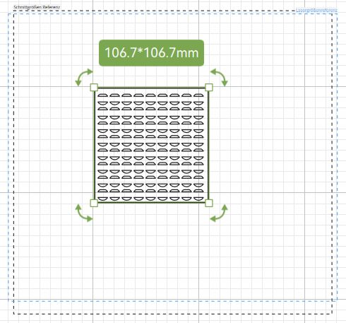

I have a dimension error in Bambu suite.
When I load an 80x80mm square in the suite, it is displayed as
106.7x106.7mm and is also cut with 106.7mm.
Does anyone here have any clues as to what is set incorrectly?
Thank you very much for your tips
Where are you loading the cube from? Is it a stl, from a program, or a bambu primative? Do you have a file if it is a stl, etc
Edit. I just realized this is bambu suite and not bambu Studio now that you added the photo. Either way where is the generated file coming from? And what format is it?
it is done by Fusion360 and translated to .svg by inkscape
I double checked the correct dimension in both but when I open the file in bambu suite you will see the picture above

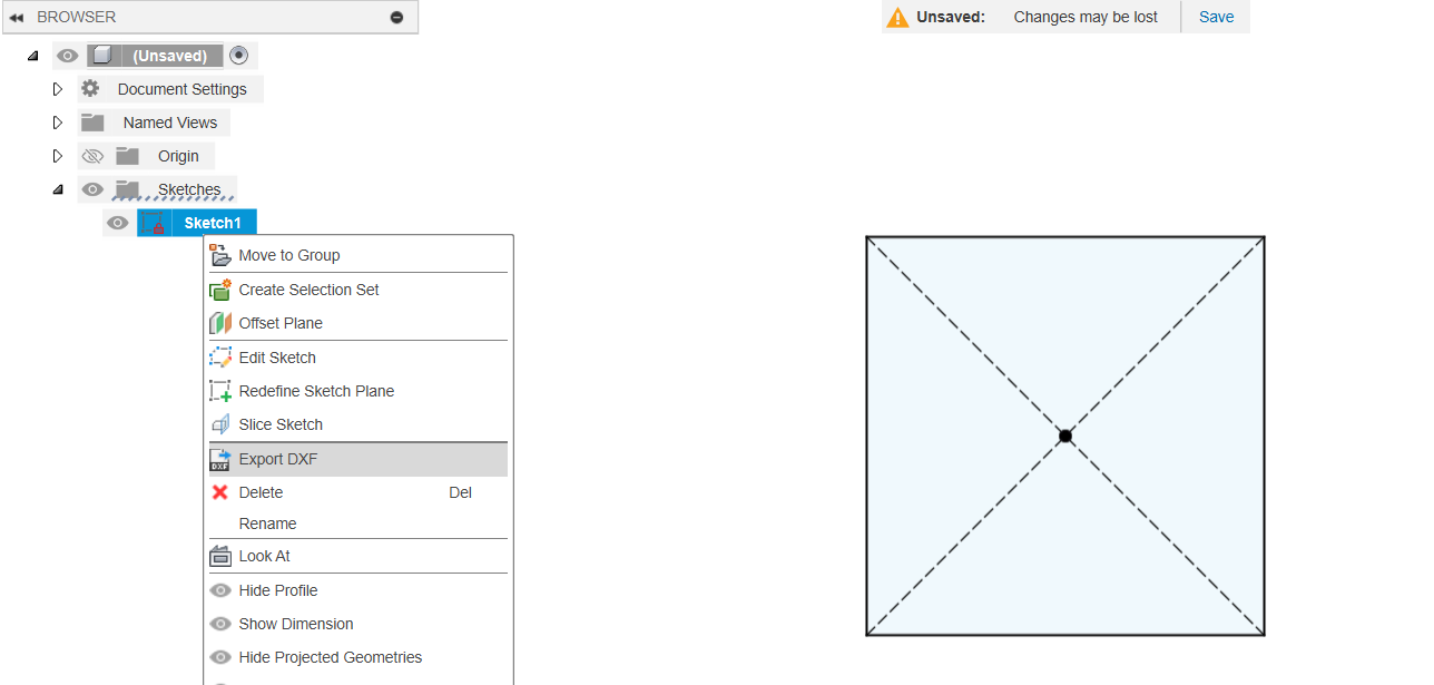

Try this, it just worked for me for an 80x80mm square Maybe its something with ink scape exporting improperly.
  1. Create a sketch in Fusion360.
  2. click finish sketch.
  3. Right click on the sketch and Export DXF
  4. load that dxf in Bambu Suite by clicking on the image icon and loading it “For Laser”.
Thank you very much, that’s a really quick help.
In the picture below you can see the difference between importing dxf directly from bambu suite and importing the svg file.
I think bambu suite has an error here
I’m going to try cutting and I’m curious to see how thin or thick the cuts are.
