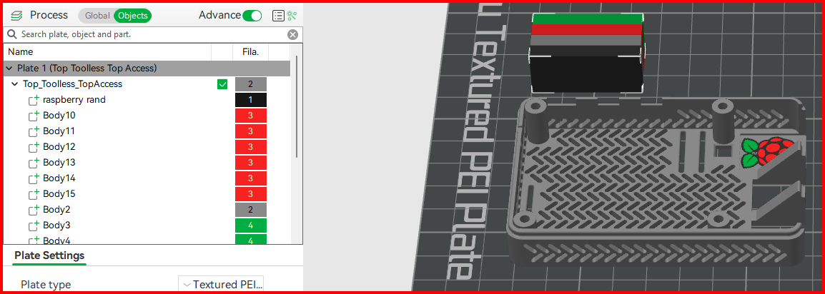

Hi all, this might be another dumb question from me but I was wondering if there is a way to disable flushing when making color changes to a multicolor model. If I open up a project from makerworld that has 3 colors, but I go and set them all to a single filament, it still flushes and reloads the same filament as if I was still using different colors. Google showed and option where I could edit the gcode manually but I am hoping there is a setting somewhere that simplifies this.
Do you click on the minus sign on the left panel to remove filaments until there is only one left?
Two methods to select filament when multiple are listed (like if you have an AMS):
  1. Use Ctrl-A (Windows) to select all objects and parts (note they are not the same thing). Then right-click the selected Change filament at the bottom.
  2. Or right-click each line in the list and select Change filament
Yes this worked, I should have figured that out lol.
I don’t recall that being an option as I tried that but will look at it again. This would be better if I wanted to go from say 4 colors to 2 or 3, but since I wanted just a solid color I just removed all filaments like the other commenter suggested.
