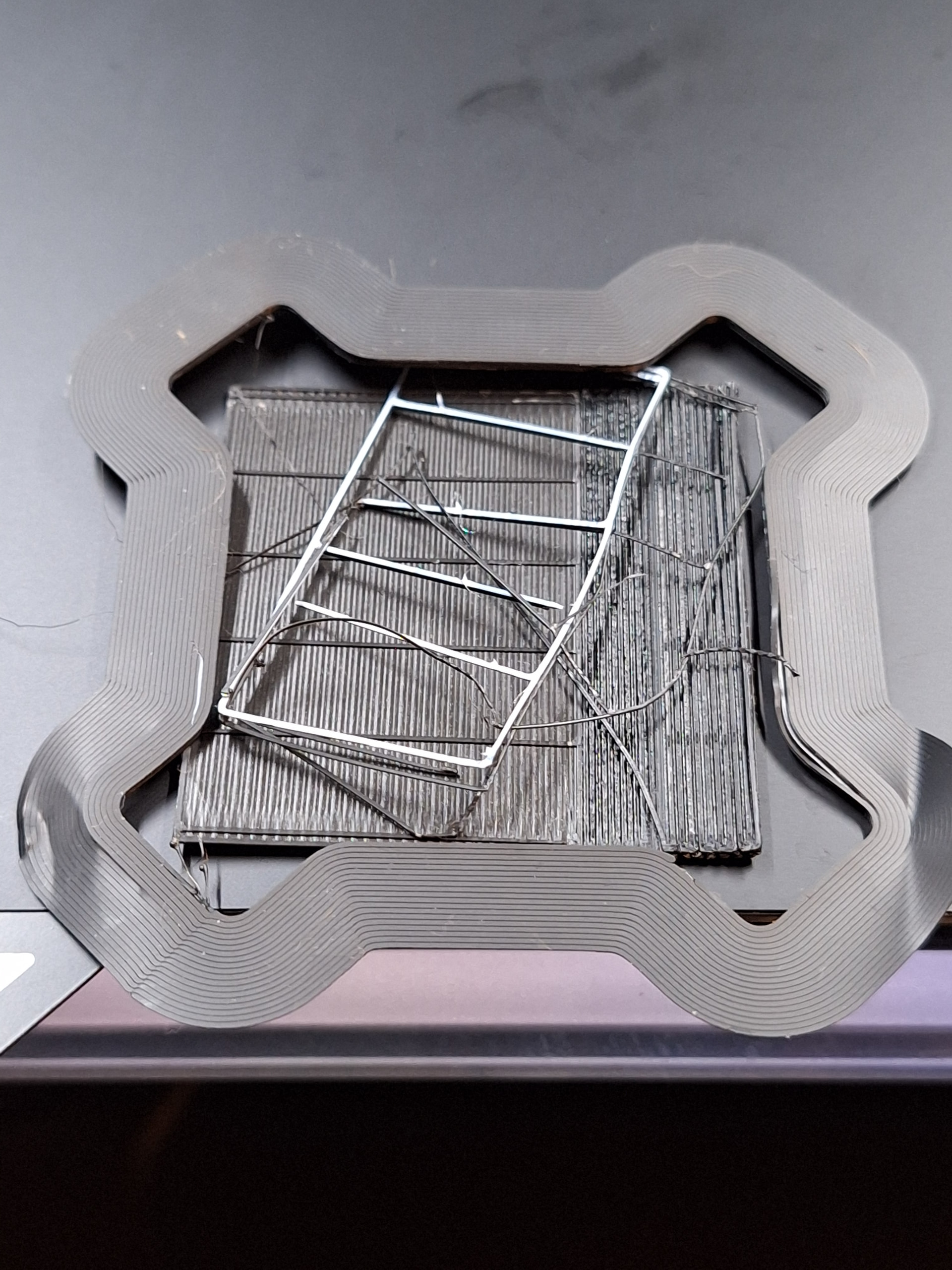

Disable priming tower
often, mine prime tower break when i build
big model, multicolor! now base stay on plaque
but break sometimes and i wish
disable it as i choose object when i built
many piece in one time!!
not possible this?
You can disable this in Bambu Studio by looking for prime tower in the “other” tab for the global settings and disable it. But you risk color contamination in multi color prints.
I promise disabling the prime tower altogether isn’t the solution.
You should post in the correct subforum for your specific printer more information about the prime tower issues you’re experiencing so we can help you fix them.

For something like that figure I’d use a prime tower. If you are having problems with it coming loose during the print, you can give it a bigger footprint in the settings and/or use some glue on the build plate along with the typical clean properly advice.
You have lots of room to make the prime tower more sturdy from being knocked loose.

2 times, 2 prime tower!
first picture show base on plaque, rest just 2 couches, not move on so don’t need colle almost pla on smooth pei plaque! and 2 time have point on top, maybe is this breack it! but why, each time 50% of print, when brown not appear, but need more, brown and gold with black and white and sup
That looks like a mess. Are all your filament colors used in the print well-dried?
dried, just 1 tried to colle one tower after she breack!
and “amorcage” too much as 2 mm! i tried to change “retractation” when hotend change!! pass to 16 or 18 and maybe 2 mm on filament sup when long travel!! but used PETG now!!

miss one fact, Z test! i ajusted z axes under printer and need test because!!
evry time same height
Post your 3MF file and please list exactly which filaments you’re using.
resolves, Procédure de tension des courroies H2D | Bambu Lab Wiki !! courroie Z, il me manquait mon frère pour cette maintenance
