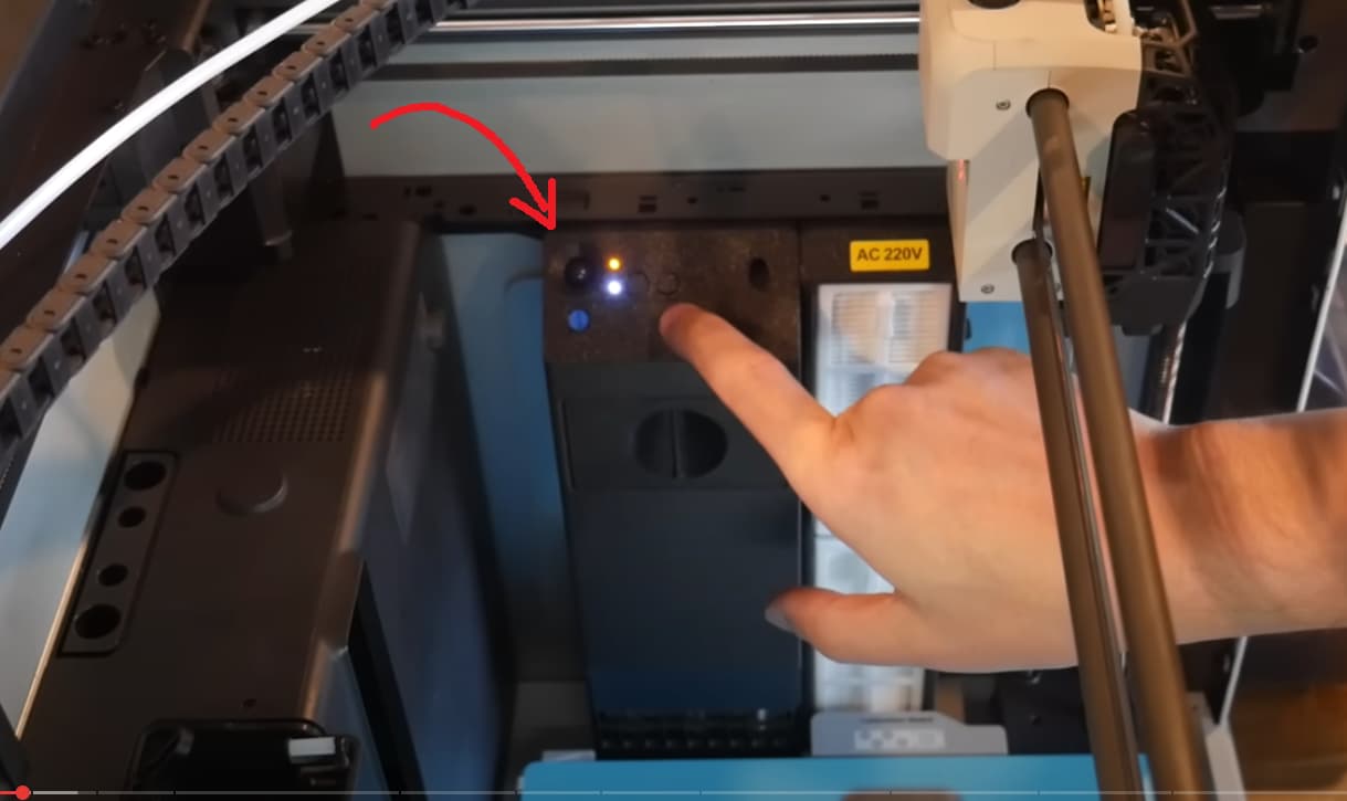

Disconnect printer from AC using a command and a low voltage relay
Does anyone know if there are ANY contact points (prefer 5v) that go either HIGH or LOW when print is finished ?
Want to use a small relay to disconnect the printer from the AC so it does not stay connected to the CPP all the time

You may also need a delay after the print finishes so the fans can reduce temperatures before power gets cut.
The toolhead lamp is only one when the printer is “active”. First thing on at the start of a job, last thing off at the end. You could grab that to drive a FET to switch your relay.
I dont see any lamps on the toolhead that lights up.
I have P1S.
Am i missing something ?
Ah. I have an X1C. Sorry.
There is nothing you can use for a simple logic HIGH / LOW for print status indication like that.

I dont need motion related switch. I need to push the button (i will add that) click the relay and printer will stay ON for as long as some code does something on a hardware level that i can use to trigger the relay to go OFF.
Standard process is command M81 and i am sure there is some kind of command that can be used but i doubt bambu will share it.

I know I’m late to this party but there is a Home Assistant integration that exposes several Controls, sensors, configuration and diagnostics. I’d suggest running a ESP32 relay in series with the power switch and set up an automation to switch the relay after a print when the bed and hot-end is cold. It will require running a button to bridge the relay contact to start it up however unless you supply 5v to the esp via a powerbank?
Look into ‘Home Assistant’. You can run it on a computer or raspberry pi. You’ll install HACS and Bambu Lab support. Once you have it setup and connected to your printer it can monitor the printer status and take actions based on the status e.g. when a print job is complete run a process that turns a relay off to power down the printer.
Since the topic has been raised again, here is some additional information. There are now modern methods for implementing this using the API. Everyone can query the status of the printer. Possible queries:

A Raspberry Pi Zero with WiFi is all what is needed to perform the query. For example, it can then send the signal to a smart power outlet. No rewiring or modification of the printer is necessary.
…or the excellent solution that user_84684547 has already posted. My comment is intended as a addition, not a replacement.
With a “smart” plug that measures power consumption and can be scripted you could look for power consumption and if it hovers around 7W for a few minutes there is no chance a print is still running. Consumption during use, PLA with no bed heat is 60W.

If you used a ESP32-C6 instead of a Pi Zero, you’d be able to talk directly to a Zigbee wall socket or lamp controller. No need to for a Home Assistant system.
Still, there’s no easy solution for people who don’t have the knowledge to “roll their own”.
I’d put the printer on a timer. Set it for a couple of hours longer than the slicers says the print will take. Still suboptimal but easily implemented by someone who doesn’t have the engineering background for a more complicated solution.
