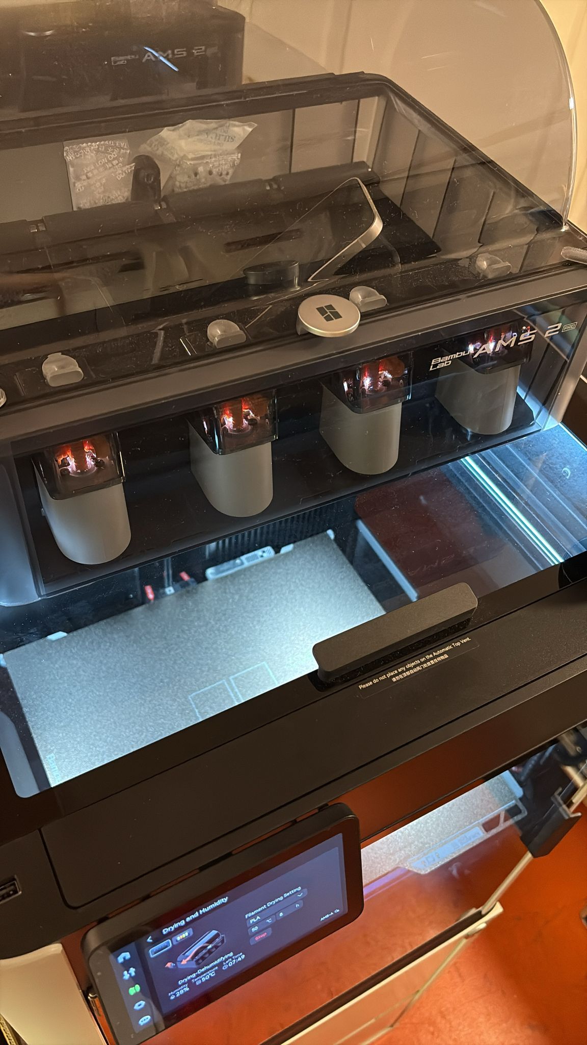

Discovered a New Feature in AMS (2 Pro)
Today, a friend of mine dropped his phone in the lake.
After retrieving it, the phone was dead, and now he’s trying to revive it by drying it out.
Fingers crossed :crossed_fingers:
Without taking out the battery you’re basically creating a fire…
Fingers crossed that you can see this and remove it asap.
Why not?
But wait… what filament did you say it’s drying again? :rofl:
This would probably work, but I wouldn’t go above 40°. Lipo’s can degrade or get damaged much above that. And damaged lipos can catch fire.
It depends on the temperature he’s using. I’ve dried a lot of electronics in my dryers before—low temperature over an extended period is generally safe.
I even heat phones to around 60 °C to soften the glue for disassembly and repairs. I haven’t had any incidents so far, but caution is always important.
Safety first.
Heating like that is safe because it doesn’t take long to soften the glue on the heatbed, but he’s cooking it in the AMS for… I don’t know how long…
Most phone batteries are rated up to 45C. And the phone here is already dead meaning a build up of conductive stuff or corrosion has already been there. Which makes the spicy pillow even more spicy.
LiPo batteries can certainly pose a fire hazard, but modern mobile batteries are no longer open-cell and are therefore not as sensitive as they used to be.
That said, I’ve had a few RC models catch fire mid-air after abusing the batteries or continuing to use them after crashes. :grin:
So always handle LiPo batteries with great care.
Better mid-air than in the house
You’re better off leaving the phone over a day or two in a container full of silica beads

Fire? Not a likely outcome unless there’s noticeable swelling of the lipo cell.
The energy stored in a cellphone LiPo battery isn’t tiny, but drying it in the AMS is no riskier than tossing it in the garbage or even leaving it on the table.
User would have better luck saving the phone by putting it into a significantly greater amount of dessicant or rice (submerged in rice in a gallon bag is a good approach).
Rapid discharge of a lipo -can- cause swelling of the battery, which -can- cause rupture, but that’s not a common failure mode from a wet cell phone. Without a continuous source of moisture, heat from current flowing through the device will evaporate the moisture conducting the current. Drying it out faster will reduce that risk.
To play it extra safe, strongly advise user to keep an eye out for noticable swelling. Otherwise, you’re likely fine. Can’t say the same for the cell phone. LCD screens are rarely the same after exposure to moisture. If you see swelling, do not toss in trash; take to a disposal center. Many landfills and recycling centers accept swollen batteries for safe disposal.
