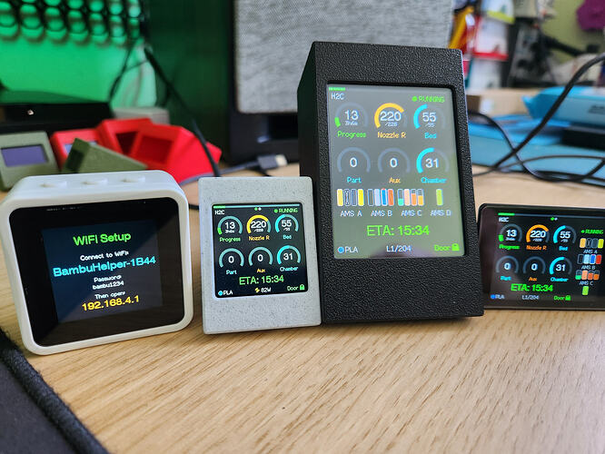

Hi everyone,
I wanted to share BambuHelper v3.0, an unofficial open-source ESP32-based status display for Bambu Lab printers.
It is a read-only companion device: it shows live printer status on a small dedicated screen, but it does not send print/control commands, G-code, or modify printer settings. It is not a replacement for Bambu Studio or Bambu Handy, just a small desk/printer-side dashboard.
What it shows:
  • Print progress
  • Printer state
  • Nozzle and bed temperatures
  • Fan speeds
  • ETA / time remaining
  • Current layer info
  • AMS / filament status where available
  • Optional buzzer notifications
  • Optional external LED print-state effects
v3.0 supports several ESP32 display boards:
  • ESP32-S3 Super Mini + 1.54" ST7789 240x240 display
  • CYD / ESP32-2432S028
  • Waveshare ESP32-S3-Touch-LCD-1.54
  • Waveshare ESP32-S3-Touch-LCD-2
  • Waveshare ESP32-S3-Zero
  • ESP32-C3 Super Mini builds
Connection modes:
  • LAN direct status monitoring for supported printers
  • Optional cloud status mode for printers or setups where LAN access is not suitable
The project started as a tiny desk monitor for my own printer, but it has grown into a more complete firmware with a web configuration portal, browser-based flashing, OTA updates, multi-printer display rotation on supported ESP32-S3 boards, display themes, buzzer alerts, LED effects, and several printable cases.
Project / firmware / wiring:
MakerWorld cases:
I would be happy to get feedback from people using different Bambu printer models, especially if you try it with X1E, P2S, H2 series, A1/A1 mini, or multi-printer setups.
Disclaimer: this is an unofficial community project and is not affiliated with or endorsed by Bambu Lab.

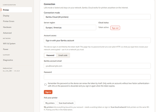

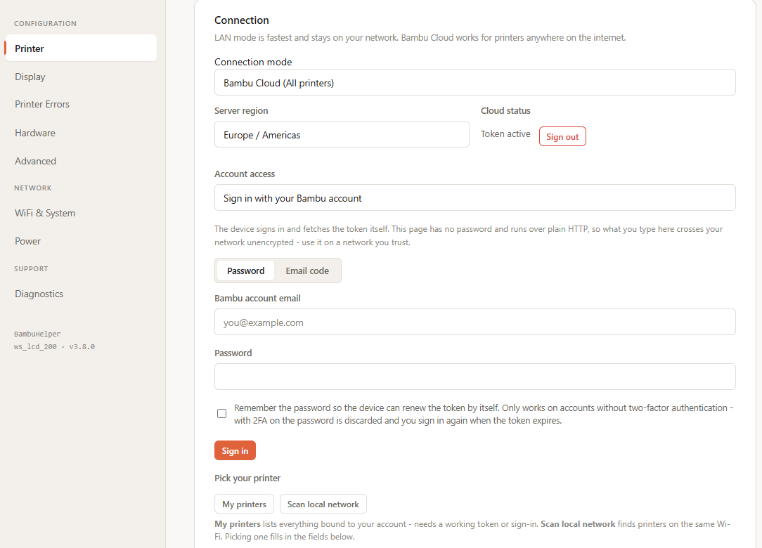

Setup no longer needs a computer
  • Flash from the browser. The hosted flasher at BambuHelper Web Flasher handles bootloader, partitions and firmware in one click. No PlatformIO, no esptool, no flash offsets.
  • Sign in to your Bambu account on the device. Cloud mode used to mean digging a token out of browser DevTools. Now you sign in from the device’s web page - with a password, or with a 6-digit code Bambu emails you if you would rather not type one. 2FA and authenticator codes work too.
  • My printers lists every printer on the account with its model and serial, so you pick yours instead of typing a serial by hand.
  • Scan local network finds LAN printers automatically, IP and serial included.
  • Pasting a token still works, and so does the Companion Tool.

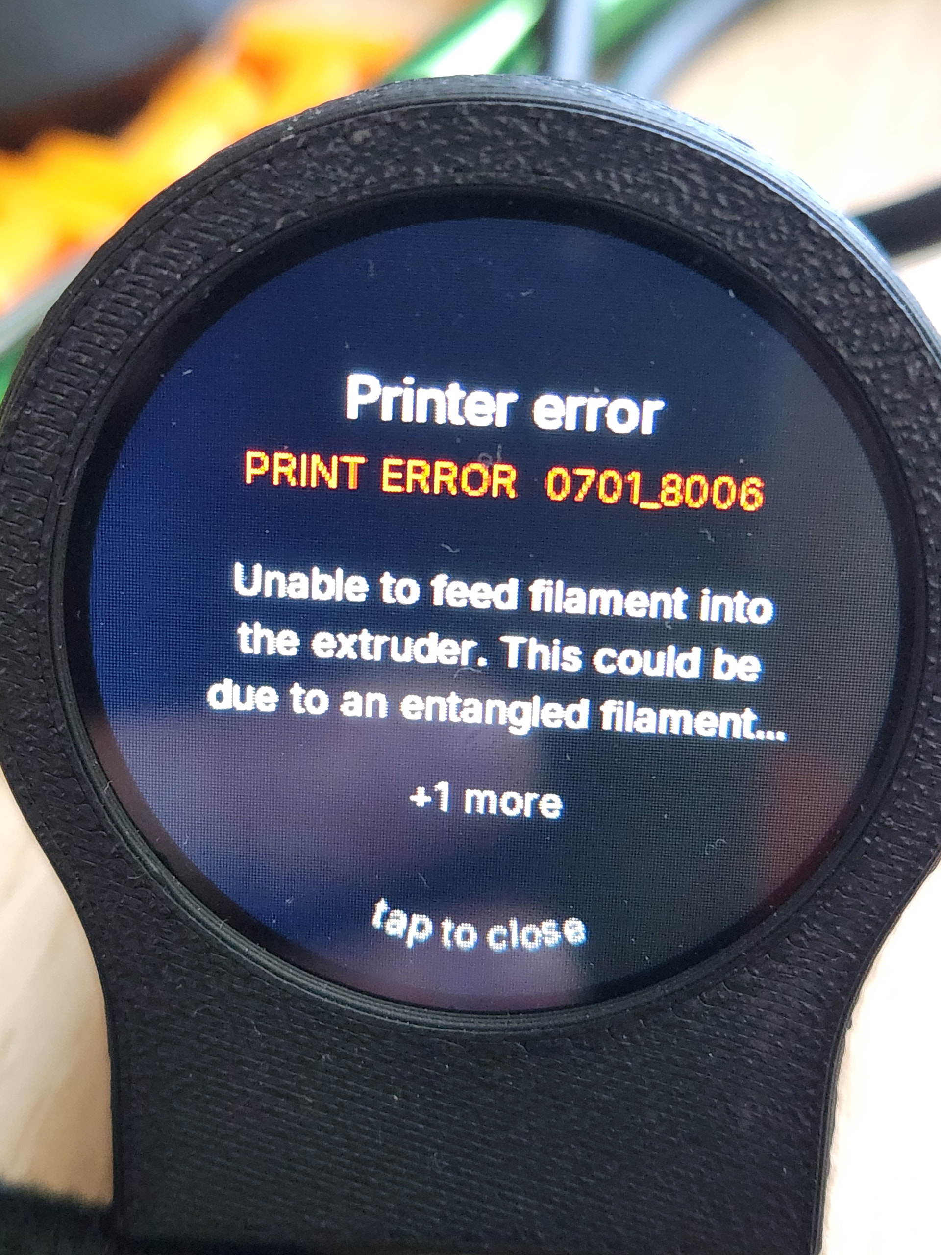

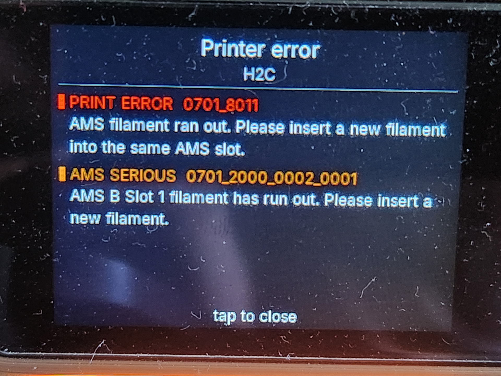

Printer errors:
BambuHelper now reads the printer’s HMS codes and print errors and shows what they actually mean: a red ERR badge coloured by severity on every screen, the decoded sentence for the fault, and a link into the Bambu wiki page for that code from the web UI.

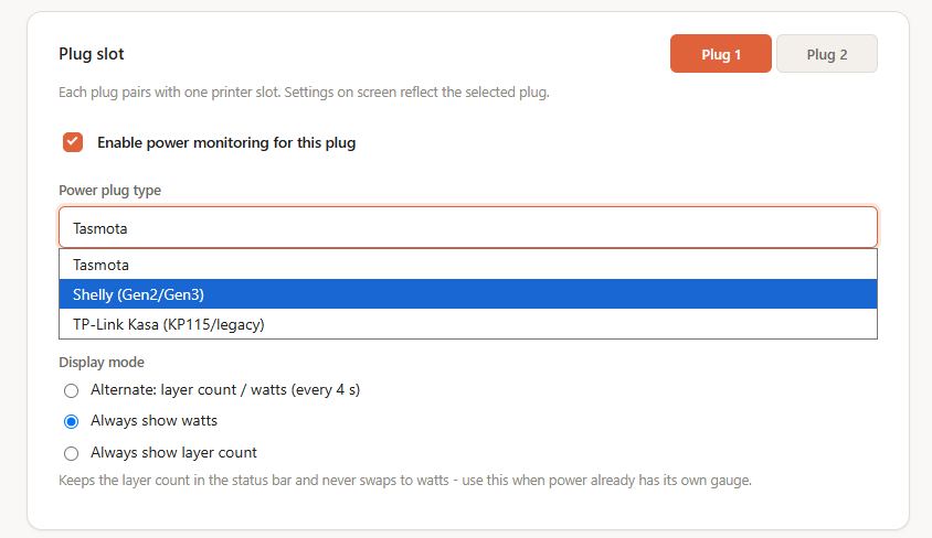

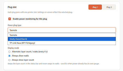

Power monitoring
Per-printer smart plug support for Tasmota, Shelly Gen2/Gen3 and TP-Link Kasa (KP115 / HS110 over local TCP). Live watts, per-print kWh, a Power gauge, on/off from the web UI or from the device itself, and optional auto-off after a print finishes.

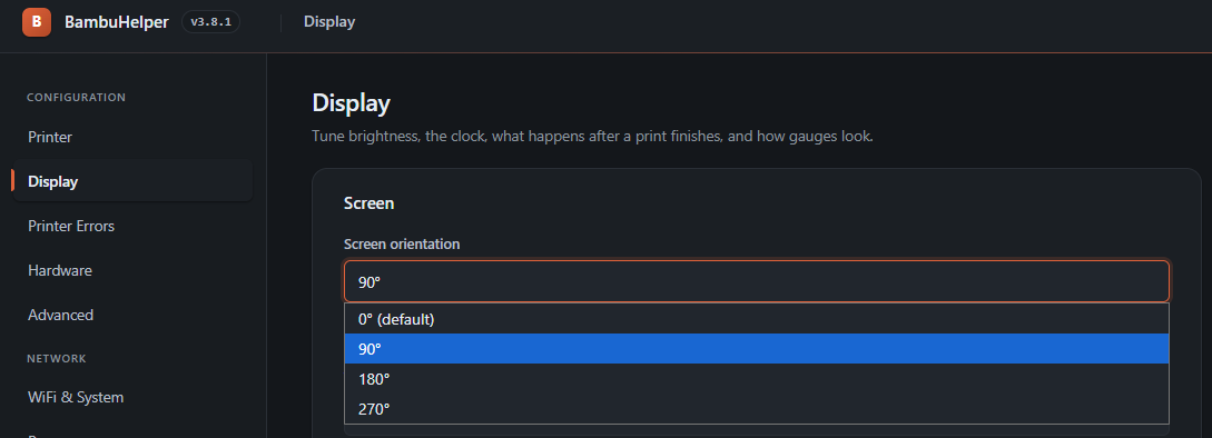

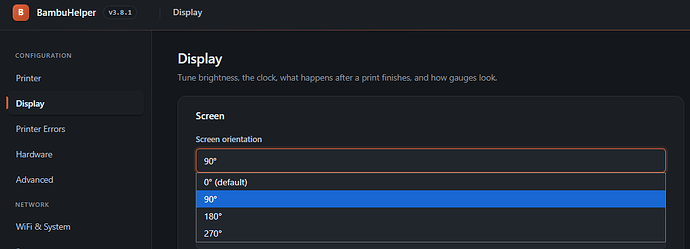

Hi, thanks for the great works. I have used " BambuHelper WebFlasher " to flash my CYD / ESP32-2432S028 board and it works..except I could not toggle it to landscape mode even I toggled “Landscape 8 gauge slots (replaces AMS sidebar with a 2x4 grid)” nothing change. How do I put it on landscape mode?? Please enlighten me.. thx
Try here please. I can see now that it might not be intuitive. I will improve it in next version.
Thanks a lot. I must have been blind that I didn’t see this setting…hahaha…thanks..Great works.
