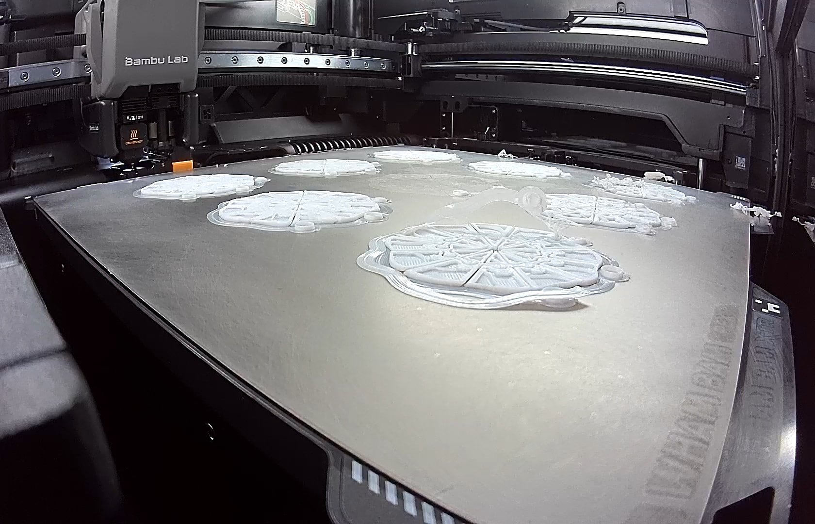

Has anyone who has come out of the gate with an H2c having issues actually corrected them. or is it you get a good one or you get a bad one. I’m now at least 40 hours into cleaning bed, running calibrations, trying test prints, replacing build plate, adding power supplies to AMS2 so I can actually use them to dry filament, drying filament, buying new filament, spend hundreds of dollars on additional supplies, new hot ends for a new printer, new build plate, every print fails to bed adhesion. Frustrating. I have more combined time in this thing than I had in my years with my Anycubic 4 max pro. It reminds me of my lottmax Shark I name Cybill. I replaced my retired X1c with this thing and regret it. I’m pretty sure the calibrations don t do anything on this printer. Almost felt promising when I gambled and picked up the Wham Bam XTR build plate, prepped according to mfg’s directions, ran the
full suite of calibrations, hours latter with calibrations that looked great. I Ran a print last night and right out of the gate print adhesion failure.

Just a quick note on the topic: “XTR Flexi Plate with No Build Surface”
These plates need very specific settings. They cannot be used with the standard settings. What bother me even more, though, is that the manufacturer doesn’t provide any information on the settings you’re supposed to use in the slicer.
Most importantly, the plates come without the film - you have to apply it yourself, which is no easy task. This introduces an extremely large number of unnecessary variables into the troubleshooting process.

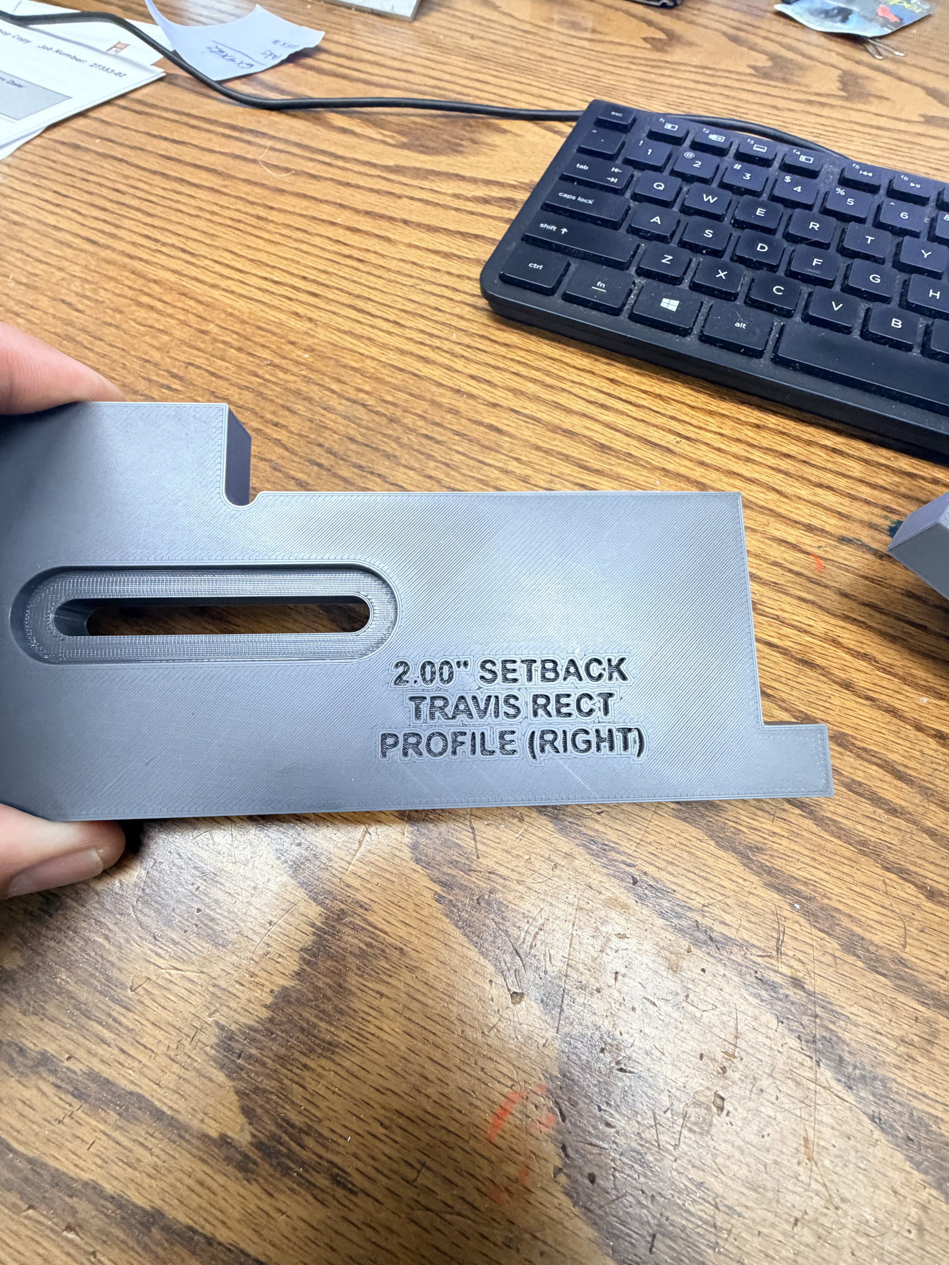

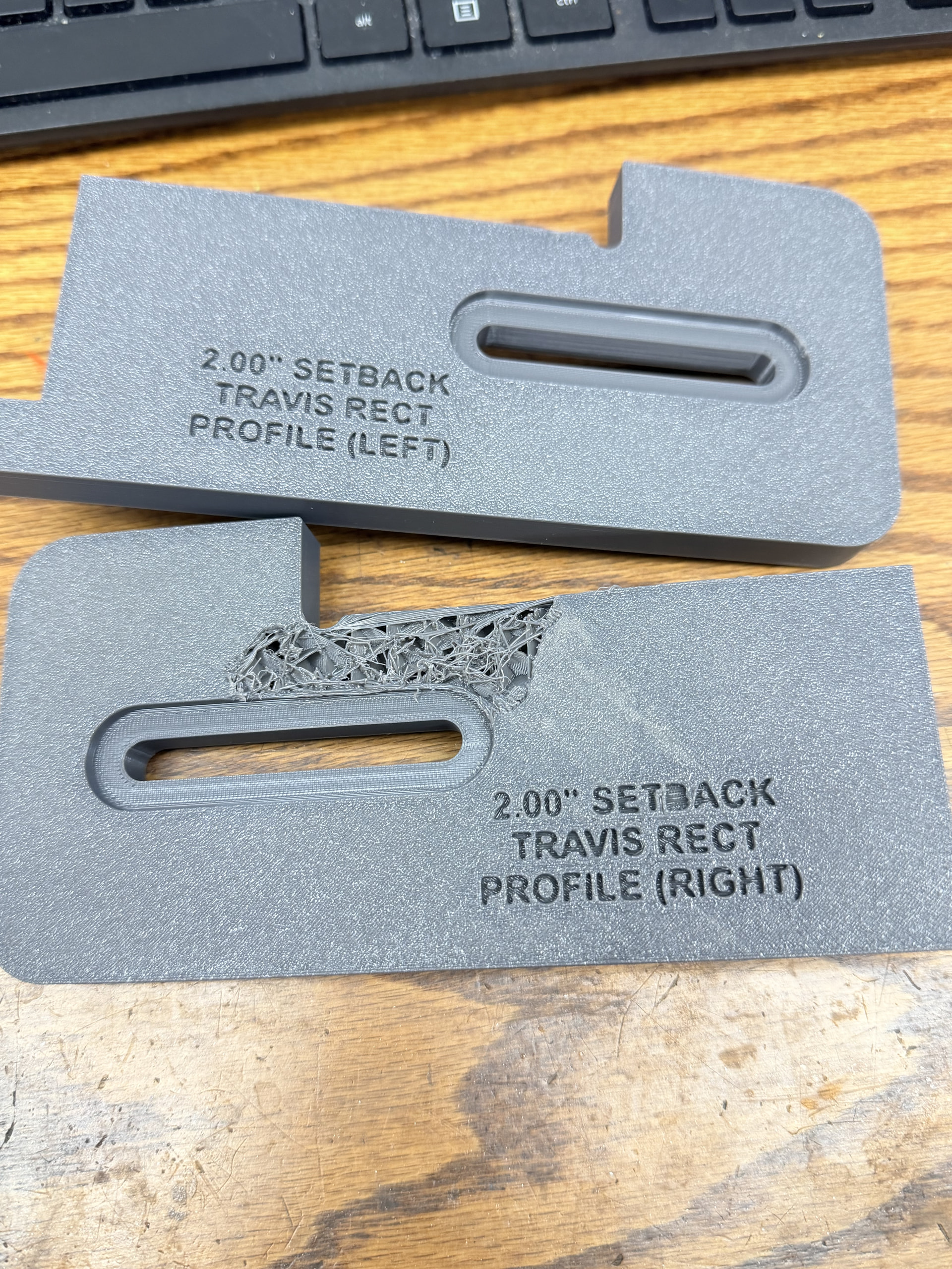

this shows how there was clear adhesion issues with this print. I cleaned the plate before hand and used liquid glue that gave me relative success with my PLA print that was contently failing. As a note i have held the belief that glue, tape, etc are not solutions but band aids. This next picture is a print of the replacement for the failed print above but printed on the wham bam XTR plate.
Material on both generic PETG grey. Settings Generic PETG in Slicer, textured PEI on failed print, Wham Bam XTR (Engineering Plate) bottom.
After the top print failed I could see a “hologram” on the plate where the filament didn’t stick. Was there still a contaminant on the plate? most likely. FWIW I have cleaned this plate several times with commercial DAWN, and 91% alcohol. This side works better than the other, as in I have actually had prints finish. I have 1 print out of dozens of attempts on the PEI Textured that was 100% successful. I have had 1 bad print so far on the Wham Bam XTR plate.
