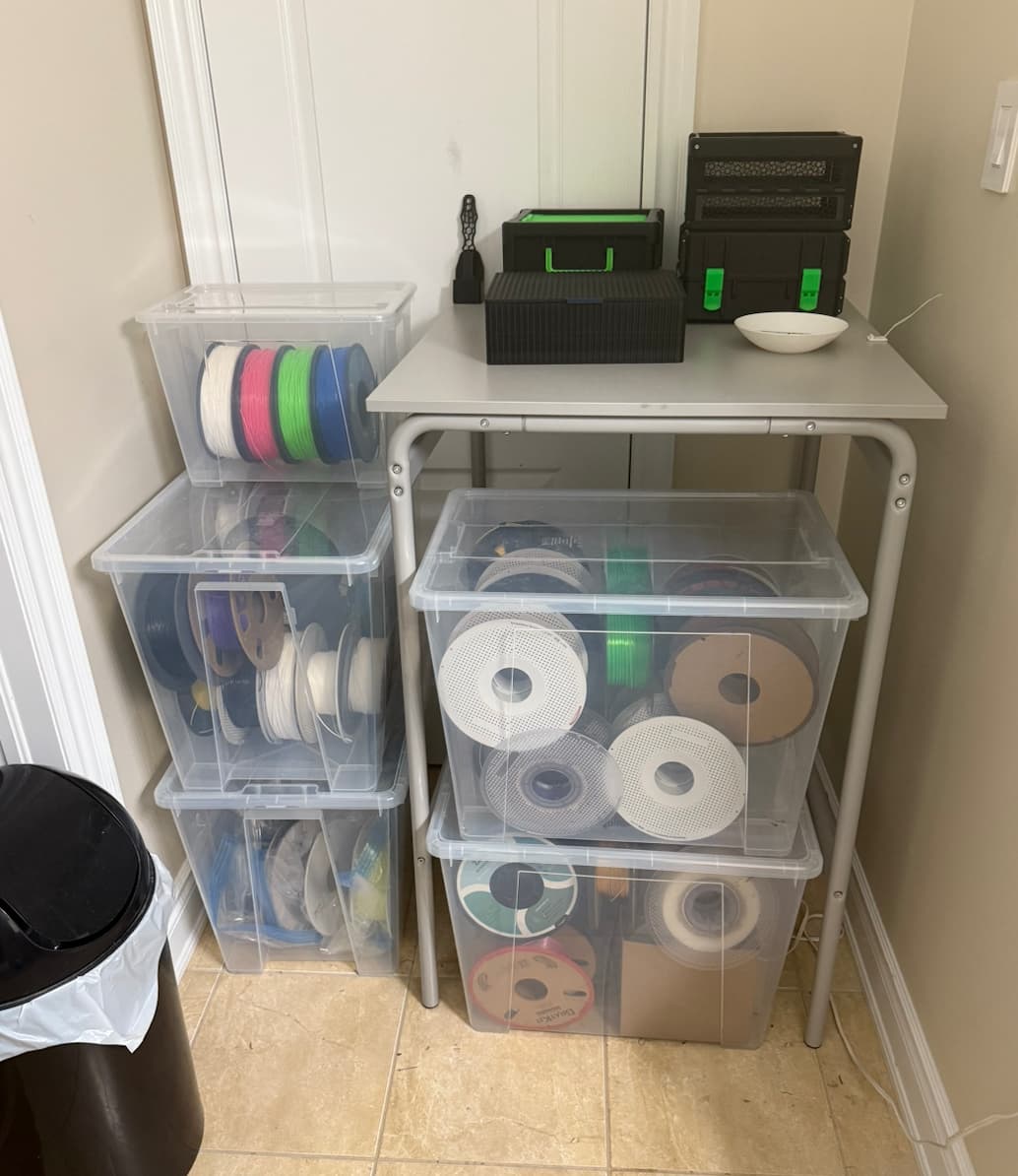

You dont have to dry it unless its wet and exhibiting some brittleness (PLA) or stringing while printing. Its much easier to store it properly, I use those big clear bin from IKEA with a box of desiccant in each one. Also it really depends on the humidity in your area. Up here in Toronto its pretty dry so even if I dont store PLA in those bins, it takes a very long time it to get wet and spoil.

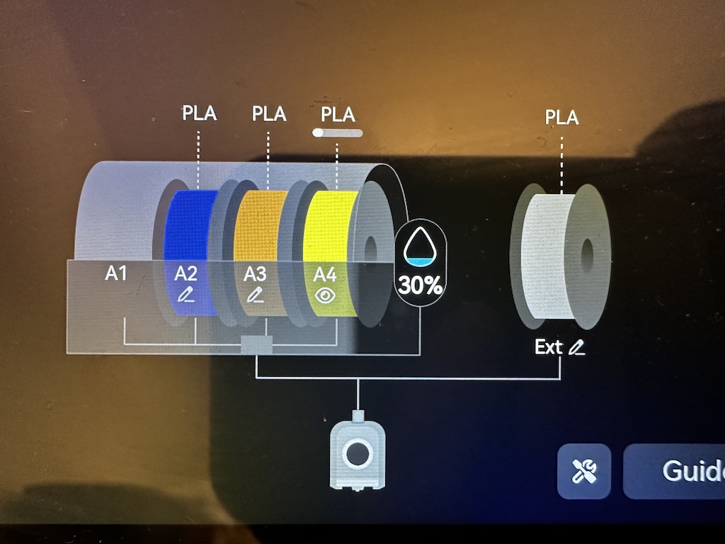

It may depend on the climate, but I haven’t had to dry any PLA or PETG. I store PLA in the open on a rack. I also have no desiccants inside the AMS which shows a 30% humidity at the moment.
