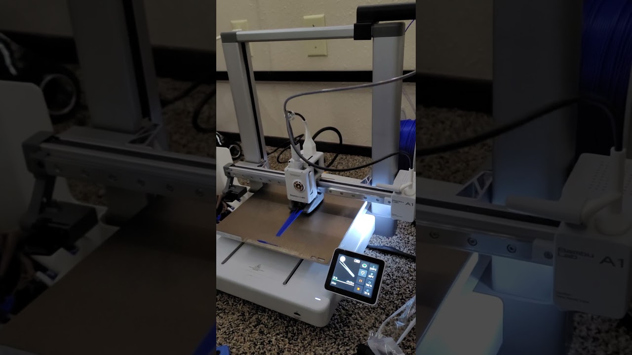

I did a Benchy on ludicrous.
I was showing off to my friend’s kid how fast even the A1 mini is.
It came out great.

Videos of this event accepted here
I will update when the print finishes, if it does.
L00l, the print did finish fine.
