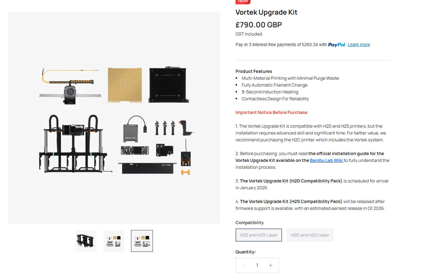

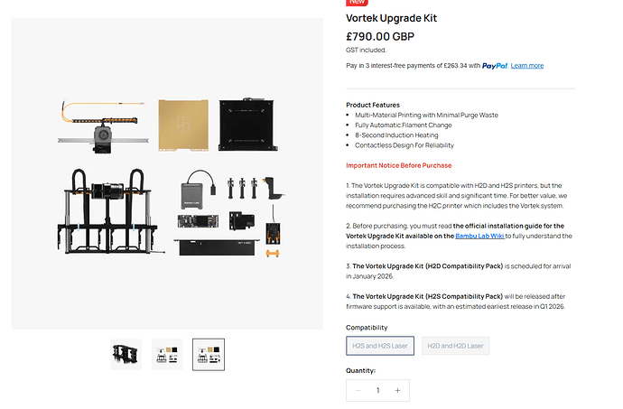

vortek price from 835-939 euro gg! https://eu.store.bambulab.com/products/vortek-upgrade-kit?id=667284624169701379
Can you give me a screenshot? Bambulab store European website isn’t working for me.

Given that I can upgrade the H2S for £790 or H2D at £702 or better if on sale at any point, which basically brings the cost in line with a new H2C, I think the H2C is out for me. Maybe an upgrade option in the future but if the speed of changing nozzles, purging and then carrying on with the print takes so long, that’s a critical issue.
