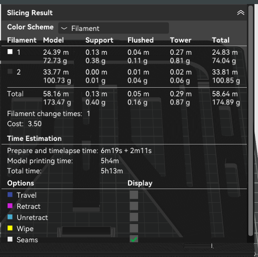

why you don’t use the infos from the slicer?
isn’t that even more accurate?
for Ex.:

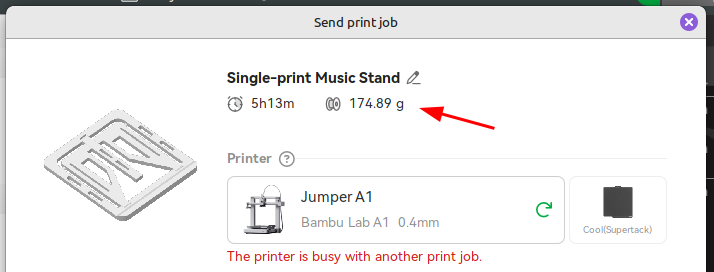

I know this thread is aged, but I found it when I was wondering the same thing myself earlier this week and I just completed a large part that switched between four colours, so I weighed the finished part and the refuse and can confirm (what is shown in the slicer view) that the entire filament usage is counted in the total, not just the part.
Thank you sir, you just saved me a whole lot of time.
Since there has been some interest shown in this thread recently, I thought I’d just share the current view as of Bambu Studio v2.1, as it is even clearer now where filament is being “used” and “wasted”, etc… and yes, the total shown in the print/send screen is the “total” still… including all flush, support and prime tower usage.
