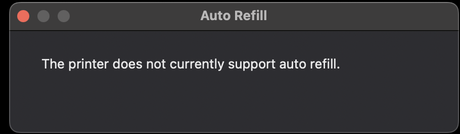

I’m getting the same message on H2S, another odd thing I see is that in Bambu Studio when I click on auto-refill I get “This printer currently does not support auto refill” is anyone else getting this?
Hello,
Yes, I’ve seen that strange message too, but don’t worry — everything still works fine. I’ve already had several automatic filament changes happen overnight, and each time, when I checked in the morning, everything had gone smoothly. By the way, if you use the Bambu Handy app to adjust your printer’s settings, you’ll see that the option is available there.
