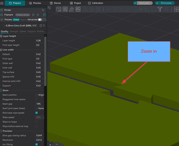

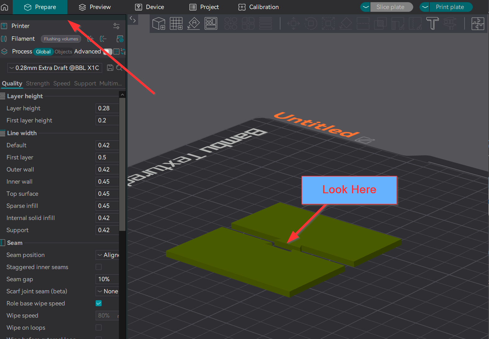

Unfortunately, it’s impossible to visualize what you’re describing without a screenshot of what you’re seeing. If you’re seeking help from this forum, you’ll get better responses by including a screenshot of the model as it appears on the build plate and another of how the slicer rendered it. This removes much of the guesswork from your question and allows community members to provide more accurate responses.
Here’s an example of what I’m referring to:
Prepare screen with the model angled to show what you are referencing on the build plate. Arrange the angle to show off the feature you are not happy with.
Zoom in if the feature is complex.
Here is the sliced view.
Or you can simply upload the 3MF file which will allow members here to inspect the model directly.
