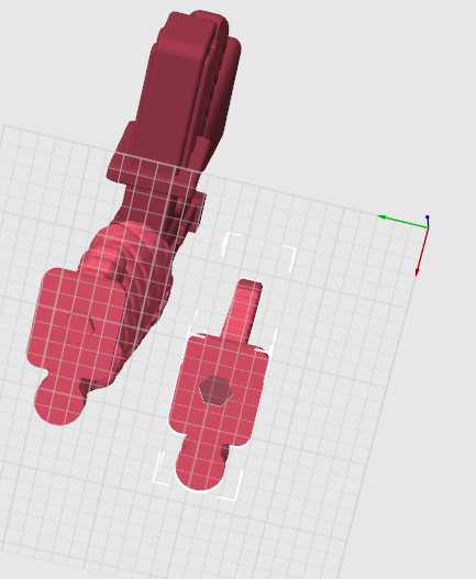

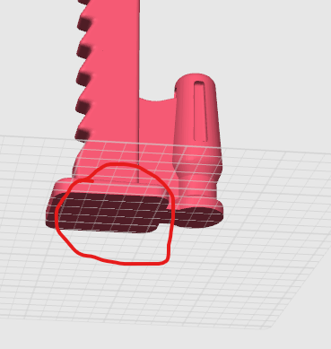

ok, looks like I got my count up ;). So the model on the left is the model on the right that I exported as an STL. During the export I received the error about negative parts not being exported due to a boolean error. Is there a resolution to this? Or is this just limitations of the slicer at this moment?

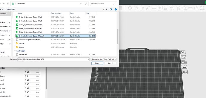

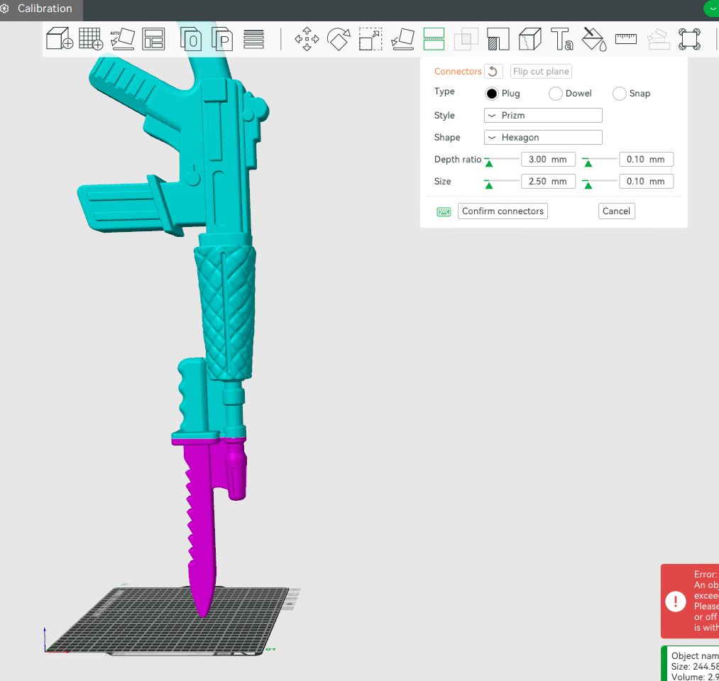

  1. I imported an STL of the file I wanted to separate

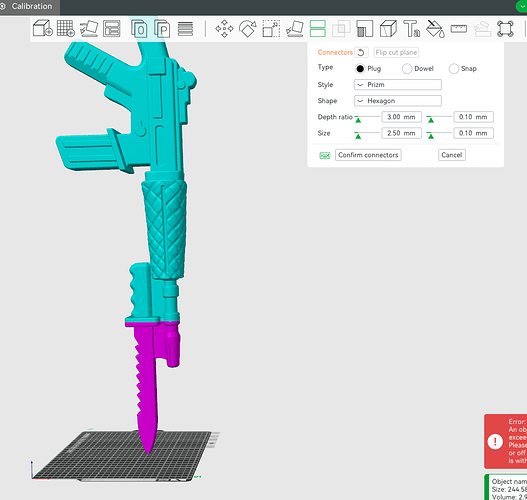

  2. following the split command instruction I moved it to the layer line I want and then click add connectors in the drop down box.

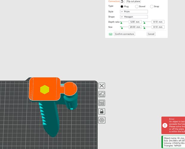

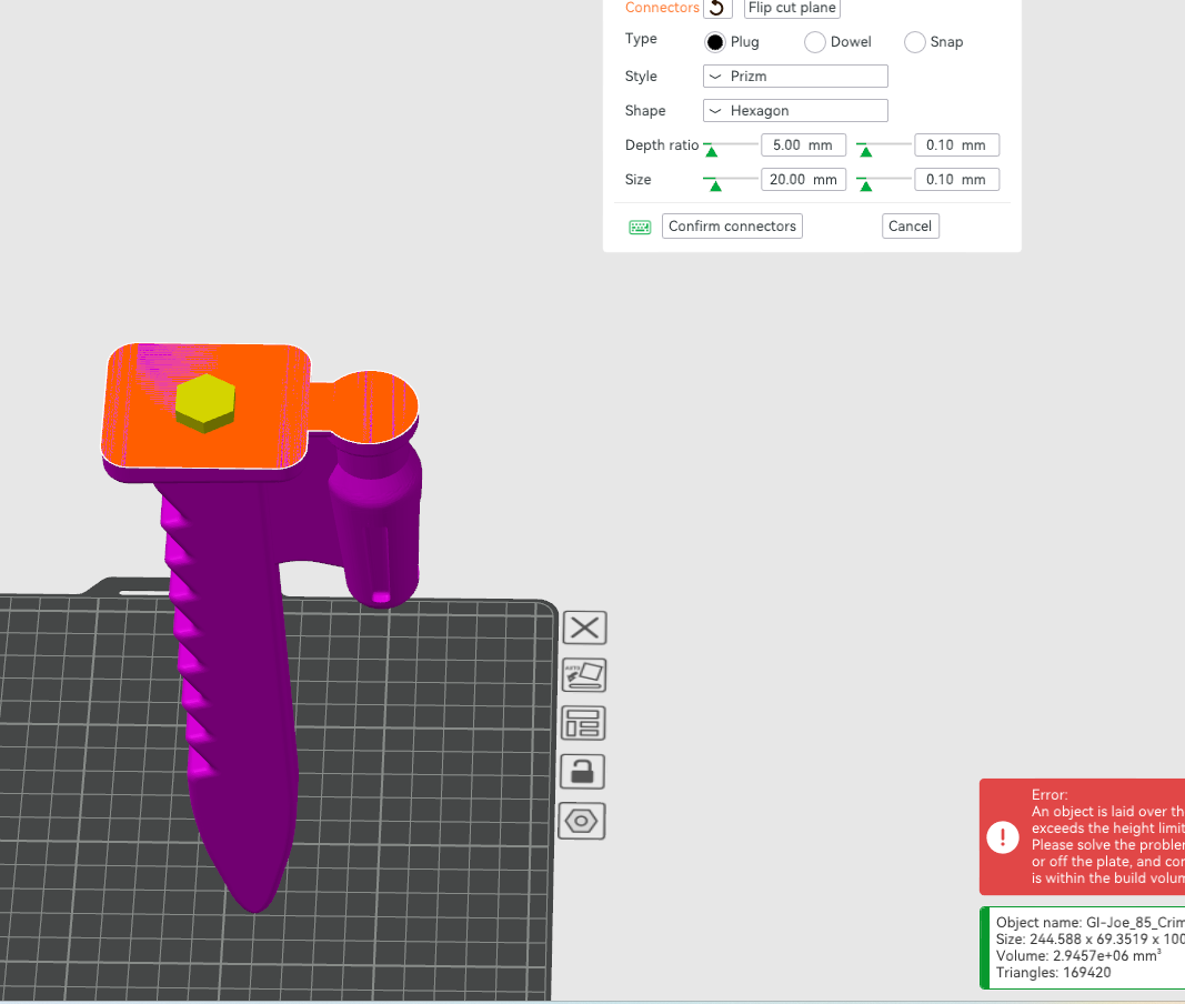

  3. I size and place the plug position
  4. I flip the cut so I get the orientation of the connection I want and then confirm the connectors

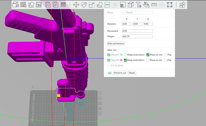

  5. I perform the cut
  6. The cut is made, and one piece has the plug and the other has the hole (which is loaded as a negative object in the slicer now)

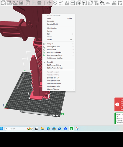

  7. I will right click on the part with the hole in it and select export as one STL

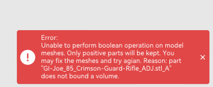

  8. If i select to mesh them before export i get the following error:
    Screenshot 2025-01-29 112725
  9. When allowing it to proceed, i will attempt to reload the STL into the slicer again and there will be no hole.
    Screenshot 2025-01-29 112846
I hope this help clear things up. I am following video guides on Youtube as well as other step by step guides on the wiki…etc. but I am still running into this and I am looking for a reason why this is happening to see if it can be fixed in the slicer or if I need to go a different route.

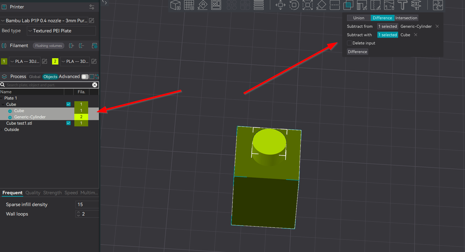

Here’s an example of what I am referring to. This is creating a plug using the cut tool. Ensure that you can get this to work first.
orca-slicer_ywRubUmLF2
Then try to create multiple scenarios using different techniques. Again, ensuring that your methodology is correct.

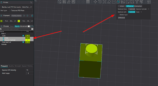

Example 1: Negative part.
Example 2: Union of two solid parts that are part of an assembly.
By creating a simplified example, you can then transfer that technique simply by substituting the models. If you can get the cube primitive to work, then you know your missing something.
Thanks for guidance. I found out the model that was given to me (STL) had hidden layers inside of it that was throwing the operation for a loop. I put the STL through a CAD program and re-exported a different STL and it looks to be operating correctly now
