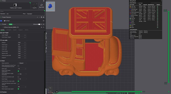

I ordered my E3D 0.4 just now and was checking Bambu Studio to see what i could expect with official support.
What i found out:
Let’s assume you’ve set speed settings that even a standard nozzle can achieve, you only switch to HF nozzle and add the higher volumtric speed.
And i am talking using 100% same printing profile for both nozzles, the print time on HF nozzle increases.
No matter the item size.
That’s not normal, the expected result would be same speed in both scenarios.
When slicing with a Hf nozzle, setting volumetric speed at 35 in the high flow tab in the filament section and 500mms on speed for instance, it will not take this in to account.
When i choose standard nozzle and try the same, then no problem at all.
it seems to me like the implementation of the hf nozzle has some flaws. so for me the solution is, to tell the printer, that it’s a standard nozzle and do my own presets and not rely on official implementation.

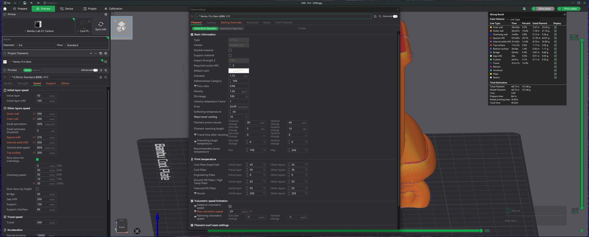

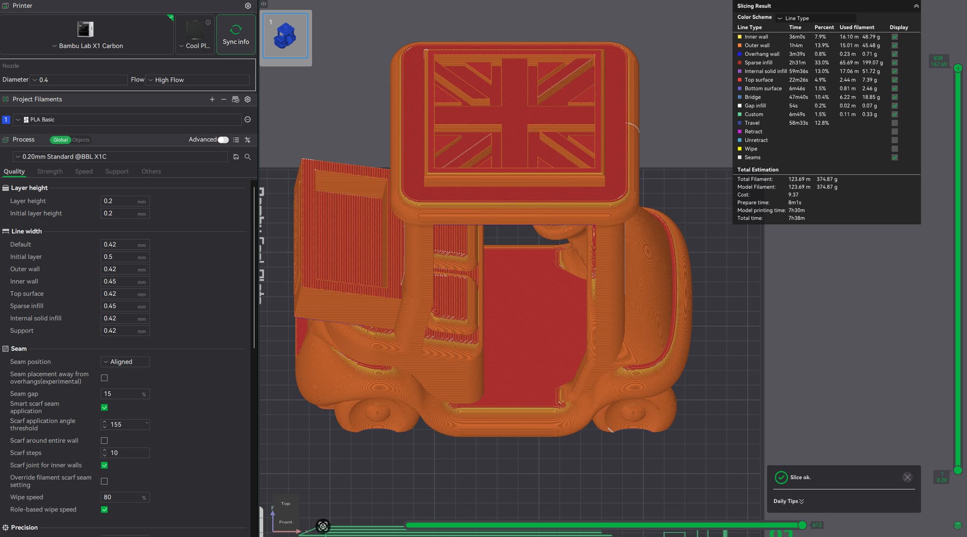

I experienced the same and looked in detail at the Slicing Result Table.
For me its the TRAVEL TIME! I have an ABS print with 3 objects and tree supports ( using support material for ABS).
Nozzle Flow setting to Standard calculates 40m33s travel time and 3h12m total print time.
Nozzle Flow setting to High Flow calculates 1h3m travel time and 3h33m print time.
So 30minutes or 30% MORE travel time when choosing High Flow as nozzle time.
I can only assume there is a bug in Bambu Slicer.
Same here on P1S and H2D … HF rate aren’t going faster… with the direct HF settings
The new way bambu represent filaments/HF variants is sometimes confusing, remember, the entire page of settings is different
Check to ensure these values are the smae between your two profiles you are comparing
And if they arent, make them the same, then reslice

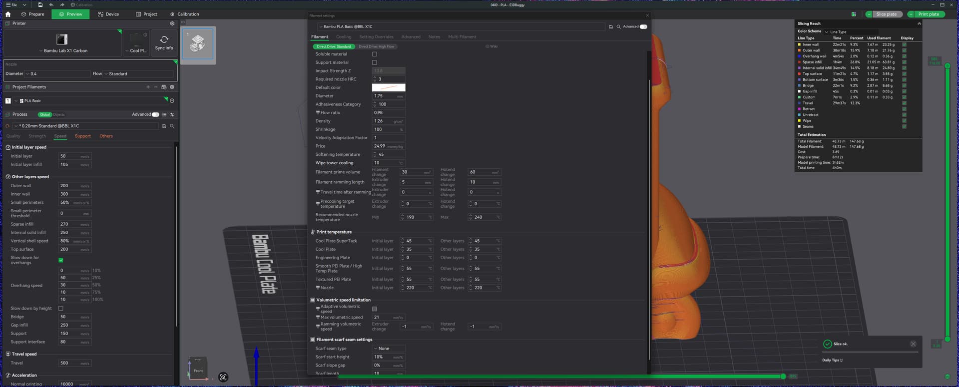

Here what i found:
They added retract and zhop on the hf nozzle profile, so that adds like 3 min in a 4h print.
The inner walls on hf with speed set to 400mm/s take longer then on the standard nozzle with 300mm/s, like 2,5min longer.
while outer walls are faster.
And 15min lost in travel time on HF that i can not find where they went.

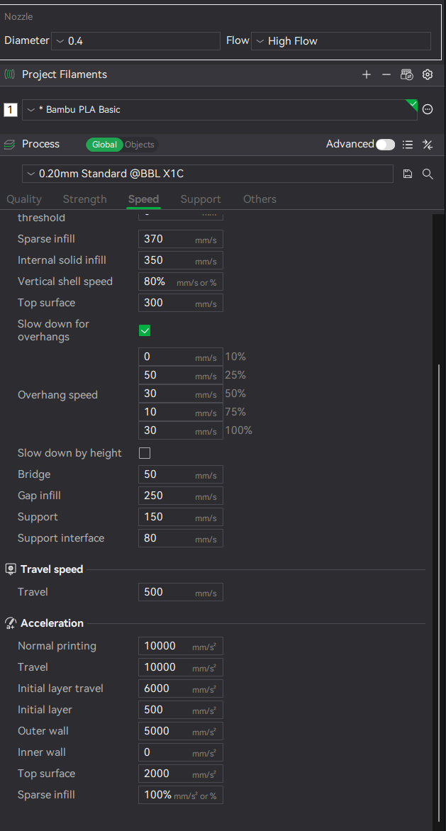

Just Note when switching to HF Nozzle, Bambu Studio increases speeds in the process tabs automatically. Nut HF nozzle is still slower than standard
HF Nozzle
Sstandard Nozzle

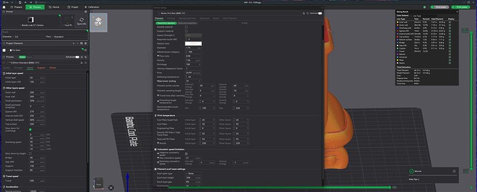

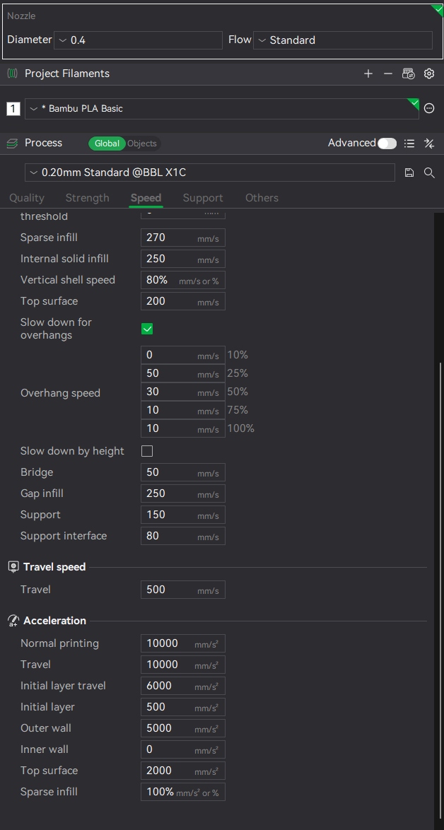

Here when i implement the exact same settings from the HF nozzle profile on the standard nozzle profile.
So that proves it HF nozzle profile isn’t correctly implementet in the slicer
Oh and before i forget, here also the stock acceleration from HF and standard nozzle, no change at all.

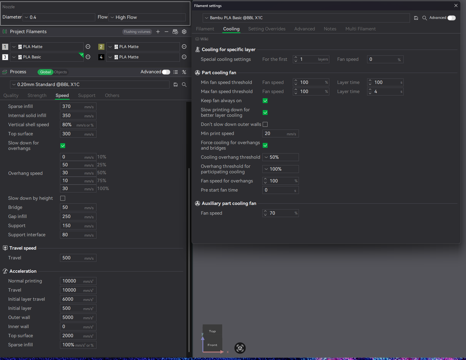

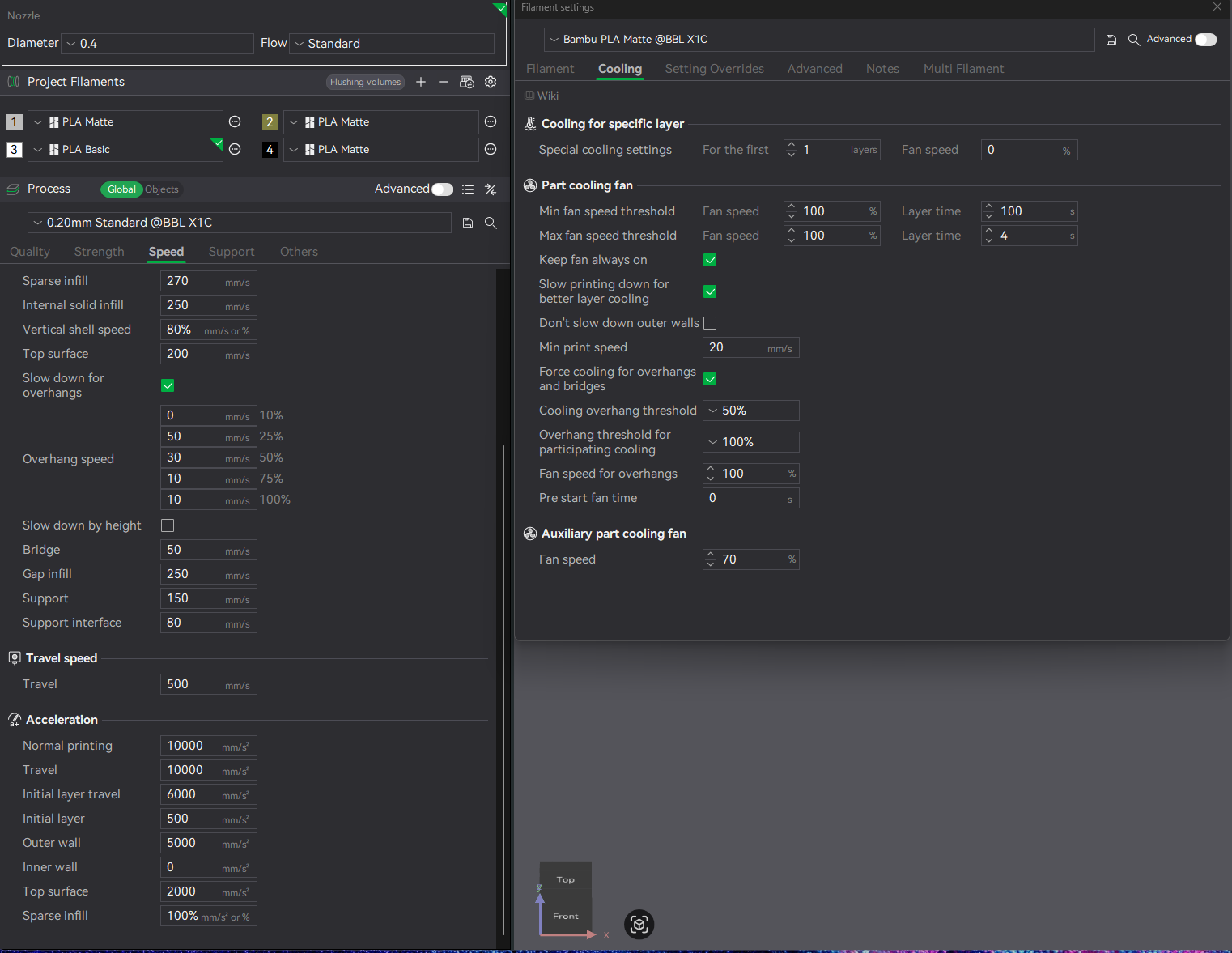

Screenshots of everything but the cooling tab! Argh! Such confidence!
First of all, you could have asked nicely for the cooling tab pictures or check them yourself, as they’re stock settings in Bambu Studio, instead of calling me out.
Doesn’t kill you to be polite.
Or in your words. Argh such confidence.
Back to topic.
I am talking about everything on stock settings in the slicer, of course i checked cooling tab an they aren’t touched by anything.
That’s why i didn’t bother posting them, but here you go:
High Flow
Standard

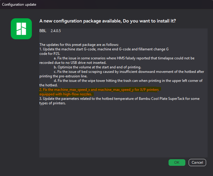

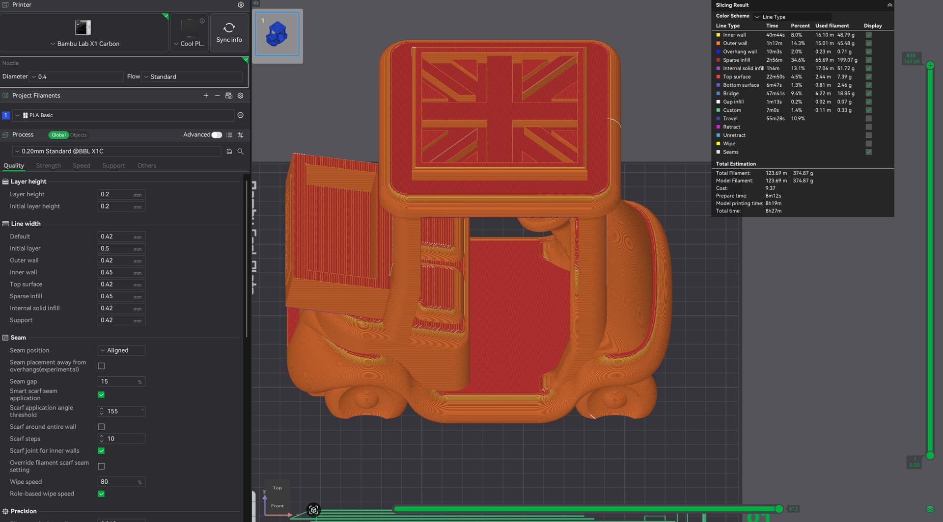

But it seems Bambu Lab noticed themselv, just got a configuration update in bambu studio which adressed this issue.
The images posted above, where taken before the update of course, but they are still the same after the update.
It specifically mentioned a fix for x/y movement when using high flow nozzles.
I did a new check with the Update applyed, i’ve increased the model size, to have a better comparision, but 1h gain when choosing the high flow nozzle now is a big gain.
I would say problem already resolved by Bambu Lab:
High Flow
Standard

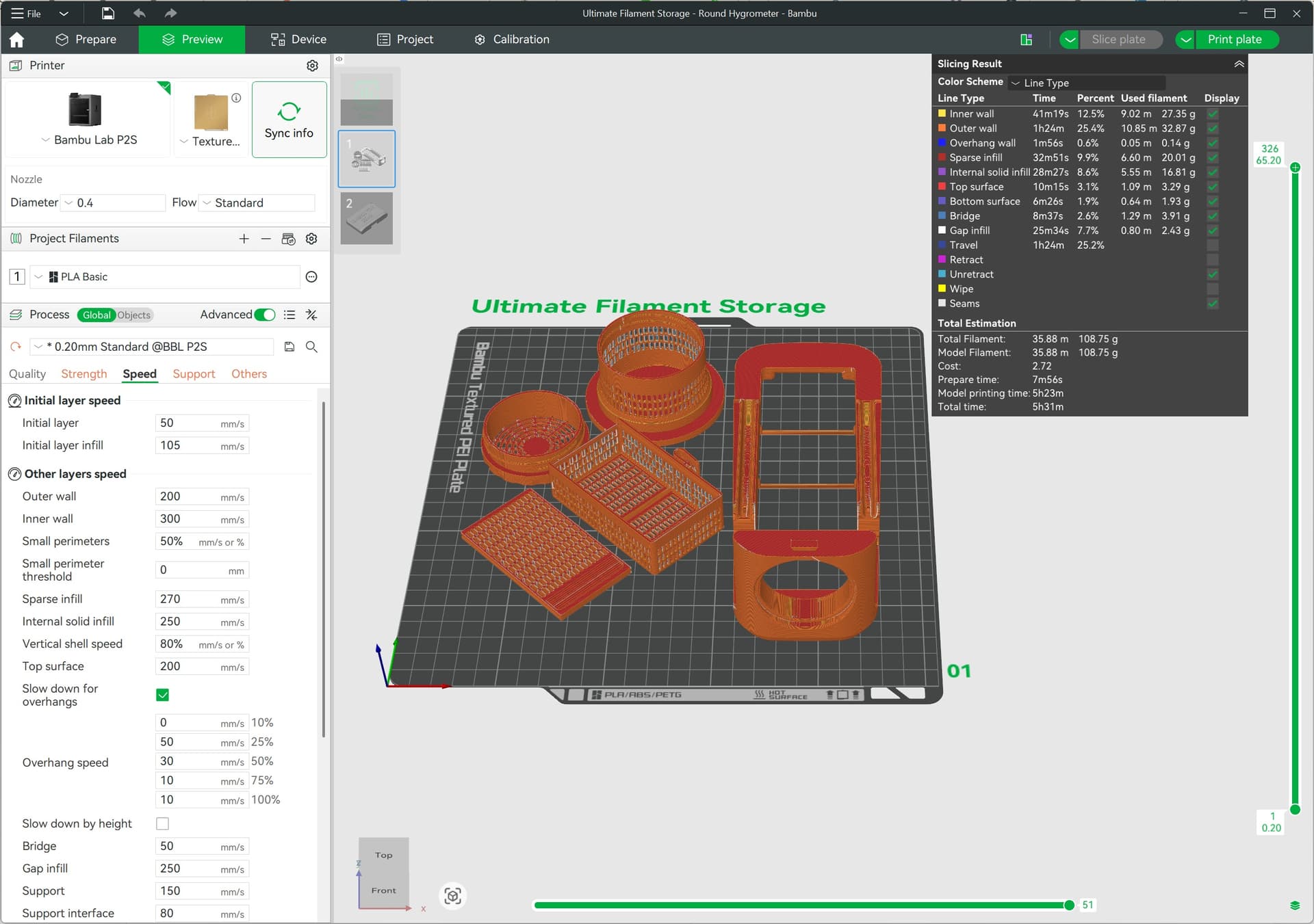

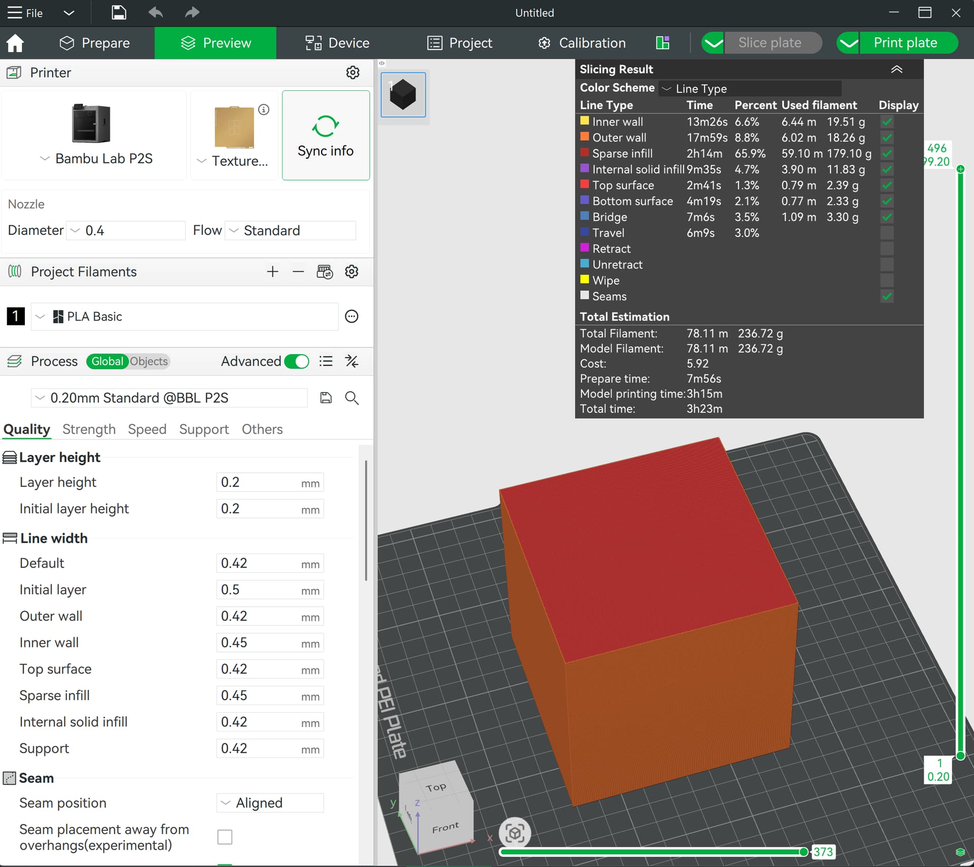

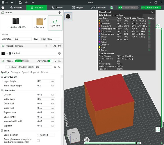

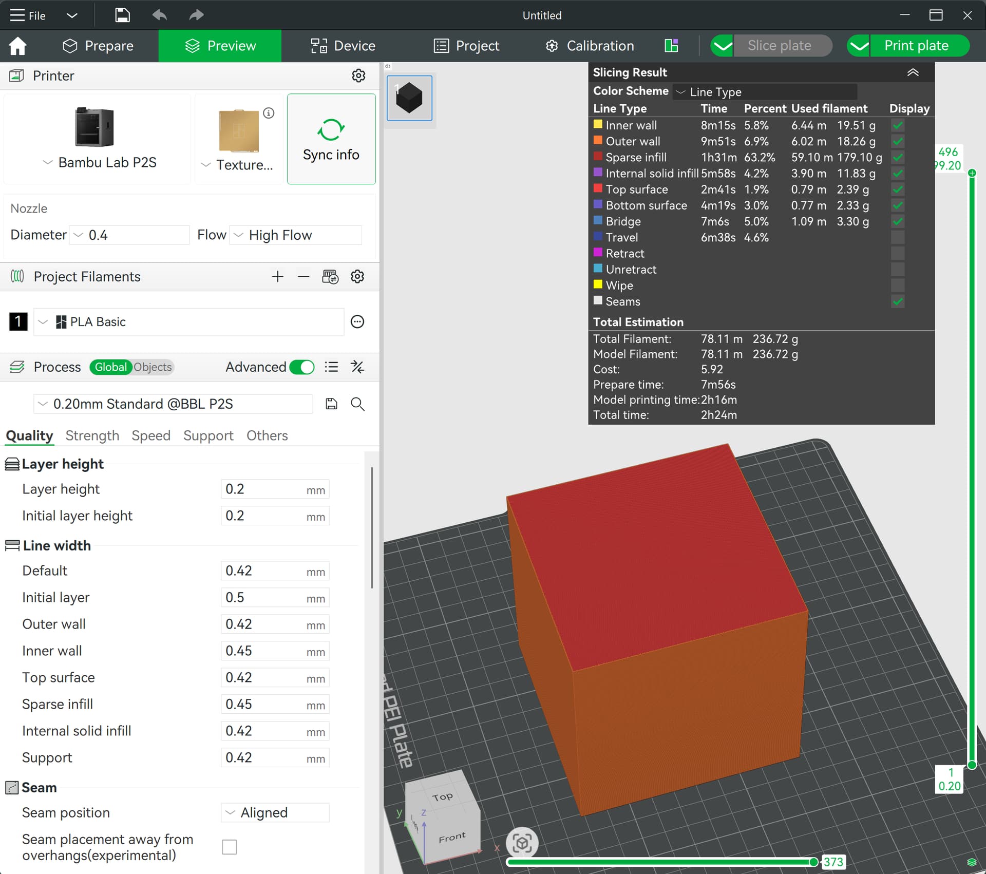

I only used the new P2S for a week. Everything works fine and happy about Hight flow speed for many prints, until today I tried to slice this, and got the same weird result: HF is slower than Standard, and noticeable longer time in “Travel Time”.
Standard Flow:
Here is the High Flow:
As you can see, the process show HF printing has higher speed in all layers, infills whatnot, but there is a significant increase in “Travel” time.
I don’t know why, but it seems this issue is not fixed yet. I’m on Bambu Studio v2.4.0.70. Anyone have any idea?
If not, it seems for some prints, I need to switch back to the standard nozzle to “save” time.

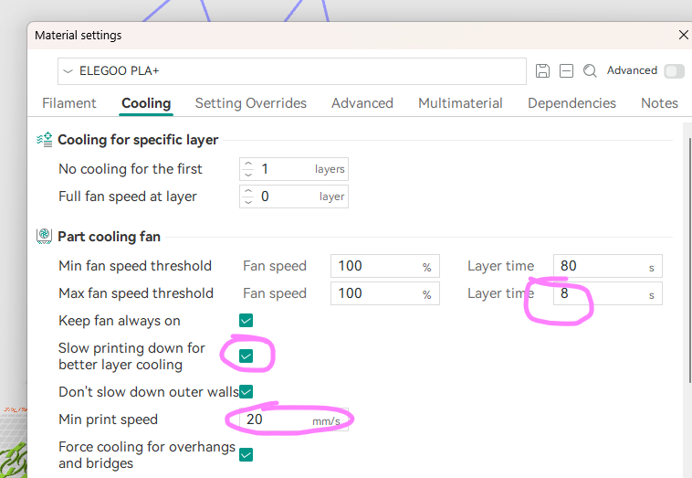

“Speed” is only the first dimension of “fast”, and only relates to straight-line motions. Not many models look like this :slight_smile:. Drag strip speed != track speed.
You must also tune the second dimension (acceleration) and third dimension (je rk/junction deviation), and also update constraints (min layer time, volumetric flow max, overhang cool slow), and also check things that add absolute time (wipe, spiral, etc). There are dozens of settings that impact your overall print time. Diff the whole setup to understand why one is different from another. My guess is since you are only toying with a nozzle, and that you have your printer set to a bonkers 600mm/s “speed”, that your nozzle’s HF and non HF variants have different minimum layer times or retraction/wipe settings.

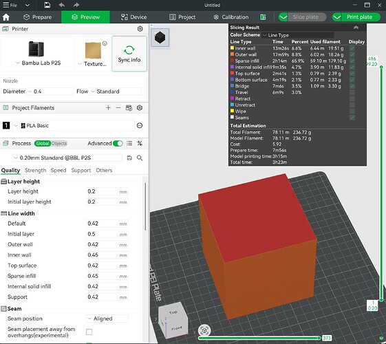

Just tested it, it works, so it must be something else.
Hight flow switched off - 3h 23m
Hight flow switched on - 2h 24m
Of course, this depends on your settings, 3D object, etc., etc., but the basic function work.
As I said, it just works for me for some model. I guess I’ll need to dive deeper to fine tune my configuration parameters.
I think I got why the slicer do that: When you increase the max volumetric print speed for a filament preset, the system only applies it for one of the nozzle(standard or high flow), which probably depends on which you you selected when you change the setting. And subsequently changing the volumetric flow rate somehow is ignored by the slicer. Anyways, the solution I found is to temporarily change the volumetric speed to 0, which slicer set to 0.5, slice it, and then change it back to the desired new volumetric rate, this seems to force the system to recognize the setting. Let me know if this works for you guys too.
