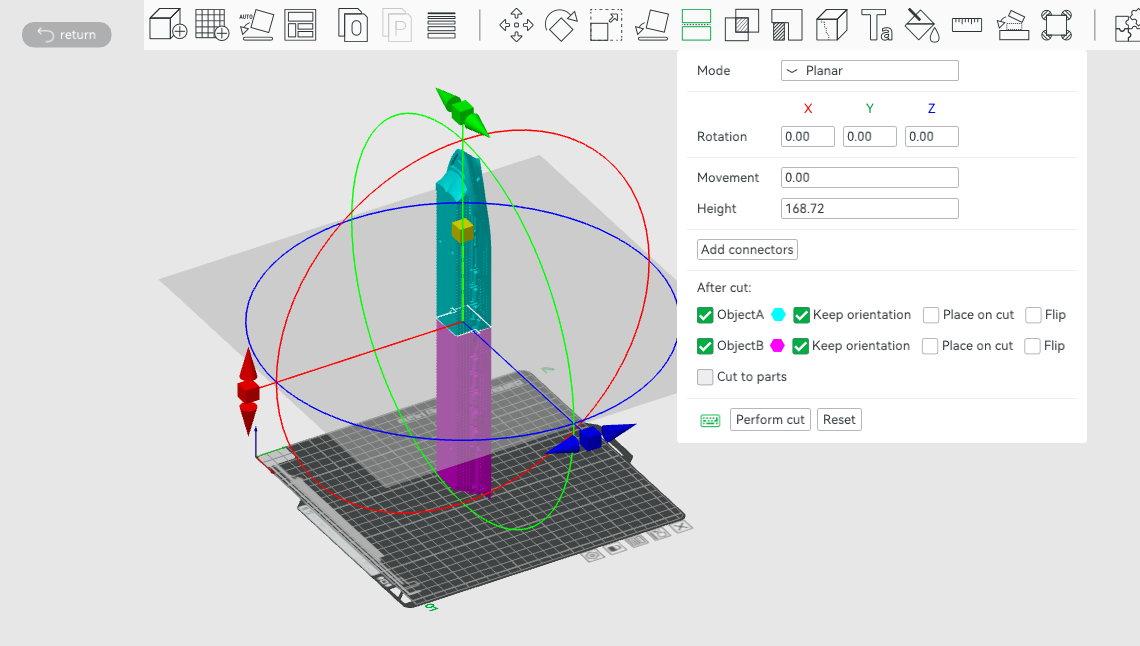

Example planar cut (with object rotated upright for easier cutting)

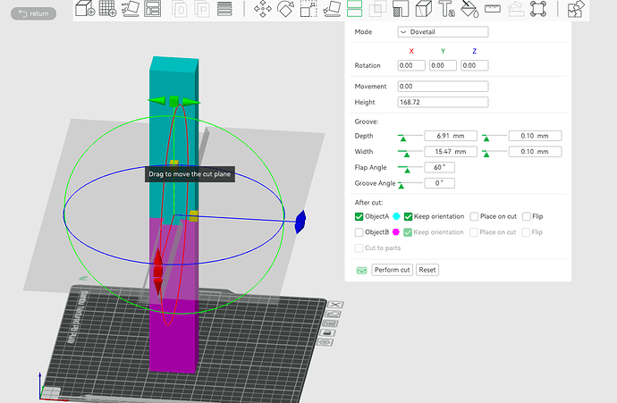

Example dovetail cut - with colour lost

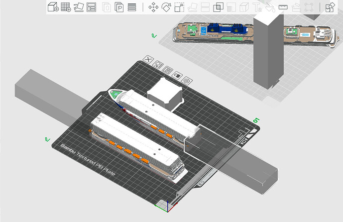

Dovetail cut of ‘cutter cube’
With negative parts applied to slightly oversized halves (object cloned and then each cloned part cut with either 20mm added or subtracted to cut point to get 40mm overlap)

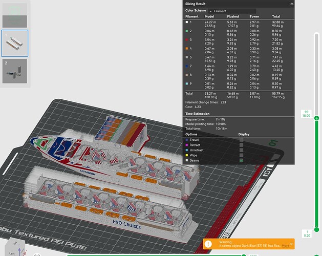

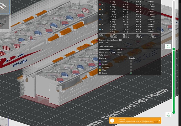

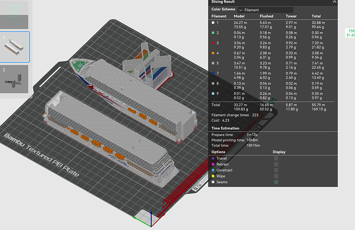

Slicing results
Closer up
