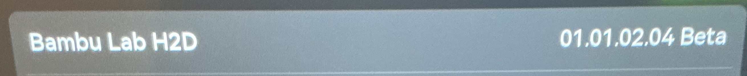

That’s the drawback of a beta firmware, when you install it you agree on a disclaimer that s… can happen. It should not be anything major, the main issues would have been checked by bambu prior to release but you’re not protected from whatever small things that was not fully tested, hence the need for beta testers.
That reported issues (if they really are reported in the proper beta firmware thread) are not handled and the firmware is released to the public as is, that’s a fault of bambu. These issues were surely overlooked and firmware was pulled.
Again, I did not check, were they reported in the right beta thread? because I’m sure support don’t check every single post in every thread.
I know that, but its not about the beta firmware here. Its about that they releases the public firmware without clarifying if that bug is still in it or not.
And lets be honest, if a reported bug that damages your printer still is in the public release thats a major flaw and will damage a lot of more printer of people that are not in beta.
Im a beta tester myself so things like this get ironed out and i know the risk that comes with it.
But when i install a public firmware that should be tested and my 2300 Euro printer just casually damages parts of its toolhead just because Bambu was lazy thats something different.
But it seems some people are cool with that happening.

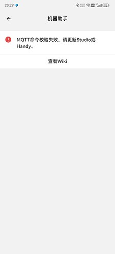

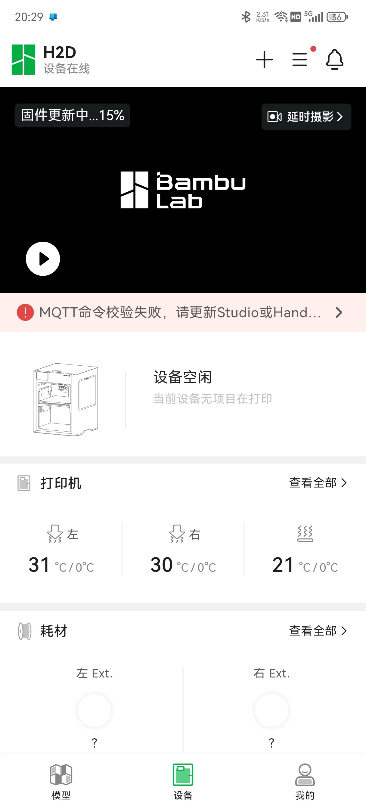

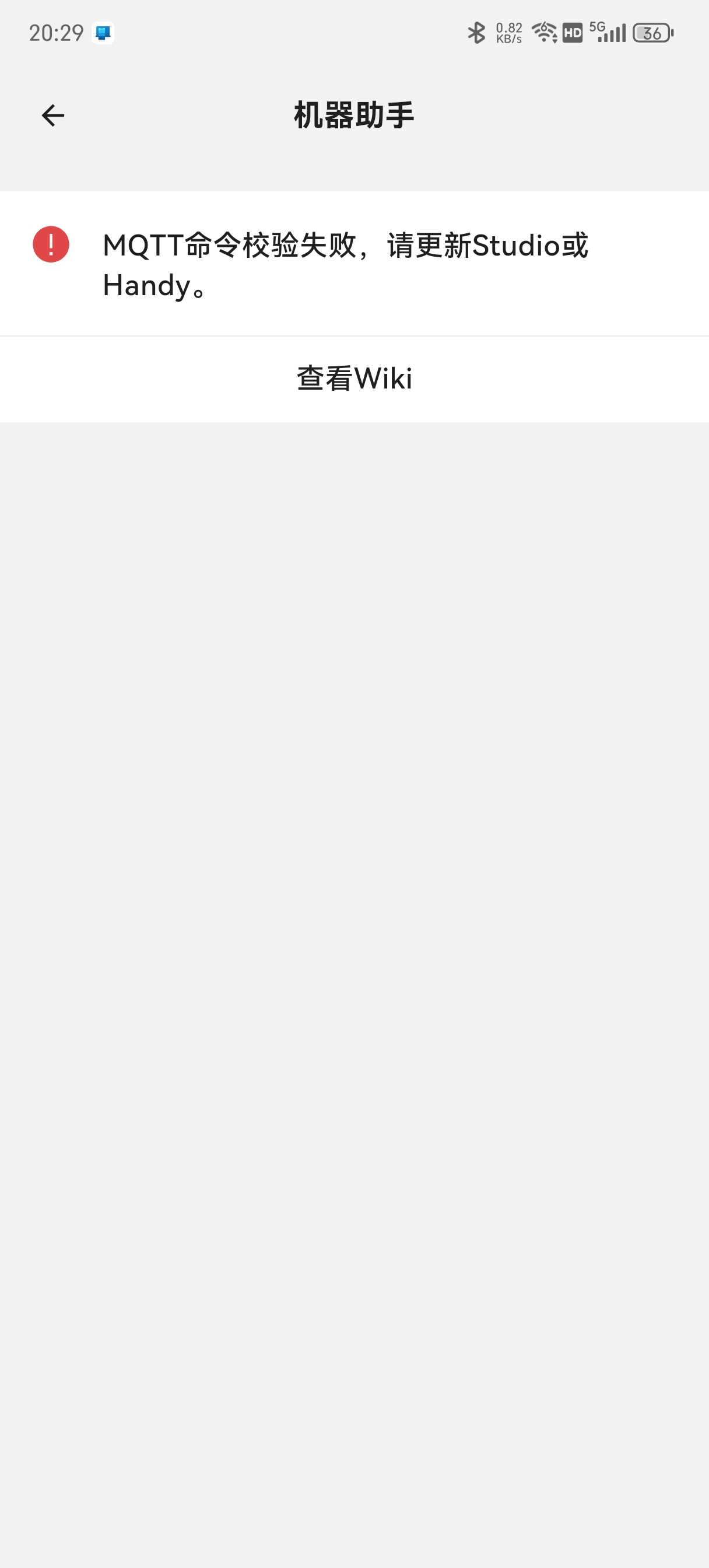

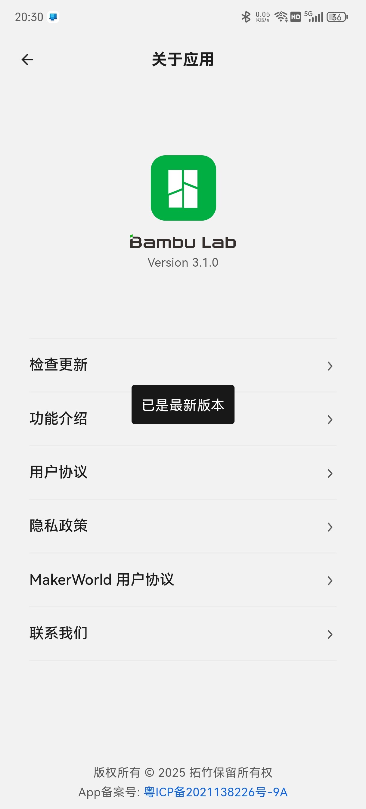

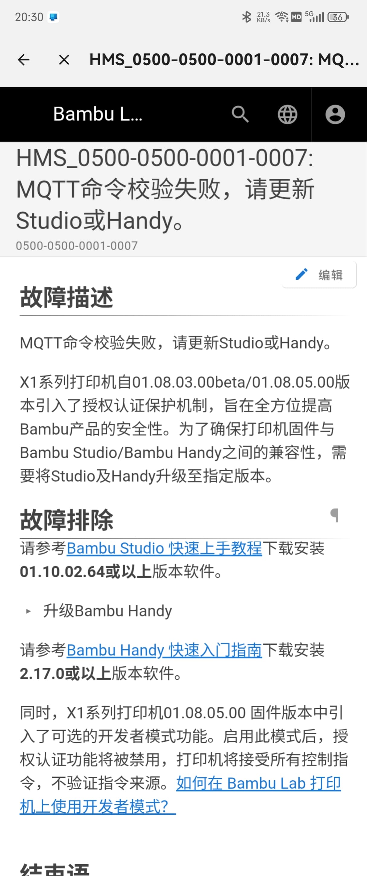

今天收到了退回上个版本固件的推送,但更新过程中出错。
好了,虽然中间报错,但是最后显示更新成功了,,,:joy::joy::joy:

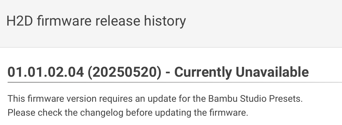

有问题的正式版固件已经被停用了,01.01.01.00 是安全的。
Don’t think 01.01.02.04 is in release yet.
It was shortly, but they withdrawn it fairly quickly after due to collisions that were reported.

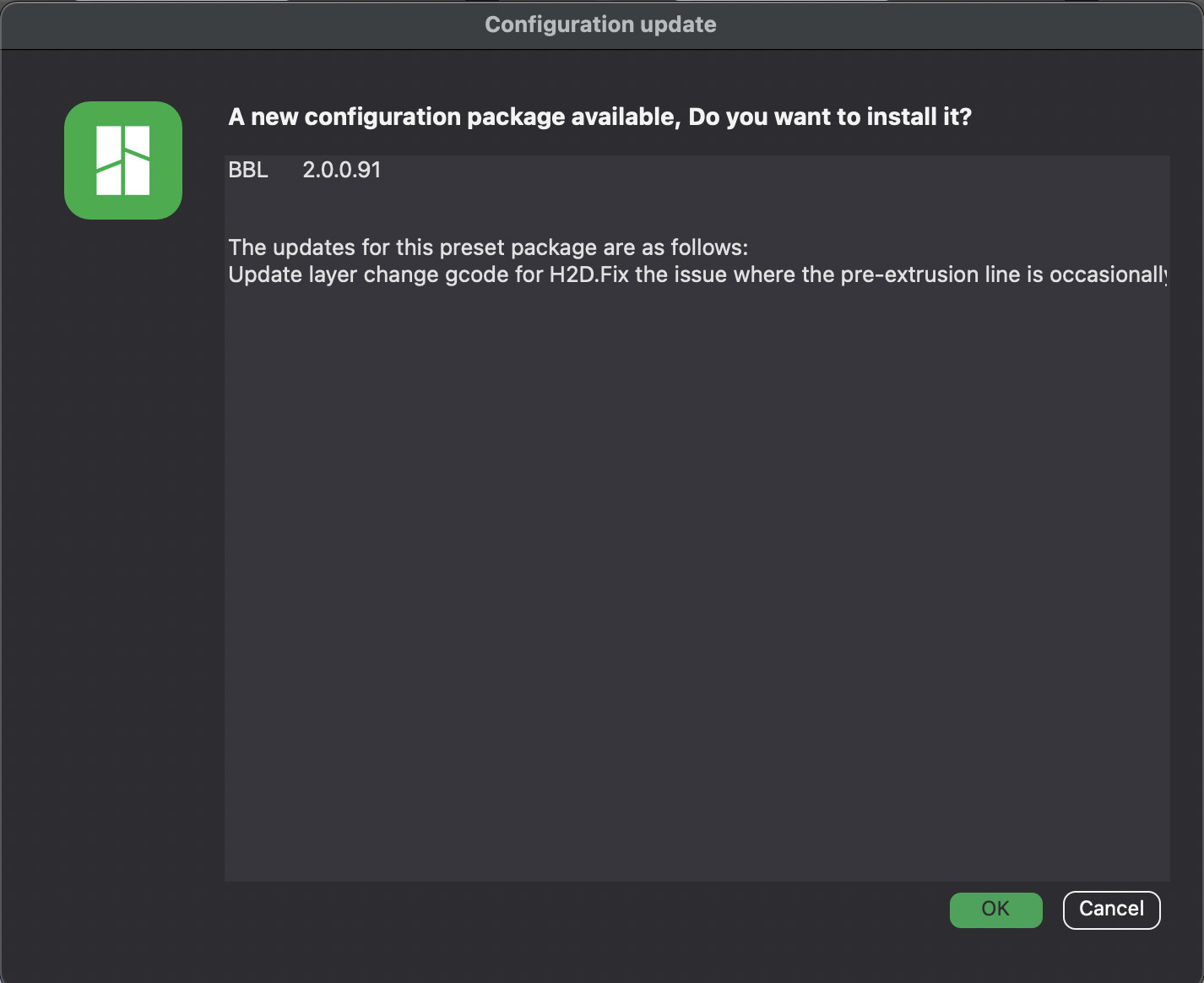

So it looks like it wasn’t a firmware issue, it was a Bambu Studio configuration issue (or at least they were able to fix it with that).
They updated the release notes too, so it’s confirmed that the firmware is/was fine, they just needed to update the presets:
I guess you pointed towards the right direction. Probably the machine gcode got updated to compensate the issue. Haven’t checked but I believe the experts living inside this forum already know :stuck_out_tongue_winking_eye:no offense
