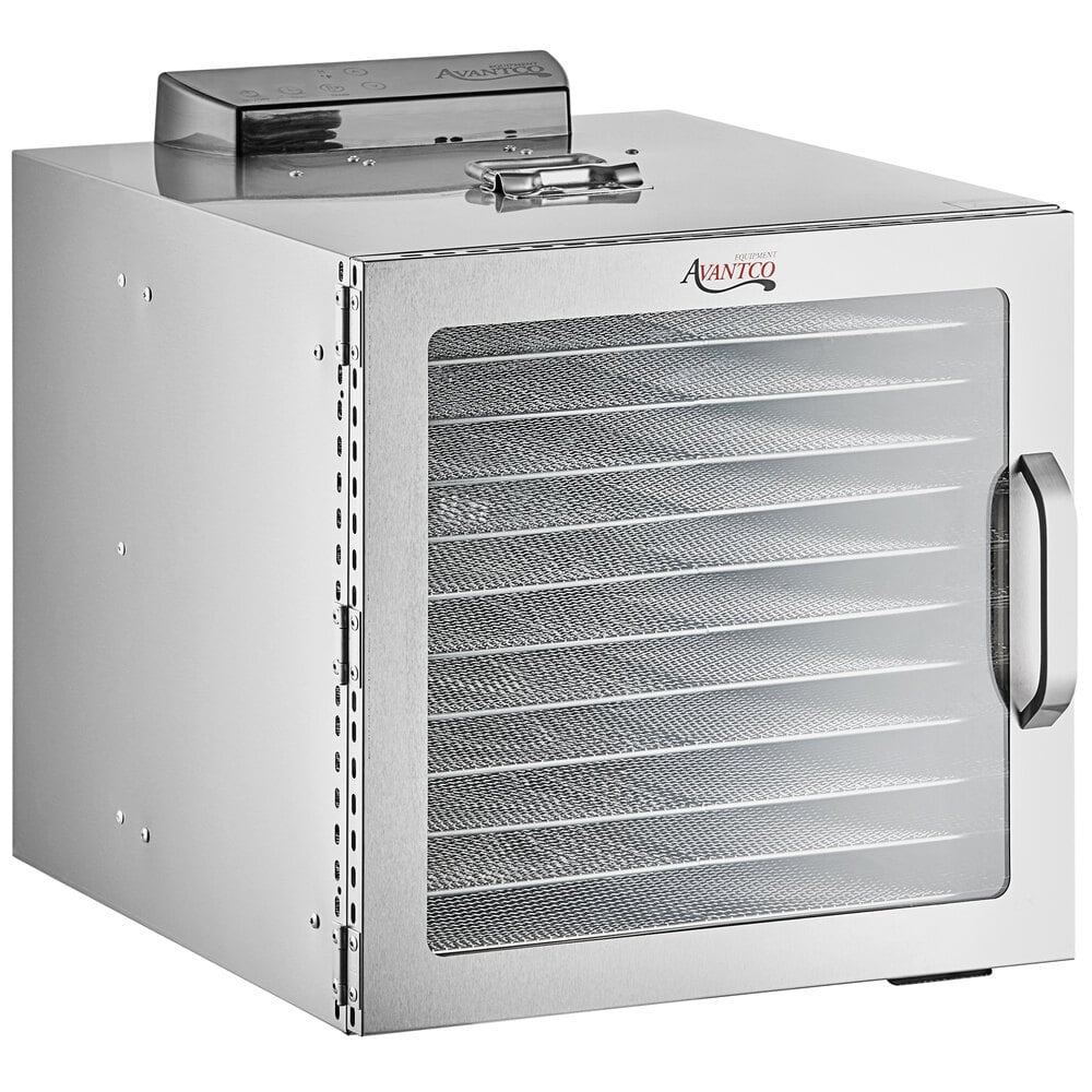

What I haven’t seen mentioned often, if at all, are the steel + glass style dehydrators that are more like low-temp. ovens. Even commercial-grade ones aren’t that expensive (< $300), and they can definitely get the temperature (typically up to 90°C, anyway).
Example Dehydrator Image
What I don’t know, and haven’t seen anyone test, is the temperature stability and hysteresis of these units (either in general or specific ones). Especially for the first, initial warm-up, which is typically where most ovens overshoot. I haven’t seen these dehydrators advertise PID control, so who knows. I just don’t want to stick my filament into something untested. And I don’t really have the equipment for proper tests.
Anyone know of any tests of this style unit? Or of anyone converting one to PID control?
I own the AMS 2 Pro, AMS HT, and now a Creality Pix4 unit. I stopped using the AMS units as dryers altogether. The Pi generally works fine, but… All these units are plastic ovens. Plastic ovens are just a bad idea (IMHO), unless you’re talking about “Easy Bake” toys (they used light bulbs for heat, anyone remember those?). Ovens should be metal and glass (or ceramic in some cases). Oh, and they should have insulation. Because you know… heat cost money. Also, keeping electronics in the same space as your heated and moist air is just… silly. [Sorry for the rant.]
So I’d really love a better solution than baking plastic inside other plastic. Ideally that doesn’t cost arms and legs. Granted at some point I guess just getting a real blast oven might be the most efficient, but I’m feeling that might be overkill for my modest needs, plus I love a “good value” as they say.

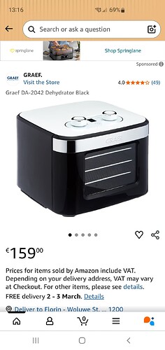

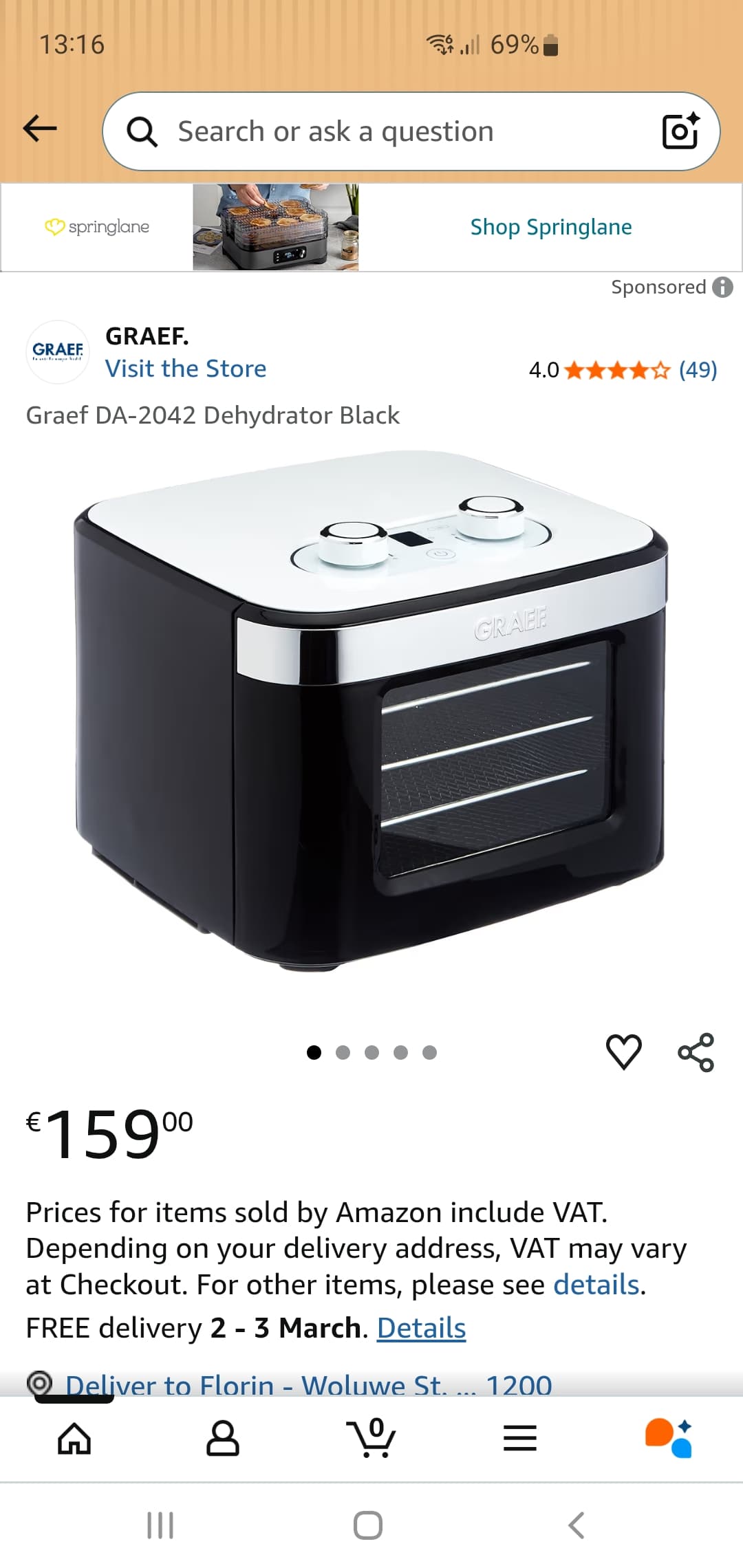

Do share where on Amazon DE have you found it for only 60€, given that what I could find is way above that price
yes, seems to be the new price in many shops. Here it is 64€ incl shipping: Graef Mini-Dörrautomat DA2042 - Temperatur 35-80 °C, 24-Stunden-Timer | Kuechenhaus24.de - Ihr Online-Shop für Küchengeräte
When i first looked for it, it was 59€ everywhere, including Amazon. It looks like it is discontinued, it also doesn’t appear on the Graef Homepage anymore.
It doesn’t appear to be discontinued on Amazon DE, as you can see in my previous post. However, the price has exploded to almost 3 times the one you’ve quoted. That’s not at all very encouraging, from where I stand. The link you’ve shared does indeed list the price you’ve mentioned, and adding the shipping costs to outside DE on top, does appear to be a reasonable price. Under consideration. Danke.
