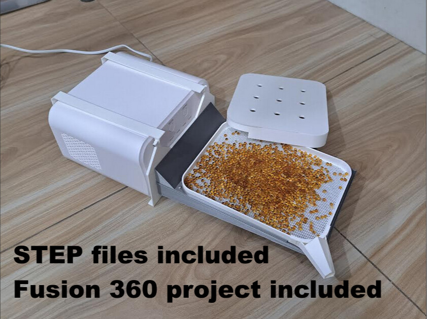

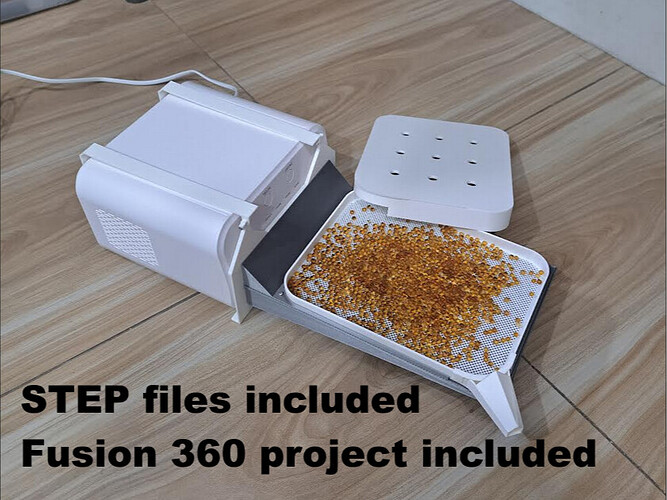

==> Desiccant drying with a cheap shoe dryer
Got tired of drying desiccant in filament dryer, made these PD USB Rechargeable Desiccant AMS / Spool Dry Pods - print 4 for the spools and 3 for the AMS. Remove and plug in to recharge.
