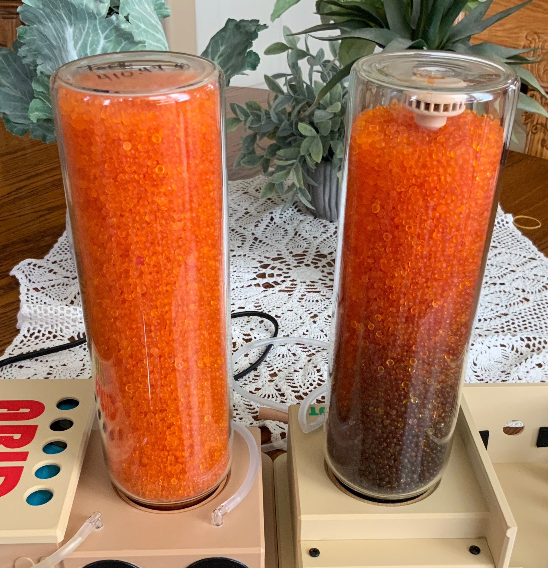

I believe you probably can rely on the color change. My dry air column is starting to be used up and the color change has a very visible gradient. Photos don’t give you the same view an eye has, though. Only thing is you’d probably need a color reference card since it’s not very strong at low humidity. The best way would be to use a little solid state spectrometer and look at the two colors directly and quantify them if you need accurate numbers. It would be much more sensitive and accurate than by eye.
It’s still putting out air that pegs the outlet hygrometer at 10% but by watching it, the color change started hitting the top of the column at least 3-4 spools ago. It’s easier to tell by comparing to fresh/dry beads. There the darkening at the very top starts getting more noticeable.
This is back with a used column and brand new dry beads and you can see the difference. The right column was still putting out air less than 10% humidity but you can see it’s a little darker at the top (exit) end.

Yes, that’s an exemplary photo: I can see the color differences at the top between the two columns, just as you mentioned. And therein lay the rub: when I pull a tray of drying silica gel out of the blast oven, if it’s green then it’s obviously too wet, but if it’s orange, it’s not obvious just how brightly orange it is. As you suggest, a reference card would help. I don’t really trust my eyes to decide though, but it would probably help. Maybe a color meter.
