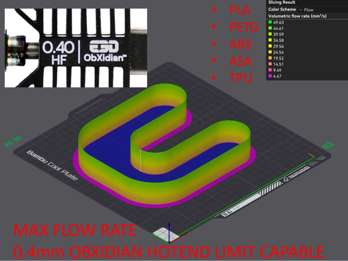

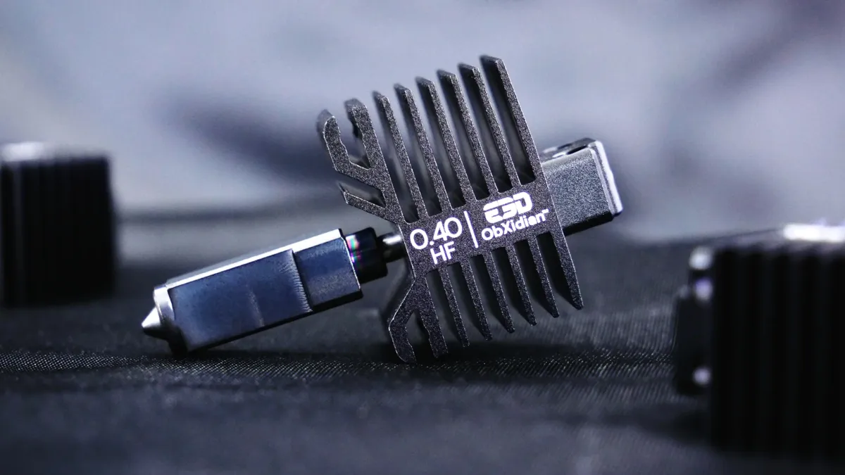

I’m not an expert, but was very impressed by the idea of getting a 50% increase in print speed. But I can’t seem to get any info on supported config files, or really have any increase in speed. Has anyone cracked it and feel like sharing? Thanks, Morgan.
I’m not sure exactly what the question is, but if you want to go full speed, you’ll need two things:

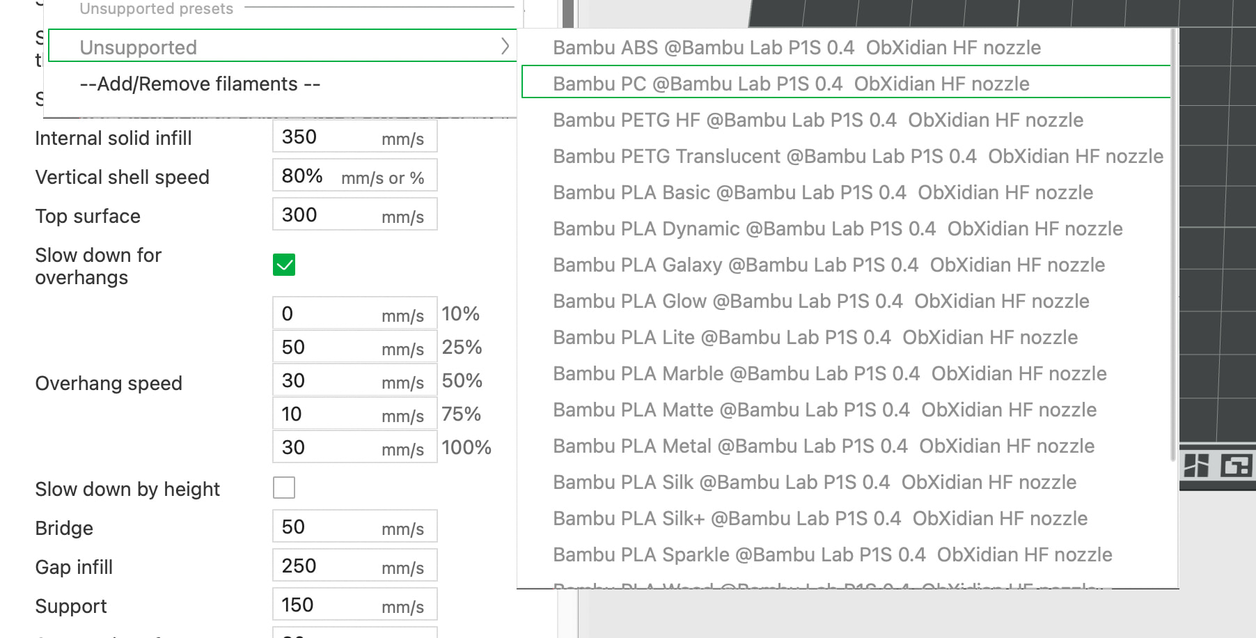

First: An HF filament along with the appropriate filament profile; otherwise, an HF nozzle won’t provide any benefit.

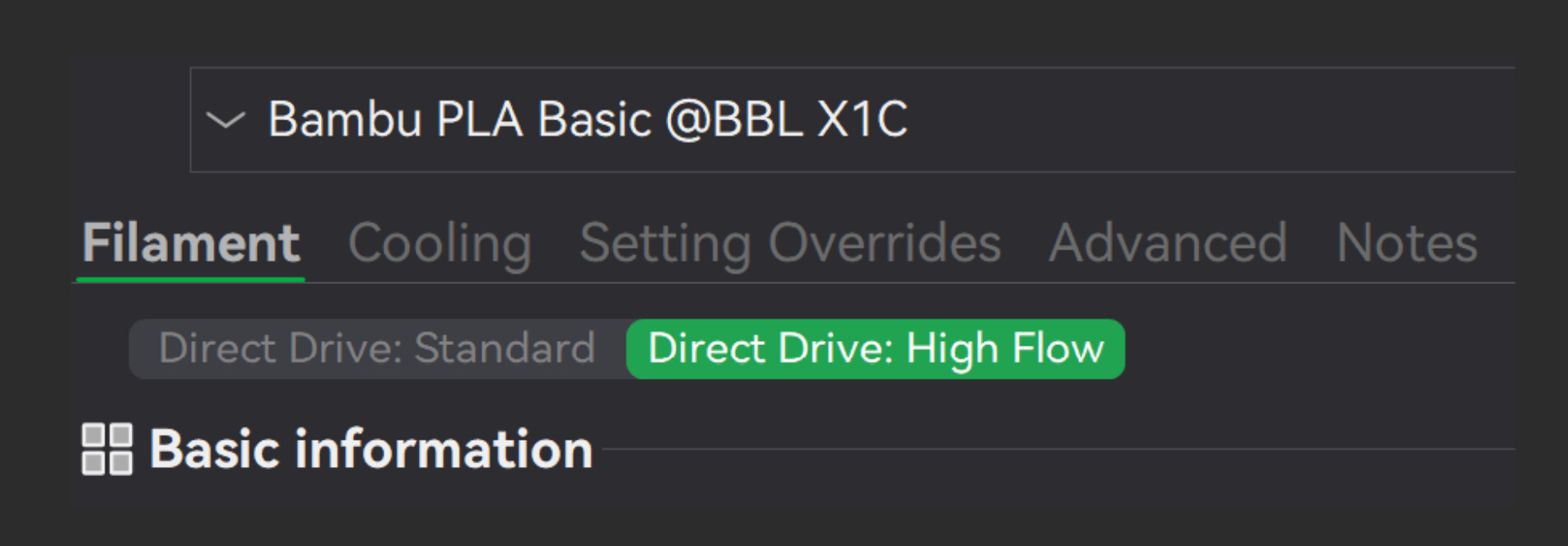

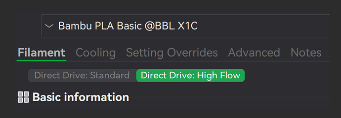

Second: Set the nozzle to HF and switch to: Direct Drive: High Flow
If no time savings are shown, it may be because the direct drive was not switched to High Flow, or because the correct filament and profile are not being used. Of course, the object to be printed also affects how much time you save, or not.
Note: Just because “HF” is printed on the filament spool doesn’t mean that all of them support the same speed; there are differences depending on the manufacturer.
And, of course, the printer itself has to be able to keep up with those speeds. You have a P1S, so it’s possible - though I’m not 100% sure - that it can’t reach the speeds of current-generation printers.

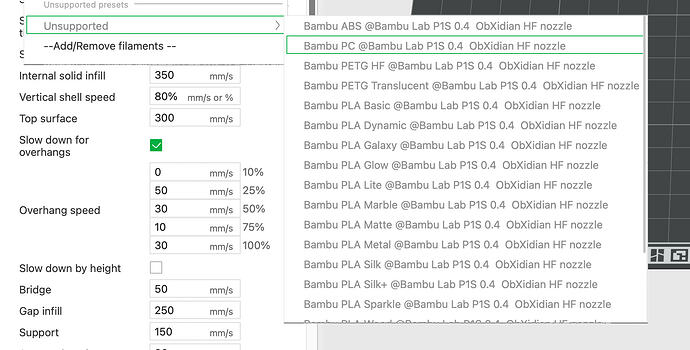

Hey, I’ve editted the question as i phrased it wrong. My issue is that with the E3D head I can’t seem to get much increase in speed with PLA and defo not 50%. I think though my PLA is not set to high speed also. I have looked at the settings you mention. Thanks.
Just wondering: Did you buy PLA HF, or do you just have PLA? You’ll need PLA HF - and preferably a high-quality one that can handle high speeds.
It’s like buying a sports car but filling it with old oil instead of good gas - you won’t reach top speed that way.
Here’s a MakerWorld file with some profiles that are tuned for ObXidian.

In my experience this simply the case. Calibrate the the filament and do a max volumetric flow rate test. I run high volumetric rates and speeds on pretty much every filament I have ever used. PLA, PLA+, PLA 2.0, PLA HS, PETG, PETG HF, etc. Even the cheap crappy non-name stuff which strings a lot still can have high volumetric rate against an HF nozzle (I have E3D Obx 0.4 in P1S and many HF nozzles for the H2). I barely find a difference between “high-speed” filament and regular filament. Of course YMMV.

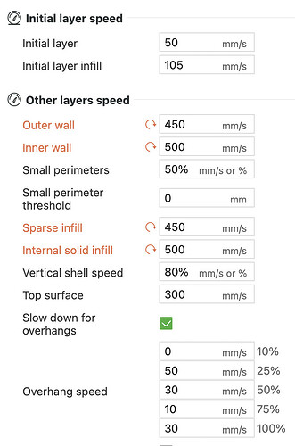

are these speeds bonkers with normal PLA? Flow rate 40? Can anyone explain the relationship between the two? I probably could get GBT to answer it but i find the answers don’t really have context and real world experience. Thanks. Morgan.
I’ll just say I’m not a speed person, so I haven’t done this myself, but if I’d suggest starting with an extrusion flow rate test, not a linear speed test.
From what I’ve heard from people at Bambu the machine’s linear motion system is more capable than the extruder’s flow rate, so I think finding that flow rate limit for your material should be the first step - then as I understand it, you can then increase those speeds for each of those line types, those become the maximum BUT only to the limit of your material extrusion rate.
If you just turn up max speeds but don’t increase extrusion rates nothing will happen.
