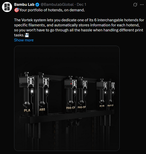

I keep hearing about it and Bambu is evening throwing it out on social media as if it’s a thing, but I can’t for the life of me see how it’s done. Guessing it’s probably not actually available, they just think it is? More than likely I’m just an idiot and missing something.

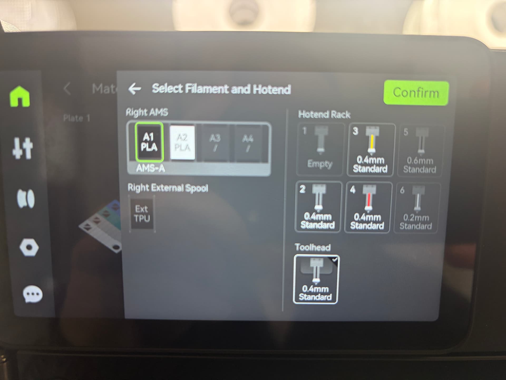

Here’s a picture for the release notes of the latest H2C firmware where you are supposedly able to manually assign filament to nozzles. This screen doesn’t appear to exist.

That screen is available when you send the job to the printer. You have to hit the hot end icon beneath the filament in mapping screen, then you can assign specific hot ends to filaments. There is also a handy illustration of the last filament color used inside specific hot ends.
Huh, you’re right that is the same window and didn’t even notice. The picture I shared above was from the printer’s screen shown in the firmware release notes so I was poking around there trying to find it. So there’s some definite oddities there. Now they just need to let us actually dedicate filament types like they are saying we can.
That screen is also available on the printer. First time you print you pick the nozzle you want for the material you want. Any subsequent prints will automatically use the same nozzle, the one last used with that filament.
Ahh so I am an idiot and missing something. Thank you :smiley:
Glad to help. Just keep in mind if you run a job with 6 colors, it will automatically want to overwrite your last used material nozzle selection to reduce the purge waste. Then you will have to select the ABS/PA etc. nozzle again like the first time. Or you can pick to have the extra purge and use only 4 nozzles for example, but by default it will want to use all available nozzles to reduce purge.
