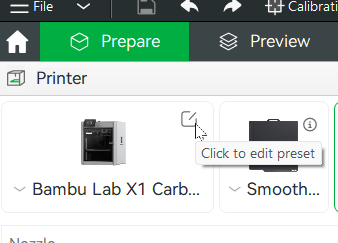

When I open Bambu Studio, and I select the little box next to the “advanced” setup switch, Bambu Studio hangs, then eventually crashes.
Is there a way to change the default startup GCode outside of Bambu studio?

Move the cursor to the upper right of the printer selection box, and a pencil icon will appear. Click that to edit the preset and the Machine G-code.
The G-code editor is very crude. I usually “Copy All”, paste into a real text editor to make changes, then copy/paste everything back into the Studio editor.

Thank you Ikraus:
That worked.
I was clicking the wrong thing, that little button does not show up until you hover the printer selection button, and even then, it is quite low contrast (at least on my machine.)
At least I can edit the codes as in the video.
