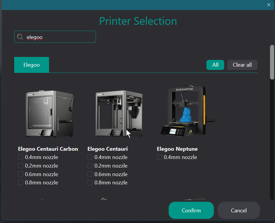

Profiles for the Elegoo Centauri Carbon are built into OrcaSlicer, no need to look elsewhere.

Note to other users: Install the nightly build for orcaslicer. As of right meow, only the nightly releases have the full ECC profile, till orca does another major release.

Guess I need a nightly build version because it wasn’t in the version I had
