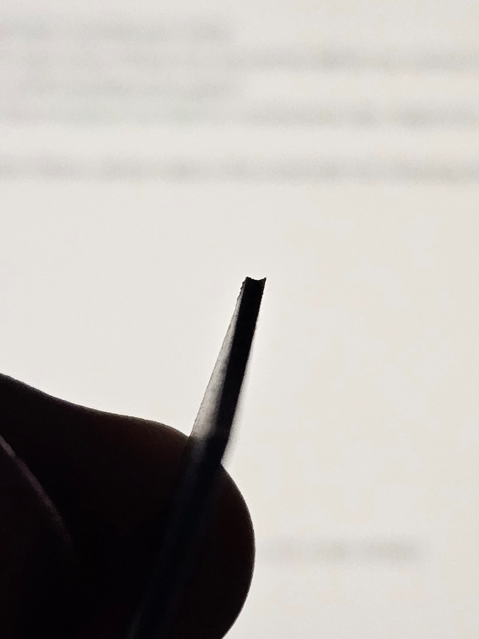

I’m getting excessive elephant foot on my A1 with PLA, even with 0.25mm compensation. Using polymaker panchroma starlight neptune with the Polylite PLA profile. The top surface looks great, so I don’t really want to mess with calibration. I’m running a test right now with 55C bed temp (down from 65C) to see if that makes a difference, but if it doesn’t, I’m not sure what else to try.

That’s the thing…the first layer is great! It just squishes too much. What plate setting should I use for the BQ Glacier plate? I’ve been using textured for a while, but something changed within the last week or so and now I’m having this problem. It’s really bad on the calibration tiles that I just printed. I tightened the heater block screws a while ago, but haven’t checked recently. I’ll try that when this test print is done.

This is what I’m trying to fix. I have a ticket in with bambu as nothing I’ve done so far has fixed it.

I did. Kind of. I fixed it by putting my aliexpress hotend back in lol. Turns out the hot zone is slightly bigger than the stock one and bent the clip out of shape just enough to cause a stock hotend to move when installed. Not sure if that’ll help, but that solved this for me.
