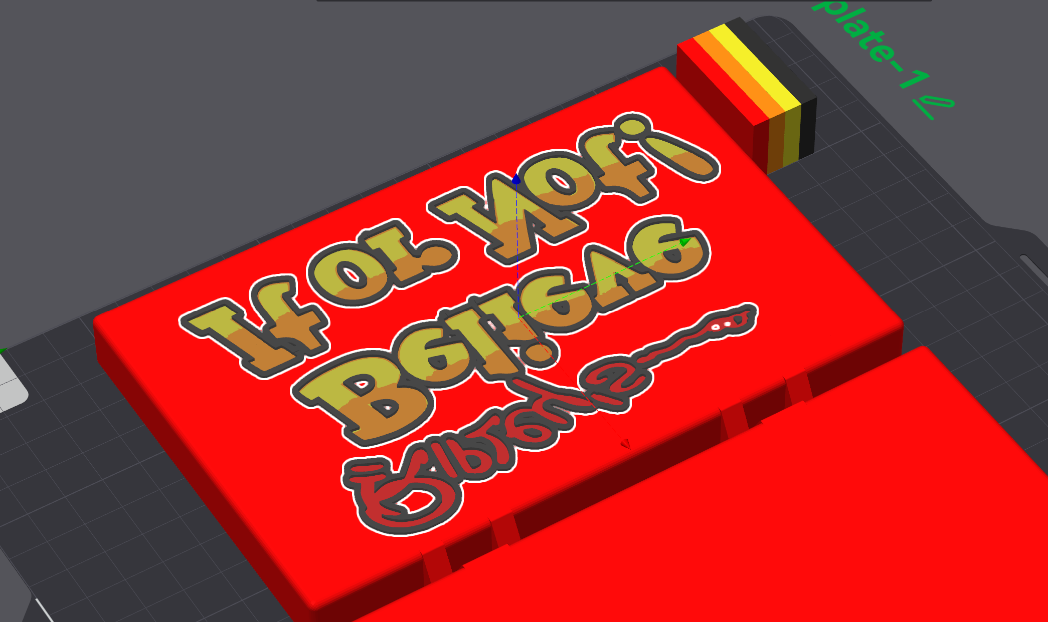

I have a plain box in .3mf format to which I would like to add a multicoloured logo, which I already have as a .3mf. I have managed this previously with a single coloured .svg by adding a modifier & making it flush with the surface.
Unfortunately, when I try to add the .3mf, it is imported as a single object & the colour information is lost. I have also tried using Add Part & Add Negative Part.
Is what I’m trying to do even possible, and if so, how?

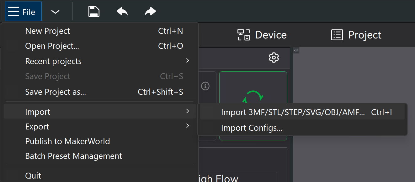

Did you import the 3mf or just load it as a part ? from a folder ?

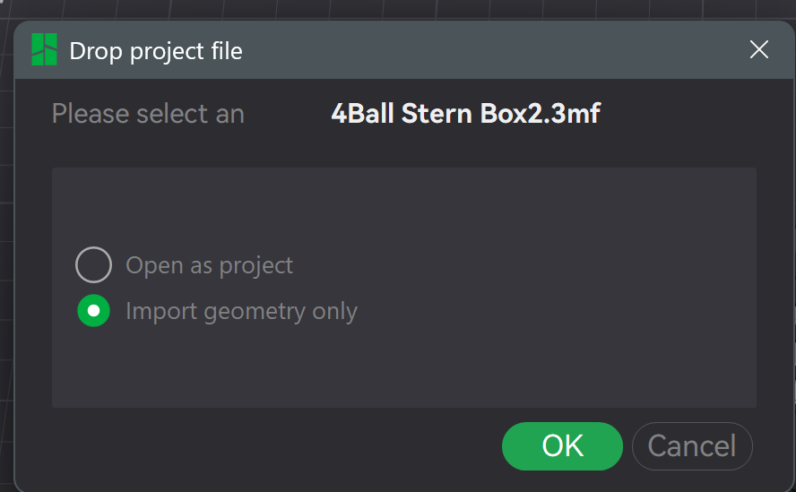

I think you want to Open the logo.3mf to use those settings and colors, and then Import the box.3mf as geometry only.
Try starting from the painted object’s project [your logo project] and add the box to that project. If the box is a plain unpainted object, you can open the 3mf that contains it, select the object, right click and export as STL - then import that basic stl into the logo project so as to not import any other metadata
Import offers geometry only option ,yes , if you try to add a part from a folder it automatically changes to a default colour , random cube is brown, the added part (is black) will also be loaded as brown and then you can add or remove colours , which ever is better, easier for the model (both bambu 3mfs) not sure how it would work with one svg file , where colour can be added on import

Import the logo (which preserves the colouring I want), then import the box, but then bits of the box & logo are trying to occupy the same space, so that doesn’t work.

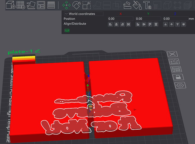

I want to add the Ripley text to one of the flat sides (I have to rotate it so the flat side’s down, maybe I should re-save) with the colour information preserved.
Open TExt.3mf

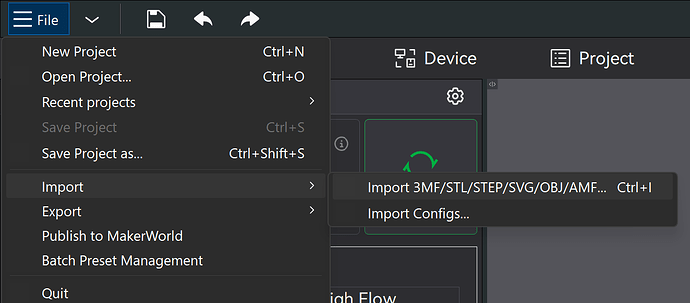

Import 4Ball Stern Box2.3mf
Only geometry
Select all
Merge:
Just move the logo to the correct position: Select everything except the box:
Click on the move tool
Done:
Next up is step two… how to embedding it…

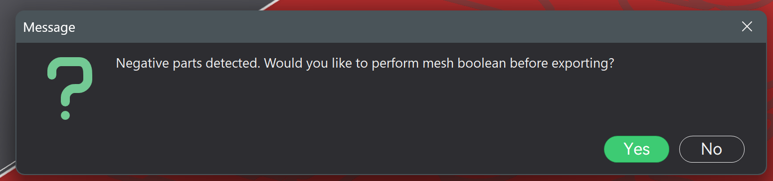

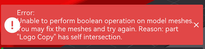

So, I’d already been busy taking all kinds of pictures - instructions, step-by-step - until I realized: The logo can’t be embedded because it causes an error message; apparently, it’s too complex or faulty for Bambu Studio.

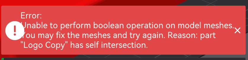

I wanted to use this feature:
However, this error message is returned:
Bambu thinks the mesh is faulty, but that could also be due to its complexity or other reasons.
What does that mean? You’ll need software other than Bambu Studio. Either CAD, Meshmixer, Blender, or whatever else is out there. One that can perform a mesh boolean operation - which, actually, almost all of them can. Only Bambu Studio isn’t really designed for that.

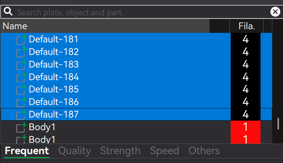

One other note, if you plan to boolean or union ,it will lose its colours and will need to be reapplied using the paint tool , edge detection , which can be obstinate depending on geometry.

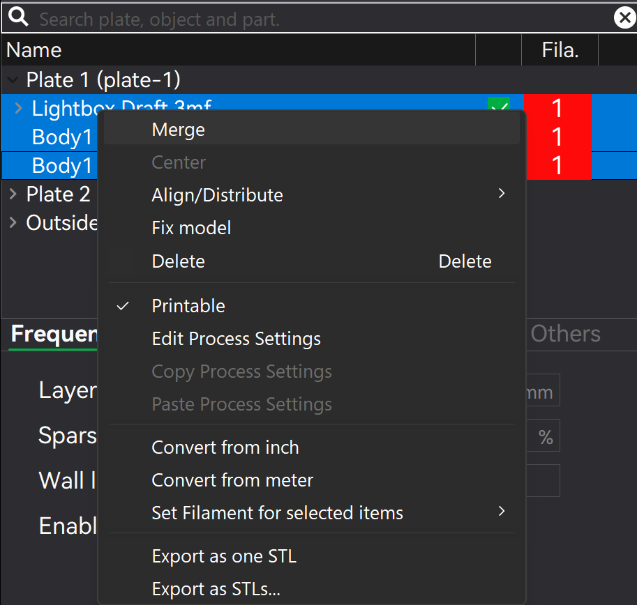

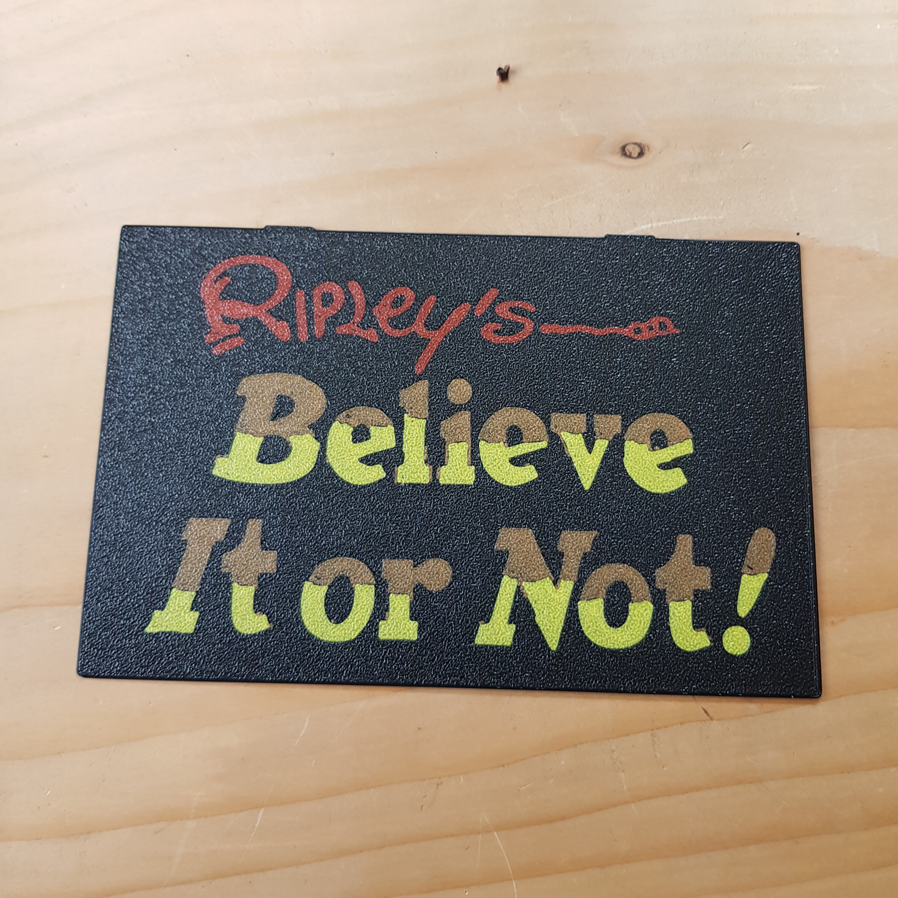

Progress update - I have manipulated the logo in Fusion & printed the thin version. I have a new file with both box & logo, but slicing gives gcode conflicts. I started a print anyway, but could hear the head hitting the already printed filament, so stopped it. Also gave dull colours due to the black being just behind. I can’t find the boolean mesh function mentioned by Neiljt, which I think is what I need.
RBIONBox.3mf (532.5 KB)

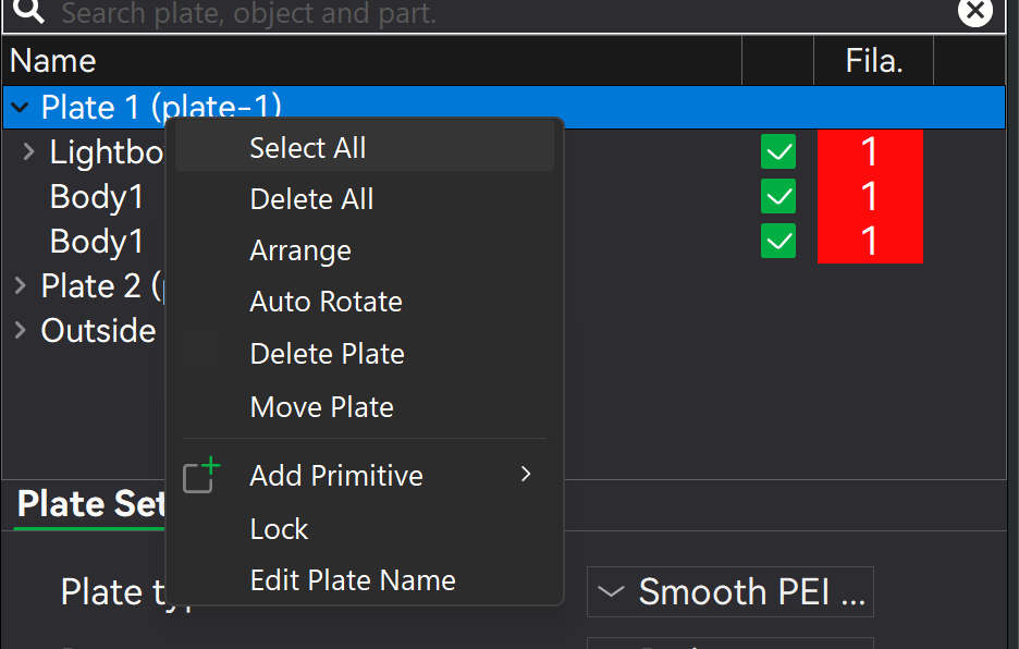

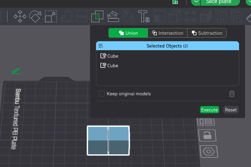

Use object mode plate # select all and use the union feature
Thanks, but that icon is greyed out for me, though I do have the Assemble. Do I need to do anything special? Maybe because the logo is a load of separate objects?
Ive used two seperate objects, then selected both
I’m curious to see if it works now; when I tried that with your project, it refused to operate boolean.
