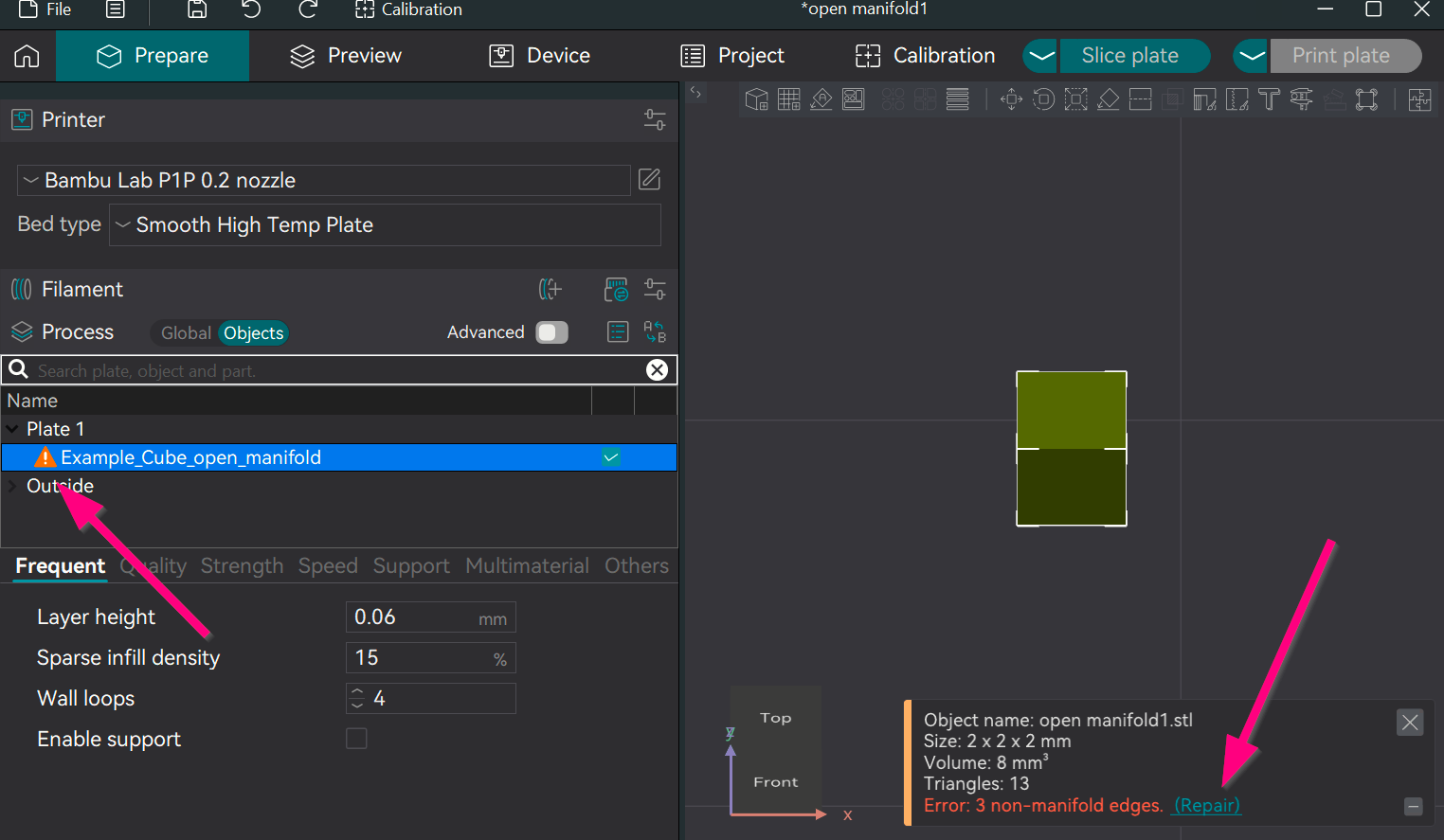

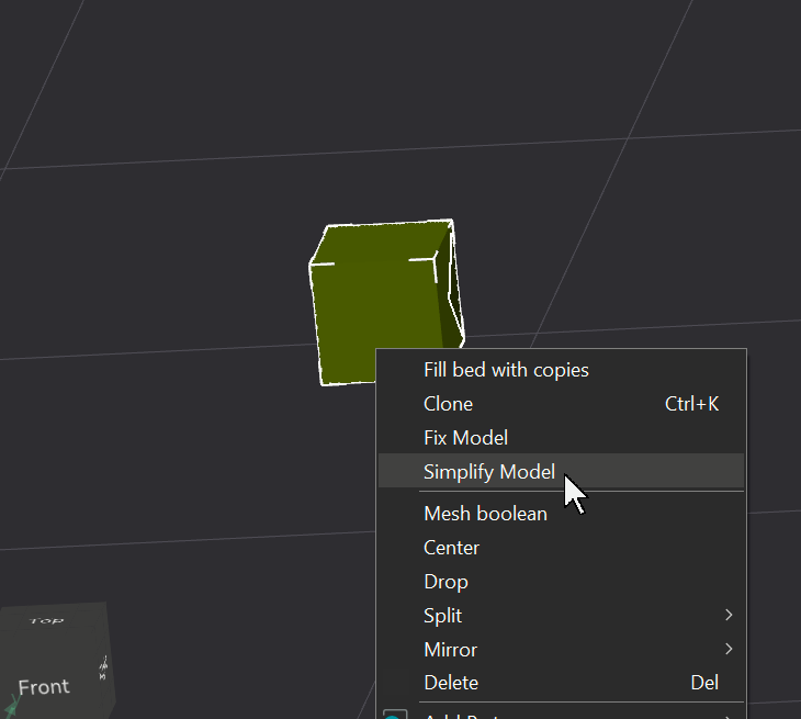

Barring that, we’re guessing. Here are two likely causes of empty layers:

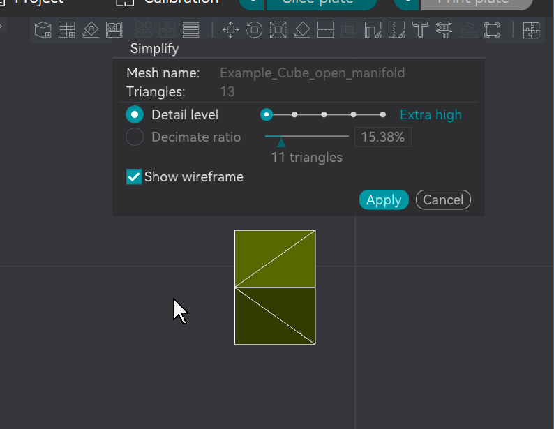

1. Open Manifold / Mesh Errors
Mesh-based formats (STL/OBJ) can have holes or geometry issues. When this happens, the slicer tries to “heal” it. If it guesses wrong, you could get empty layers.
Possible fixes:
  • Repair the model via right-click menu.
  • Right-click - Simplify Model (this is trial and error, you’ll have to play around with the settings, no magic bullet)
2. Defective or Misaligned Geometry
If the empty layer is:
  • Inside the model: The model may be defective from CAD export. There is no other way but to try another file format such as STEP or go back in and fix your CAD model.

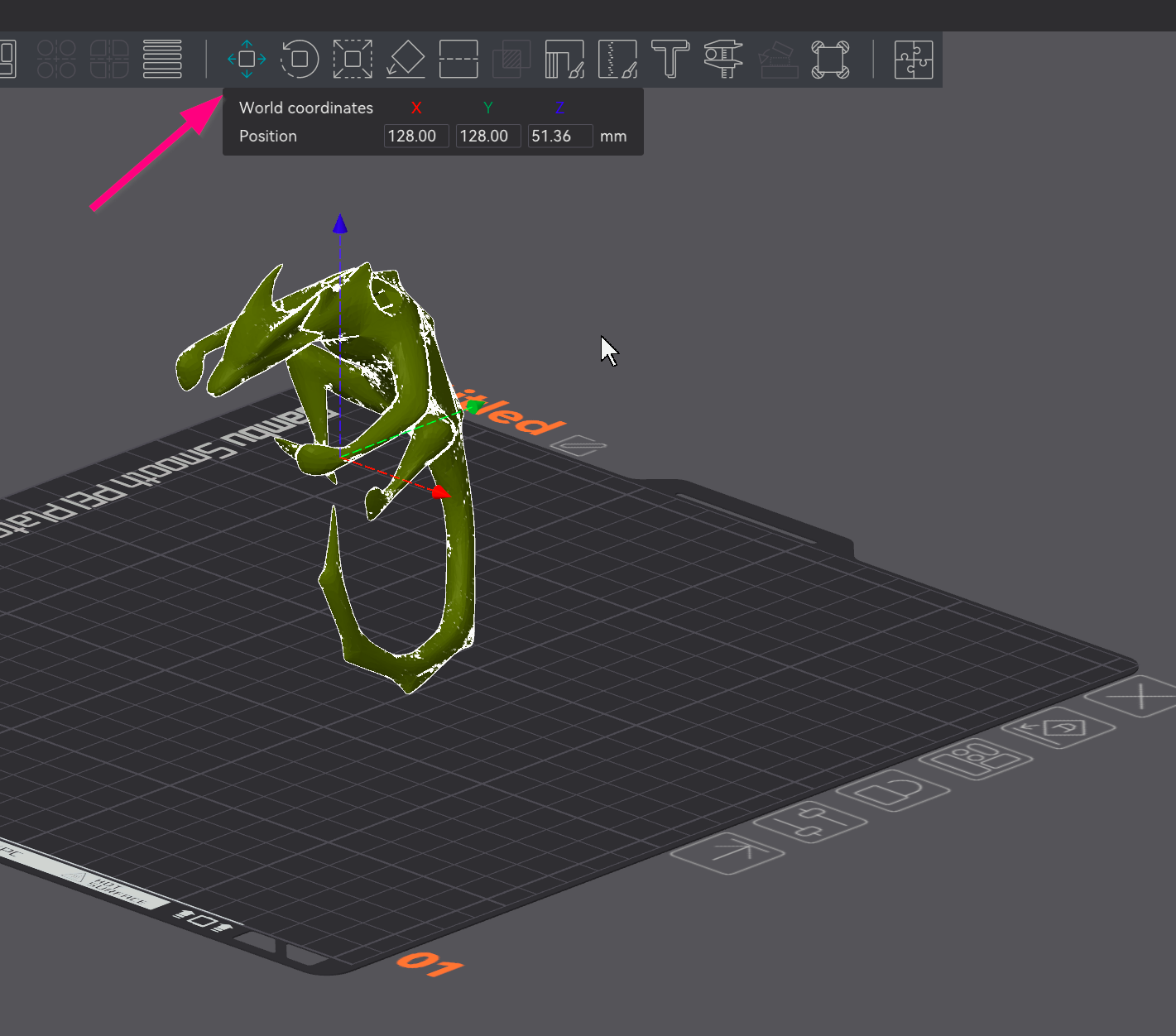

  • At the base: Try lowering the model slightly to seat below the build plate using the Move tool. Even a subpixel gap can trigger errors.

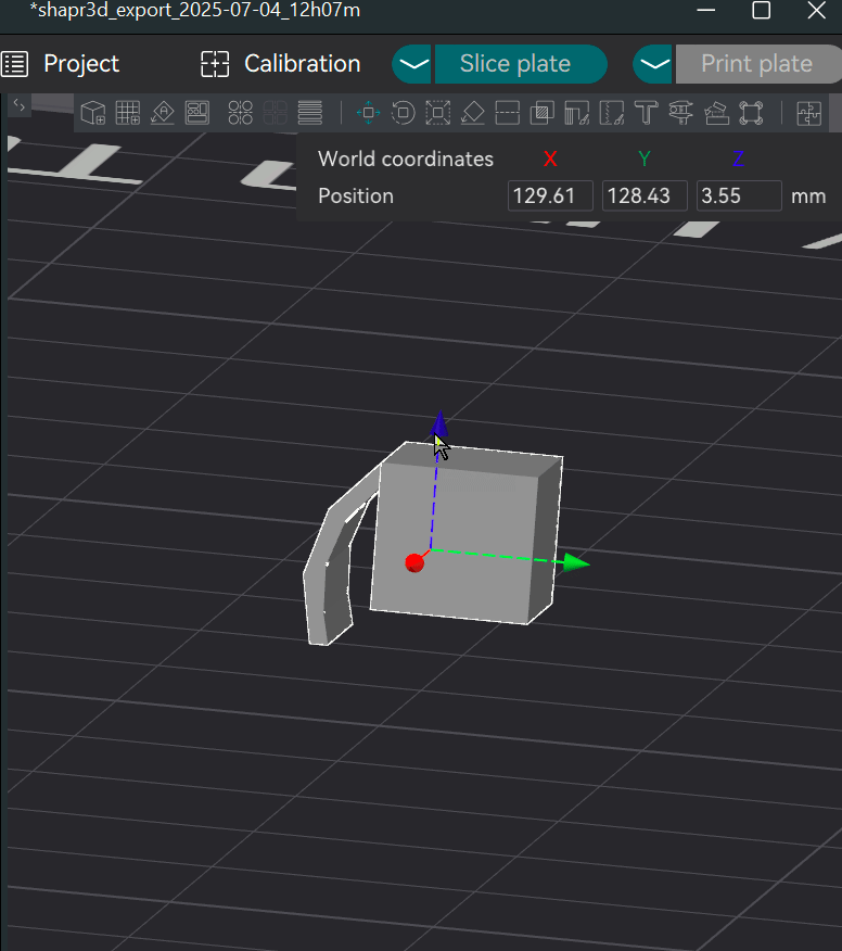

It’ll be more clear when I upload the model, but what I have is a print in place part, one PETG, one part PLA. The PLA part has a PETG base made for it as a print support, the PETG part has a PLA support made for it. I do this often and it’s a really nice way to get perfect overhangs.
This particular model, one piece is effectively floating because the slicer doesn’t see the support models as having collision. It’s not floating, it rests perfectly on its support.
There’s no issues with the models, each part will print fine standalone if resting on the bed. The part can’t be assembled after printing though so needs to be print in place.
I made a tiny thread that holds the floating part to the exact correct height on the bed, small enough that it won’t print, and that’s where my issue lies. Everything is perfect and ready to print but the slicer won’t allow me to send to print because it doesn’t recognize the objects will interact on the print bed.
I think my question might be answered that there’s no setting to allow me to turn off the warning, so instead maybe I need to find a way into spoofing the slicer into thinking the lower surface is just a really bad overhang.

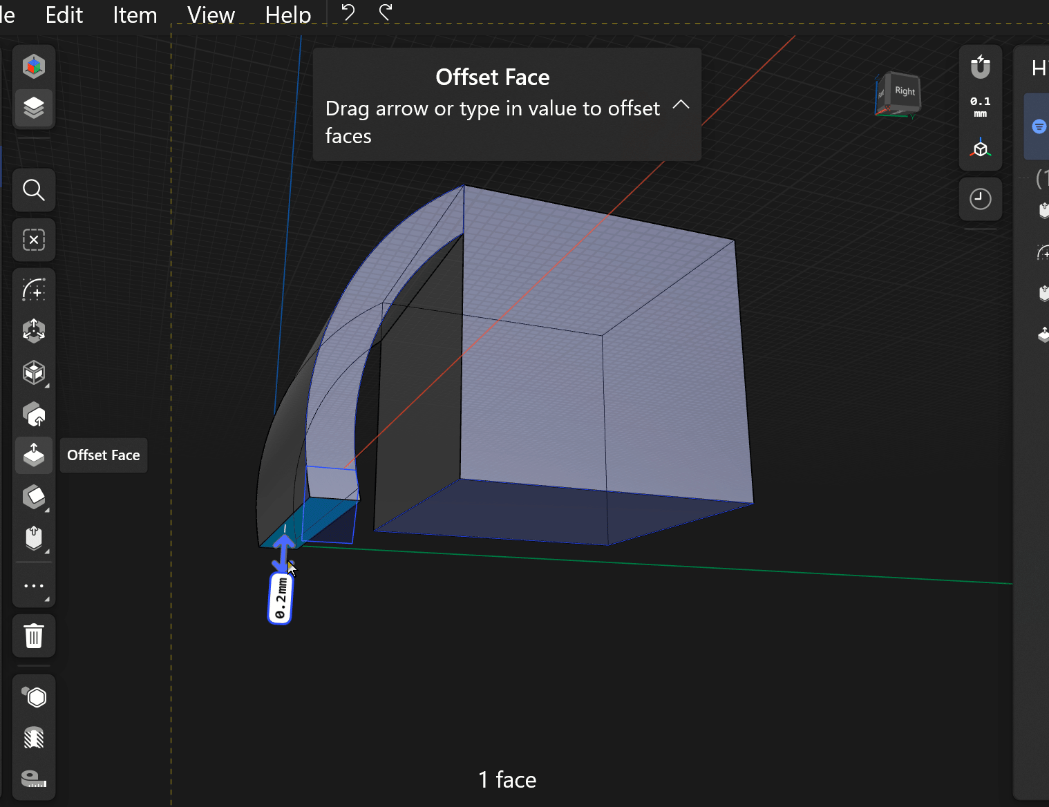

Based on your first post, I suspected as much. It’s counterintuitive, but 3MF isn’t ideal for transferring models between programs when you’re the one controlling the model. That sounds odd - it’s a “standard,” after all - but the issue is that the standard is too open to interpretation. For example, Bambu Lab encodes colors and assemblies in 3MF differently than many other programs. So when is 3MF beneficial? It works well when saving, transferring, or uploading to MakerWorld - especially if you want Bambu-specific features preserved.
You’re on the right track, but spoofing isn’t necessary. Try selecting the bottom face of your model and extruding it downward. After exporting to STEP or STL and importing into the slicer, you’ll likely see a “zero layers” warning. Just lower the model a long the Z-axis until the original base is flush with the build plate - you’ll know it’s aligned when the build plate highlights around the model. The extruded section will sit below the plate and be clipped at slice time. The key is to close any gaps at the base; the extra geometry is discardable.
