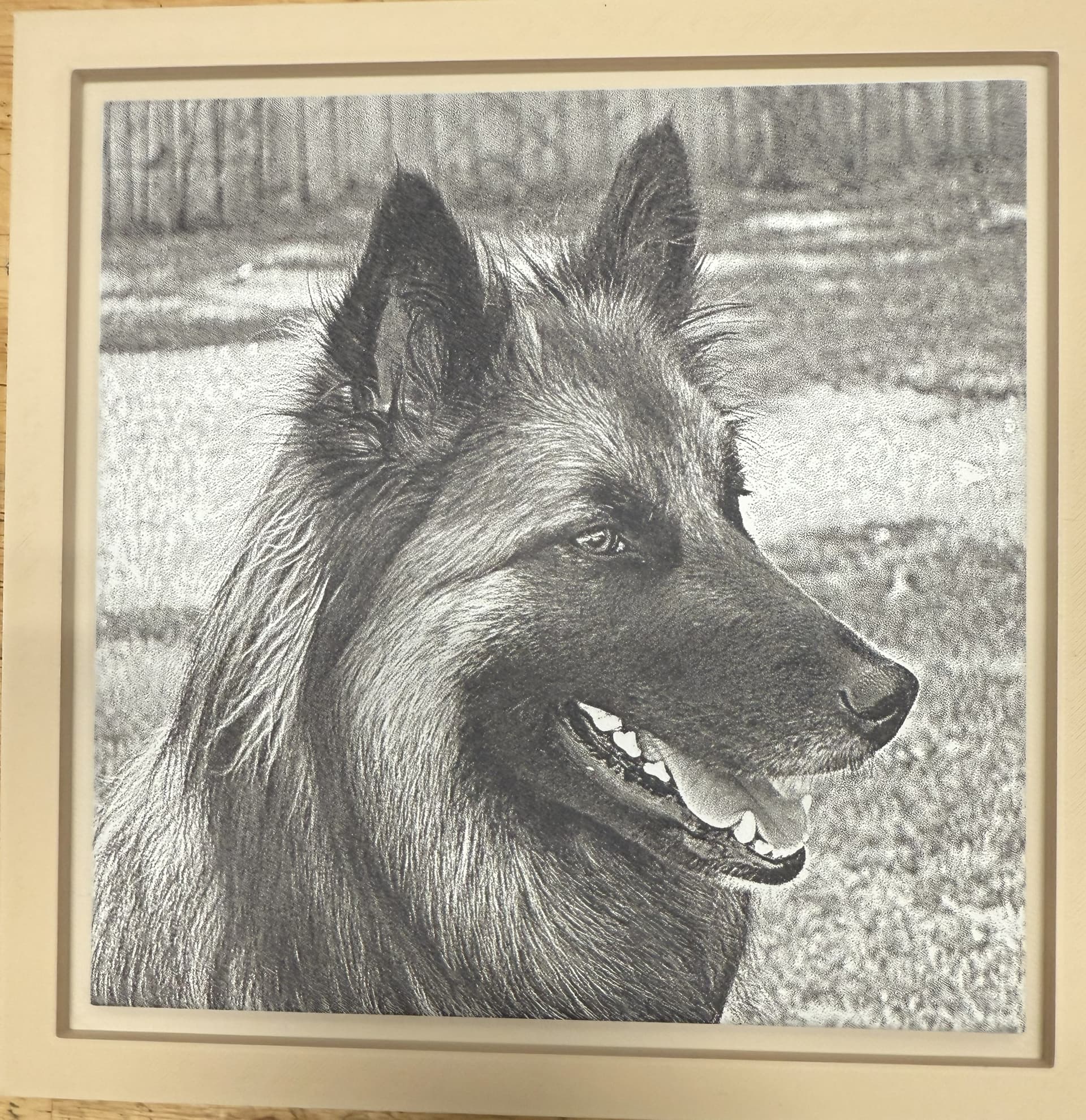

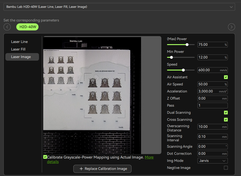

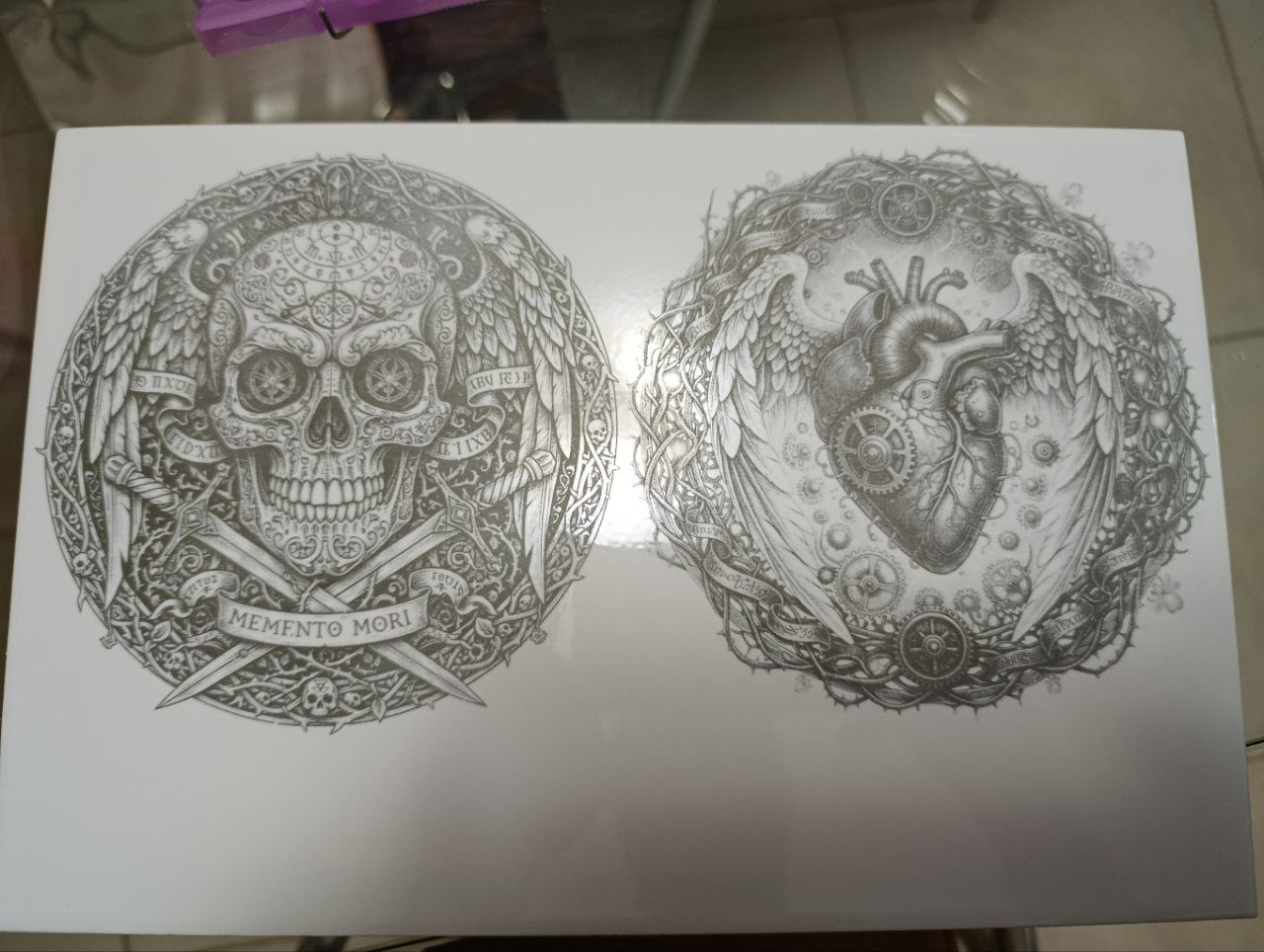

Hi, I’m using 40w laser, 75% power 600mm/s, I did it also with less power and half the speed, first spray the white tile with black laser marking spray from omtech, let it dry, change the image mode to jarvis, after you engrave it rub it with water and sponge multiple times. Results:
also settings:
