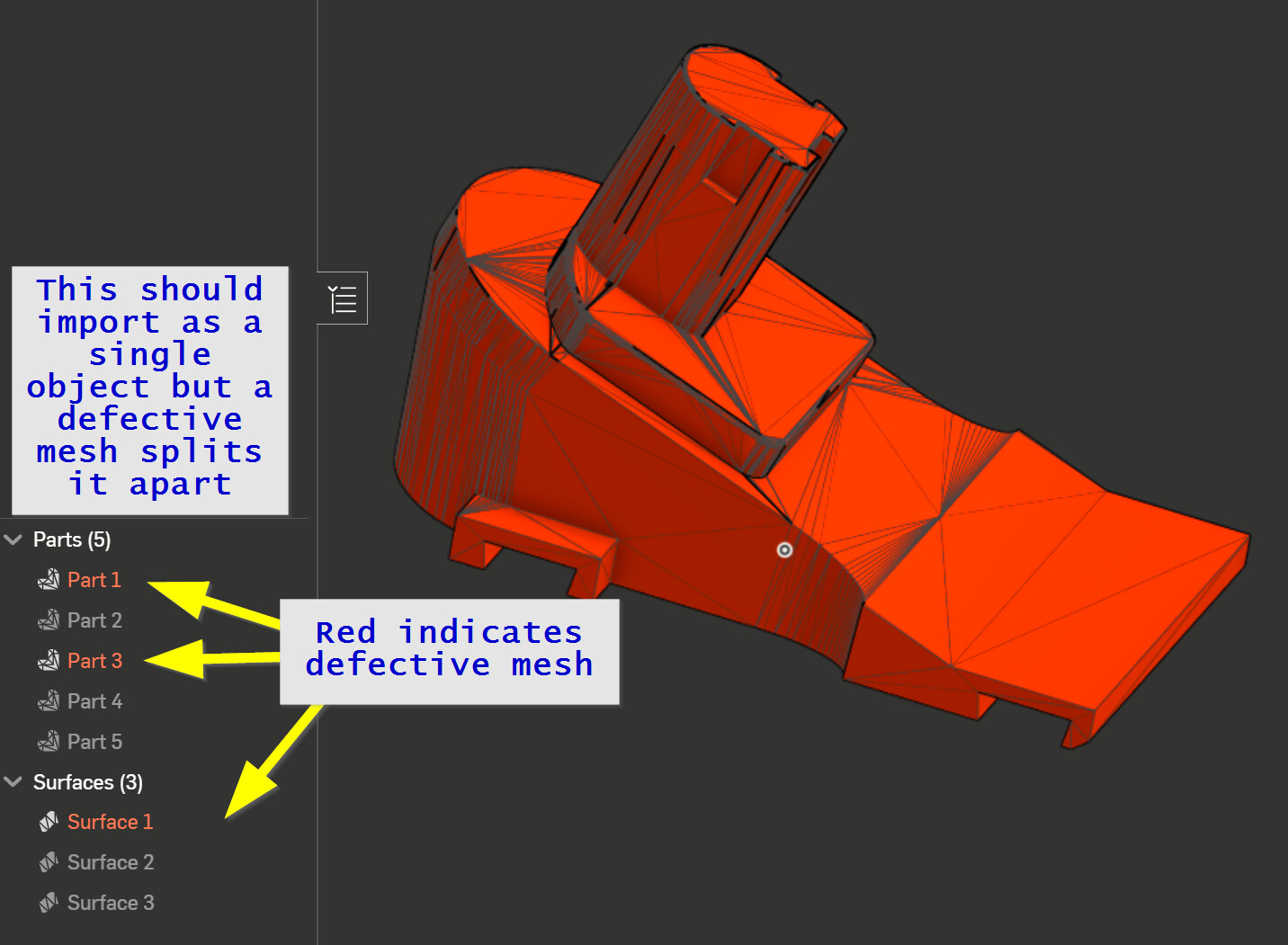

TinkerCAD exports solid bodies as hollow shells, which doesn’t match how most CAD systems handle geometry. This is one of the most frustrating incompatibilities in 3D mesh workflows. I repeatedly ran into the same issues when modifying other peoples STLs and it took a lot of trial and error to figure out what was happening and how to work around it. I will freely admit that it was maddening and nearly drove me away from 3D printing for a while.
The same problem can also show up if you import an STL into one program (e.g., Bambu Studio) and re-export it. Once you cut the model, you expose a face and create an open manifold, even if you try to repair it. The slicer then guesses how to close the gaps, which may allow it to print but prevents you from having a portable, properly closed STL. (BTW: One solution is to export to STEP whenever possible)
Here’s an example of how another CAD program interprets the same file. It doesn’t know what to do with the broken faces so it splits it into three sub-models and one defective surface. These are mathematical defects, not something you’d normally see in a rendered view. That’s why diagnosing them is so tricky without understanding the underlying math - which, frankly, I only grasp at a surface level myself.
