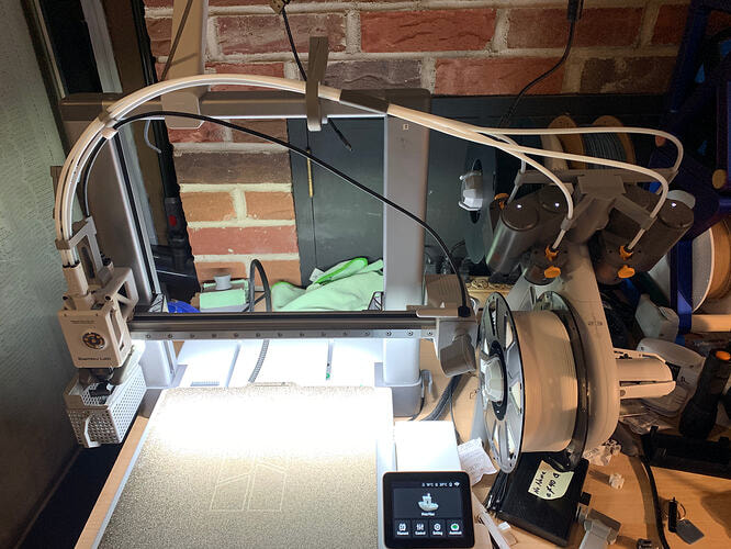

Picture is of my set up. On top of the print head, i placed a bracket to help reinforce the tubes and keep them from bending to much, Next I clipped the power so it doesn’t slip behind the cross brace when printing really tall objects, but not to far to the right so it can’t stretch all the way to the left when needed. Next i have a placed a movable (vertical and horizontal) PTFE tube (only) support bracket on the top rail, next I put tube guides on the AMS so as not to let the tubes bend to the left to much. and cause stress on the the tubes where they enter the AMS. All of there modifications were my solutions to problems that happened during the first few months after getting my printer.
