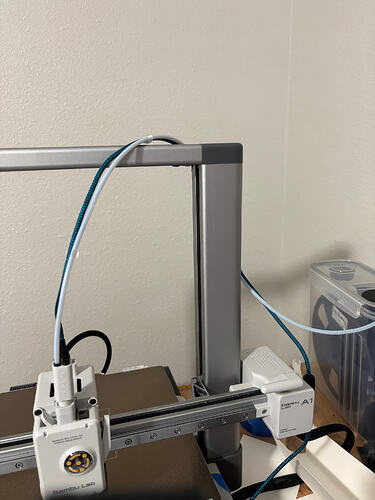

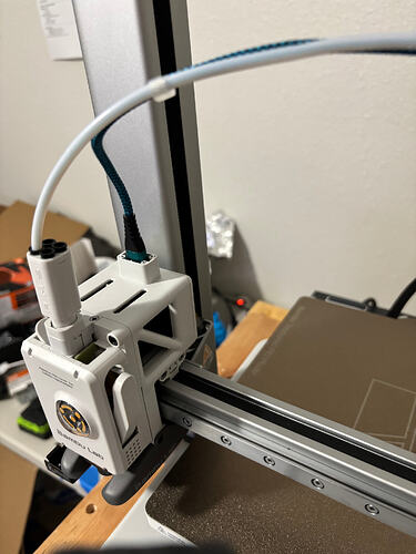

Ok, so here’s the event that lead to this post. Started up a print and turned around to do some modeling. I normally check the first layer, and follow the printer by sound until I can hear it putting down that first layer. 10 minutes go by and I realize somethings not right. I turn around and see the USB-C and the PTFE are hooked on the back side of the gantry and the toolhead hard to the left pulling hard on the USB-C and the PTFE in an effort to get to the poop shooter. (Photos below replicate event because I didn’t think that I was going to need pictures for this).
I jumped up and hit the power switch.
Once powered down, I backed the toolhead off and released the USB-C and the PTFE.

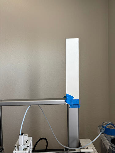

Knowing this would happen again, I taped a carboard “bar” around the right hand gantry tower, making it long enough to prevent the USB-C and the PTFE from passing over it.

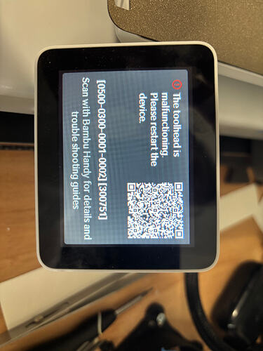

The toolhead gave one “click” and threw the code: HMS_0500-0300-0001-0002 (this will be hence forth referred to as “Brick”)
Checking the bot on Bambu Handy and I get: “The toolhead is malfunctioning. Please restart the device.”

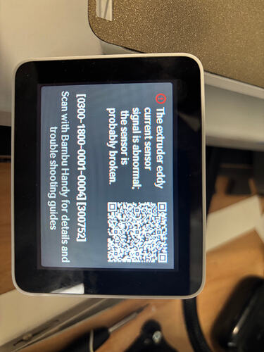

Extruder eddy current sensor is abnormal; the sensor is probably broken[0300-1800-0001-0004][250242].
Just for fun, and because I was thinking maybe it’s the new cable, i plugged in the old cable. The old cable got to the “Home toolhead” screen and stopped. didn’t even throw errors. So it’s defiantly done for. Now it’s just an issue of figuring out what else is wrong. On a side note, I did a complete clean out of the nozzle and extruder assembly just to ensure that was not part of the issue.
Also, the unit told me, “Unable to home the tool head” before spitting out those codes.

My two biggest concerns are the USB-C plug on the toolhead, and the z-axis sensor. both are major components for the toolhead. Everything on the tool head is an easy replacement, it just bothers me that something that is so obvious as the cable/tubes getting hooked on the gantry hasn’t been spotted or talked about within the community before. It’s that stupid Irish luck of mine. If I didn’t have bad luck, I would have none at all.
I built a temporary fix for it (see attached image), and I’ll model and print an upgrade part. Maybe Maker world will give me some point for it. :smile: .

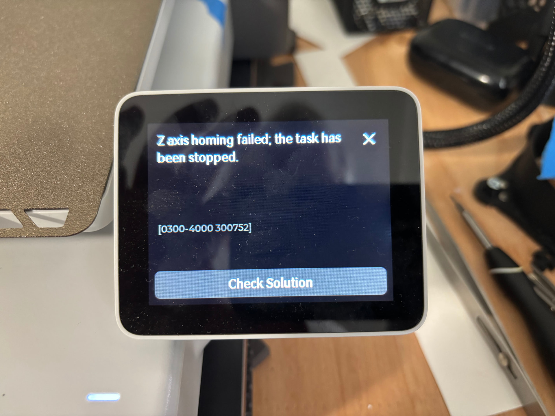

Alright, the cable arrived, and has been installed. Unfortunately it did not resolve the issue. I’m getting the following codes:
[0300-4000-300752] Z-axis homing failed; The task has been stopped.
[0500-0300-0001-0002][300751] The toolhead is malfunctioning.
[0300-1800-0001-0004][300752] The extruder eddy current sensor signal is abnormal; the sensor is probably broken.
I checked the sensor leads to make sure they where secure and they where.
I’ve ordered a multimeter off amazon. It will be here tomorrow to test the continuity of the sensor.
